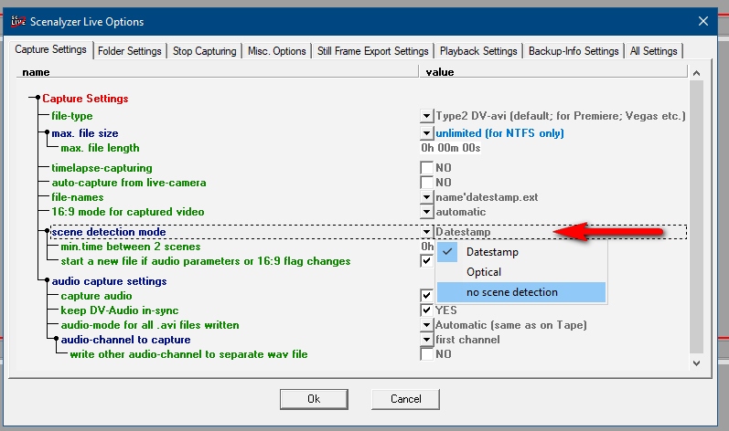

    In my portable version, I see : File -> Options -> Capture Settings -> Scene Detection mode -> Start a new file if audio parameters or 16:9 flag changes.

    May 2005
    Australia-PAL Land
    Two lines above: click the dropdown next to "datestamp"
    [Attachment 63440 - Click to enlarge]

    Aha, shame on me!
    Yes, it lookes now, I got one file.

    I still got more files, now 1x 7m18s and 5x 9m22s
    That could be the 2gb limit. DV is 220mb/minute.
    Make sure the Max File Size is set to "Unlimited (for NTFS only)" (on the Capture Settings tab).

    After I had done a complete capture, I saw that Scenalyzer puts the timestamp in the filename.
    I am capturing tapes of my son visiting his study friend in the USA in 2002.
    At the first tape are more days recorded.
    So I modify the scene detection mode back in Datestamp.
    Because of this name, Datestamp, I had had expected scenes per day, but now I have scenes per timestamp.

    I can't modify the other option (parameter) min. time between 2 scenes.
    This is 1 sec.
    It would be nice when this option was also changeble.
    It is, it just doesn't look like it because the numbers appear to be "greyed out". Click on the hours or minutes and they'll go from grey to black, then you can type in your desired time.
