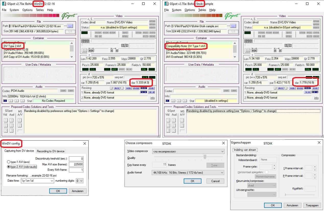

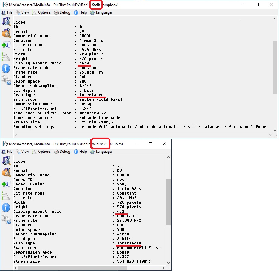

    I have tested the programs WinDV and Stoik.
    In the attachments the results of G-spot and MediaInfo.
    I hope the pictures are good visible.
    WinDV shows 4:3 and Stoik 16:9.
    Playing the files in VLV, I see the same video formats.
    I think, it has to do with the PAR : 16:15 (WinDV) vs 10:7 (Stoik)
    But why this difference and what is best.
Name:	Gspot - WinDV vs Stoik.jpg
Name:	MediaInfo - WinDV vs Stoik.jpg

    Forgotten, in WinDV I could choose AVI Type 2 , in Stoik the options are greyed out.

    Again playing my samples with VLC, I have no sound with the sample AVI Type 2.
    So I captured a new sample with WinDV and AVI Type 1, and yes now I have also audio in my sample.
    Also tested some other capture programs.
    Exsate DV Capture Live -> same AR results as WinDV (5:4, 16:15, 4:3), but complex map structure
    Debut Video Capture -> to complex for me
    AmarecTV -> Errors
    So, for me now 2 options : WinDV and Stoik.
    Please your remarks / comments.

    Unlike analog tapes, the information on a DV tape is already digital so you are simply transferring those bits to the computer, and therefore there is no degradation. Scenalyzer is really good because it has so many capture options, and because it is, in my experience, bulletproof. You will need a 1394 connection in your computer, and ideally you want to have Windows XP, although I think Windows 7 still had drivers for 1394.
    All of your 4:3 / 16:9 issues are trivial to sort out if you use Scenalyzer (the default is to automatically detect and do the right thing, which it always does correctly).

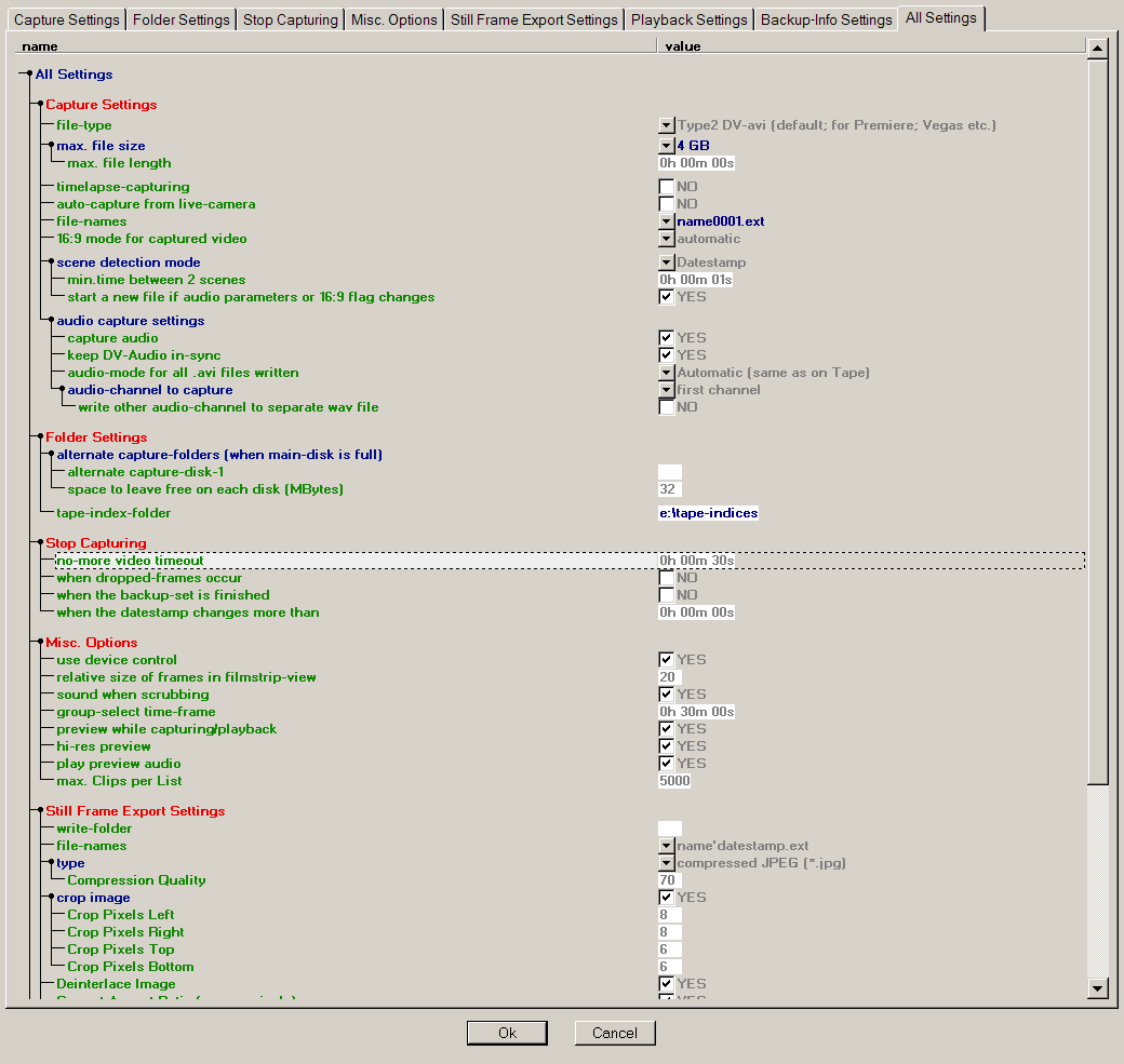

  24. This screenshot shows most of the options in Scenalyzer:
    [Attachment 63426 - Click to enlarge]
    Under the first "Capture Settings" heading you'll see "16:9 mode for captured video" and you will also see that I have it set for "Automatic." As I said in my previous post, I've not had it fail to do the correct thing.

    Yes, I had read some articles about the IEEE1394 driver in W10.
    https://vhsconverters.com/install-firewire-card-windows-10/
    I do the capturing at a PC with Asus P5QD motherboard.
    This board has a Firewire port, but with enabled in the bios, my capture software did not recognize this port, why, I don't know.
    So I had to install my capture card, recognized by the software.
    The article is also describes to kinds of Firewire cable, 4 and 6 pins.
    My cable is 4 pins at camcorder site and 6 pins at PC site, looking at the pictures in the article.
    Has this kind of cable something to do with AVI type 1 and 2?
    Or just the capture card I use now.
    And yes, I have also tested yesterday Scenalyzer.
    But I can't remember, my short memory is not well anymore, why.
    I will test it again.

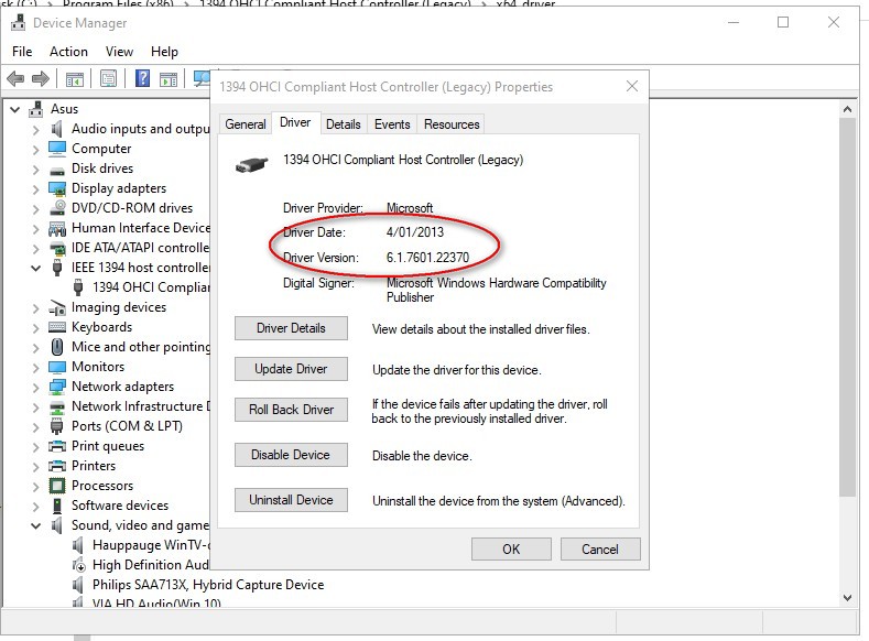

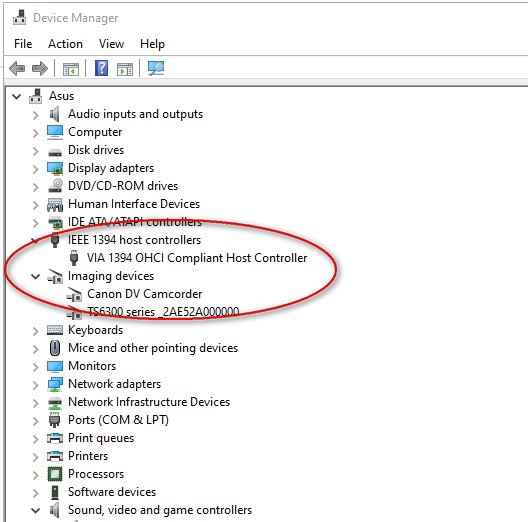

    Do you mean a Firewire capture card recognised by Scenalyzer?
    Check the motherboard Firewire shows in the Device Manager, dated 2013 (if say 2006, update the firewire driver as per the website you linked to above, or as per my link at Startech above):
    No, the 6 pin CABLE is designed to carry power. The 4 pin cable is for video camera and other device connections which don't need/want power.
    The AVI Type is set in the Scenalyzer capture settings (File>Options).
    As per that website, it is normal to have a 6 pin socket on your computer (as per your motherboard and normally on firewire cards that are installed afterward) and a 4 pin socket on your video camera. So normally you'll need a 6 pin to 4 pin cable.
