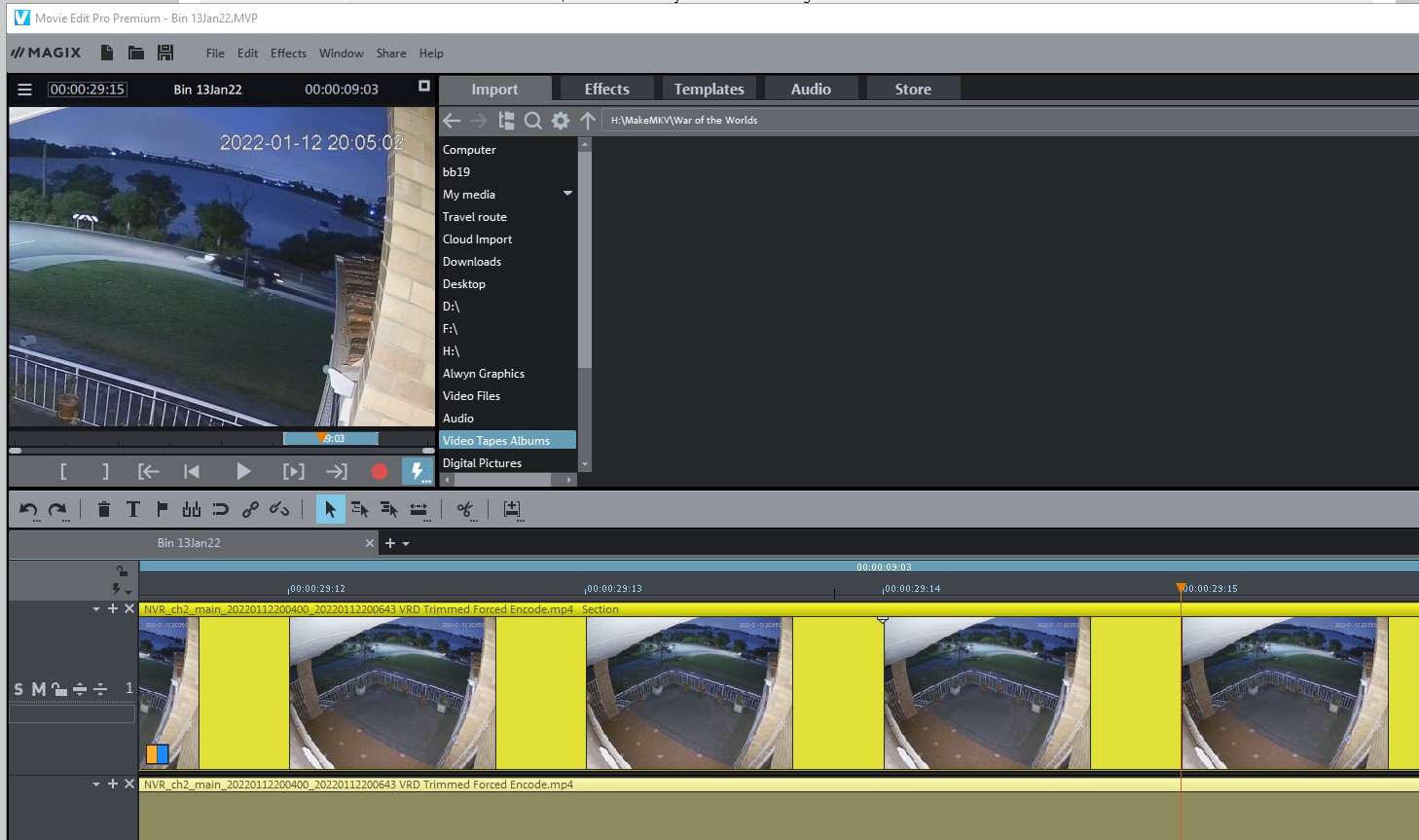

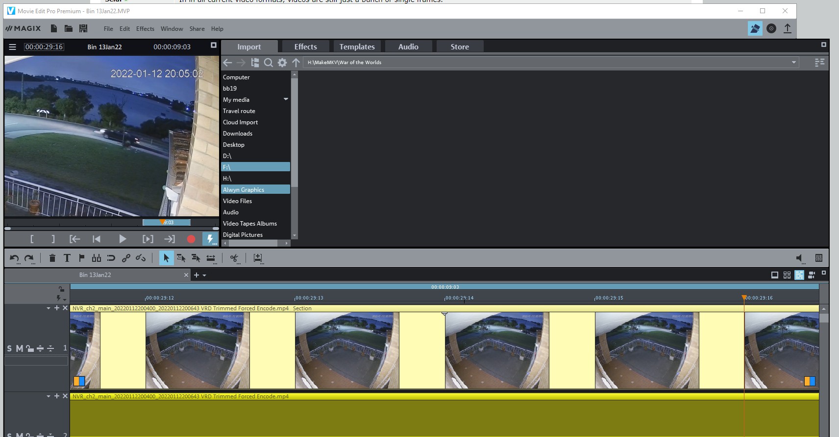

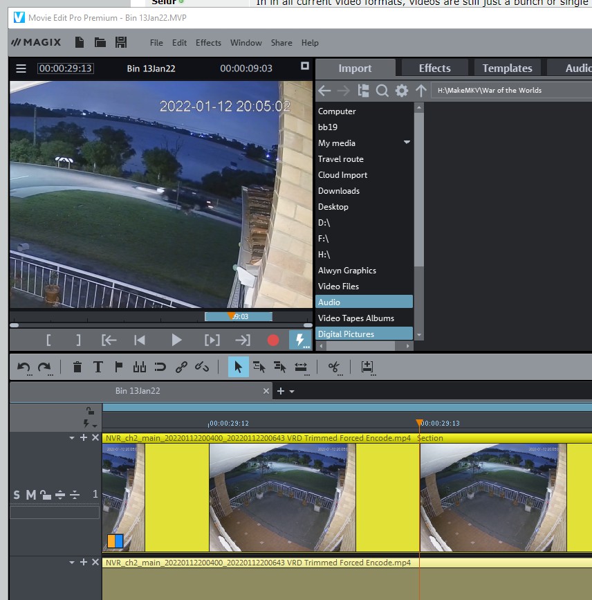

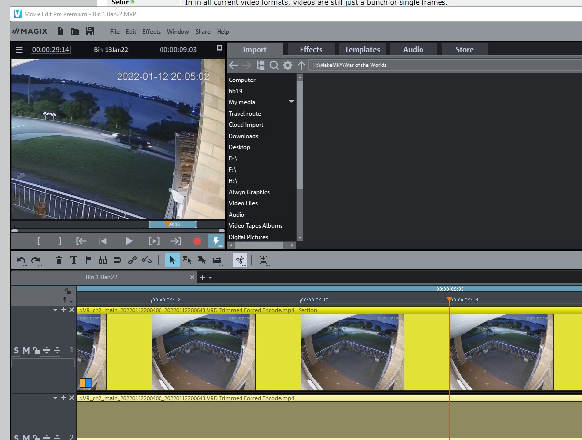

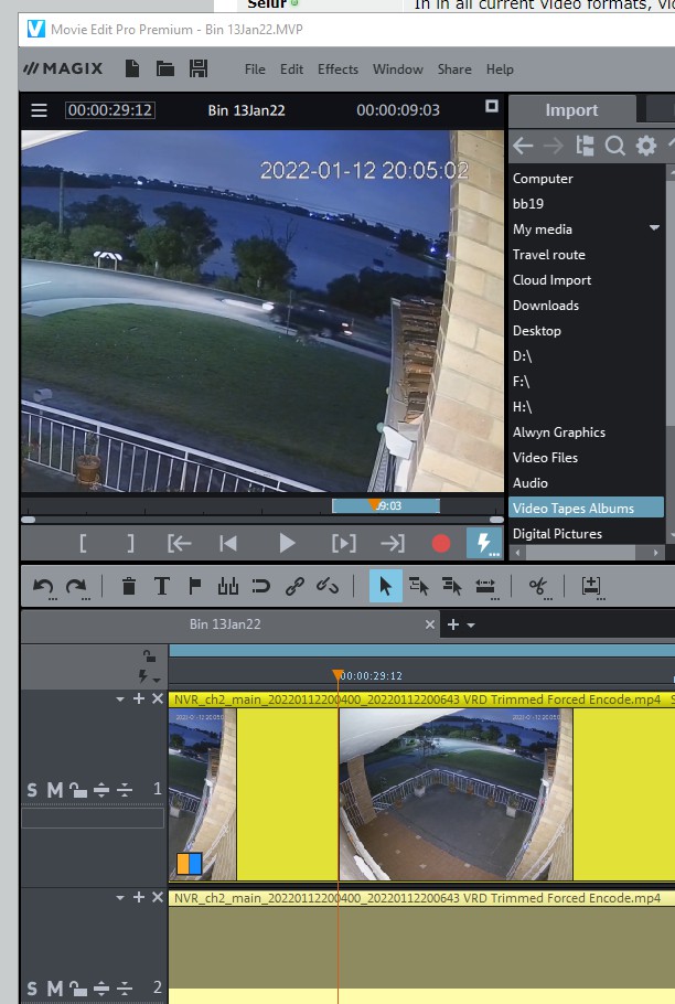

Video is indeed a collection of still frames but they are joined in the video file. When you shoot 25 frames per second, you are, in effect, getting 25 still shots per second all joined up, or stitched, together. Bu they are individual frames.
I'm not familiar with your video editors, but you could try zooming right in so that you can see each frame. Unless there is very quick motion, they may appear to be the same, but they are actually different.
Here's an example Note the car position in each frame (the frame shown is marked by the orange marker):
Timeline:
[Attachment 63300 - Click to enlarge]
Frame 1:
[Attachment 63301 - Click to enlarge]
Frame 2:
[Attachment 63302 - Click to enlarge]
Frame 3:
[Attachment 63303 - Click to enlarge]
Frame 4:
[Attachment 63304 - Click to enlarge]
Frame 5:
[Attachment 63305 - Click to enlarge]
Here I've made a cut at each frame:
[Attachment 63306 - Click to enlarge] -

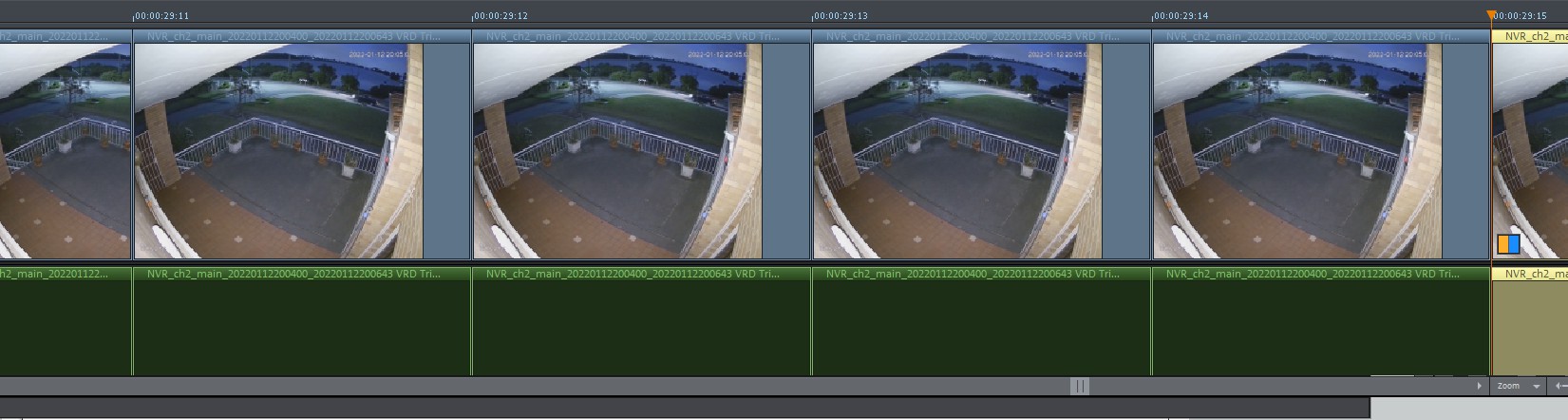

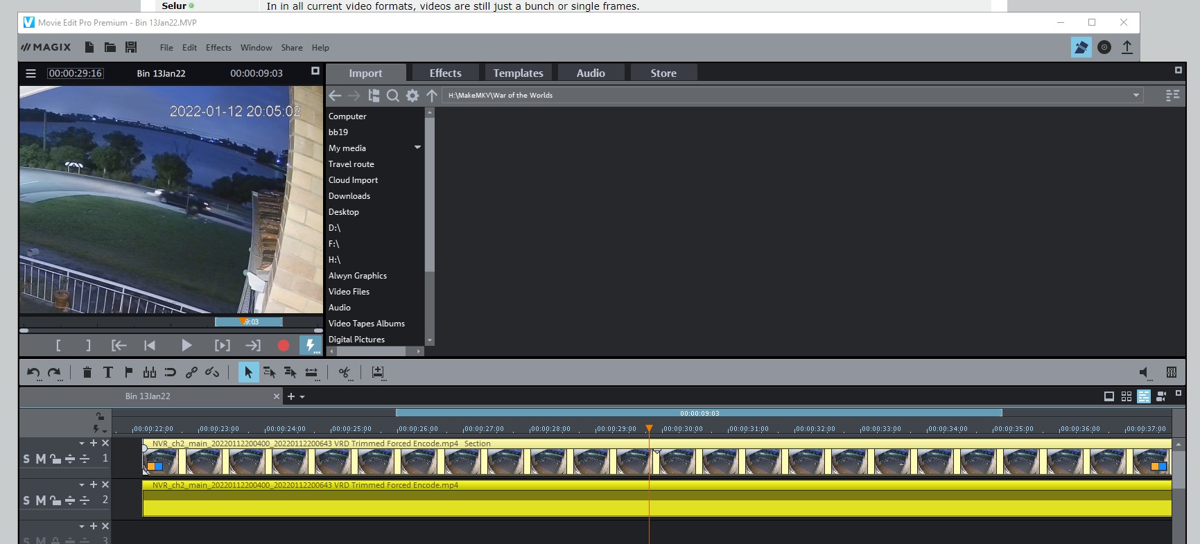

Yes, yes. thanks a lot. What you're showing is what I was looking for to show the boy (and me). A timeline of clear frames. I couldn't find it. What prog have you got there?
But Virtual Dub has come to the rescue anyway. We're motoring on...
Yep. Magix. That's what I've remembered, that display, can't find it anywhere else. Not in the freebies anyway. I'm still cranky about how they moved to a later version and invalidated my 'purchase'. Can't remember the details at all but it was something like that. Suddenly I couldn't even remain with my 'old' functioning copy.
So it was a good prog, for sure. But I'm a more than a bit curmudgeonly and I won't have a bar of them. Pity. Cutting off my nose to spite my face I suppose.
