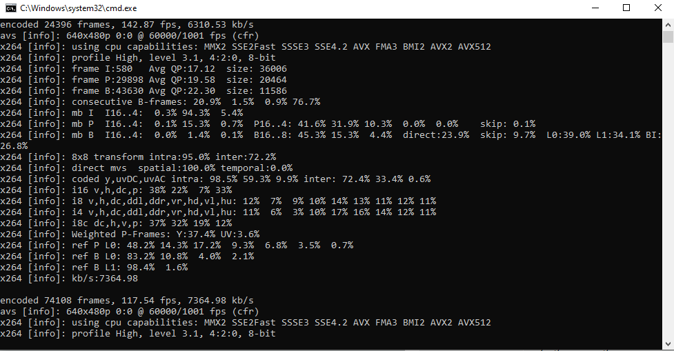

  7. Again this morning...have a simple batch file that calls x264 to encode 23 files in a folder...It does the first 2 and then stalls when starting the 3rd....see screen shot
    Checked windows event logs and nothing raises any flags. Can't for the life of me figure out what's going on. No virus scanning or anything is going on when this happens. This happens when I'm both encoding to a local drive as well as when I'm encoding on a network drive.
    Reinstalled AviSynth Plus...couldn't upgrade to the newest version as my script broke and I couldn't figure out how to get QTGMC to work with it so I'm still running 3.5....arghhh this is getting really annoying!
