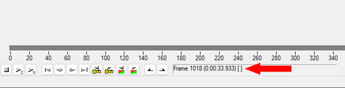

I am wondering if there is a way to see how many frames a video has. Media info is awesome, but I can’t find out how many frames a video has. Any ideas?

Open it in Virtualdub2 and you can see the actual count.
[Attachment 63292 - Click to enlarge]It's not important the problem be solved, only that the blame for the mistake is assigned correctly -

For constant frame rate videos you can just multiply the running time (in seconds) by the frame rate (in frames per second). That assumes the tool(s) you use report those values accurately. For variable frame rate videos you need a program that parses the video and counts the frames. As is the case with the aforementioned VirtualDub2.
