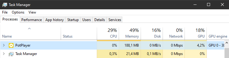

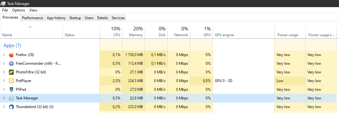

    EDIT: It happened again, here is the screenshot from Task Manager.
Name:	PotPlayer strange playlist delay issue.png
