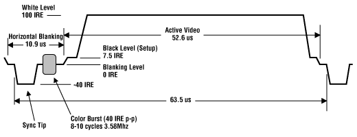

    [Attachment 63375 - Click to enlarge]
    As you can see the horizontal blanking level defines IRE 0. The horizontal sync pulse is supposed to be at -40 IRE. If, for example, a perfect signal has passed through a very long cable the amplitude of the sync pulse might be reduced to -30 IRE. So it is amplified by 1.33 to restore it to -40. The video levels will have been attenuated by the same amount so they are also amplified. If you had adjusted your capture device's proc amp for the original weak signal you will get blown out brights with the fixed levels of the DVD passthrough.
