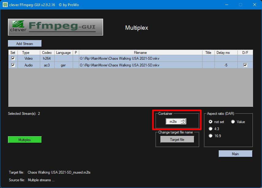

  8. Originally Posted by Dbrow View Post
    Program is telling the it can't mux hevc into M2TS container.
    Tried going from mvk to ts and it tells me it can't mux eac3 into ts container.
    Try the newest beta
    https://files.videohelp.com/u/292773/clever_ffmpeg_gui_newest_beta.7z
    Should work now.
    Feb 2022
    Ontario, Canada
    Try the newest beta
    Should work now.
    Seems to work!
    What about being able mux subs? Had to remove sub to complete this.
