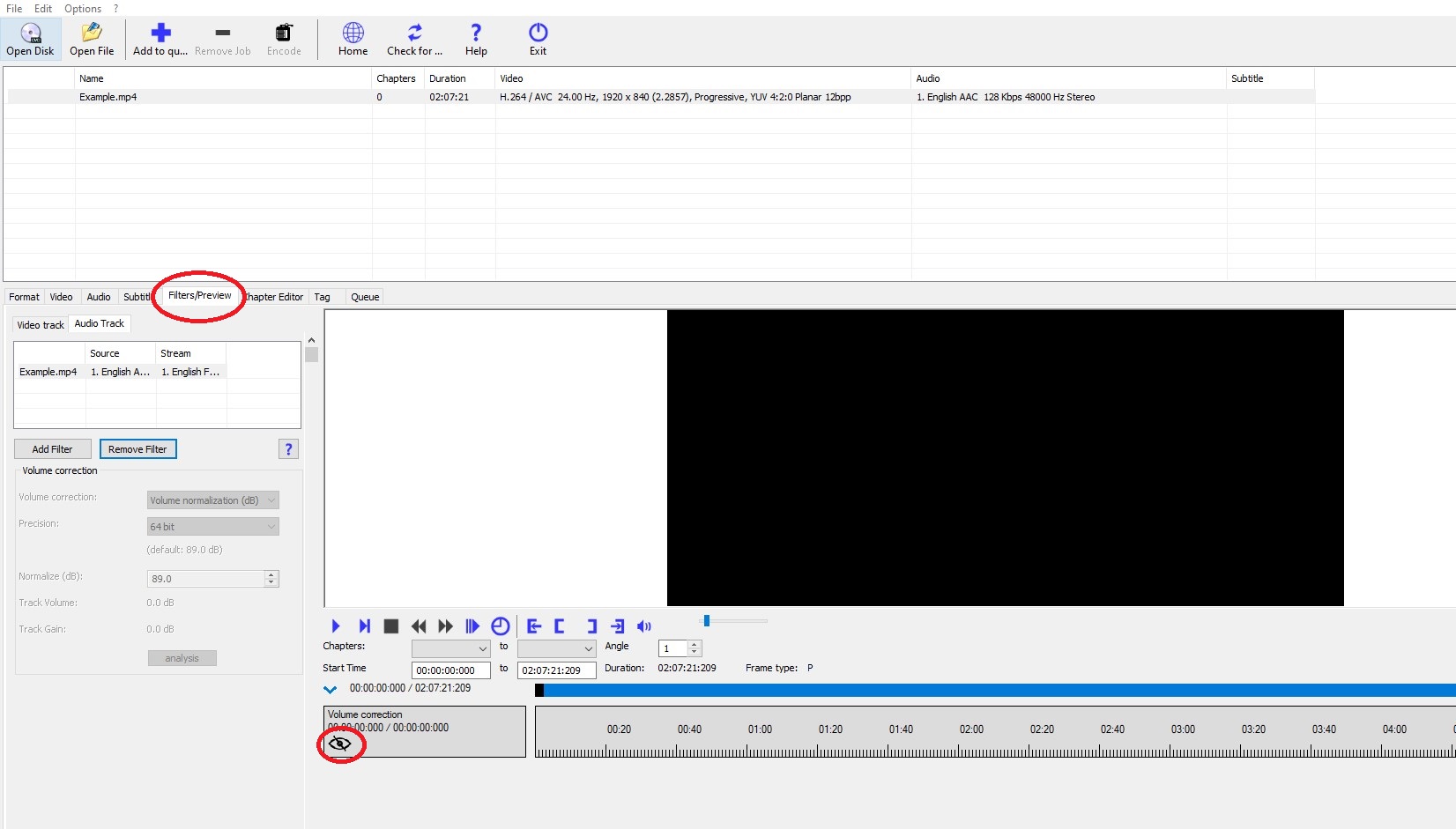

This is now what a re-launch of XMR looks like after having disabled the filter at last use previously:
[Attachment 63245 - Click to enlarge]

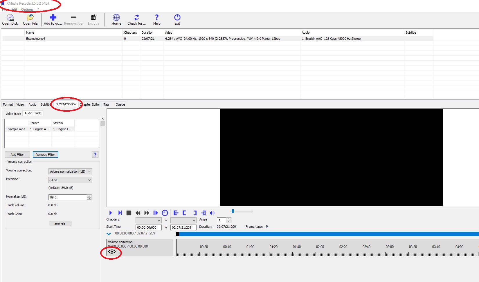

After testing previous versions (ver. 3545 and previous), the filter is "disabled" as expected upon re-launch of XMR:
[Attachment 63246 - Click to enlarge]
I have tried:
1. All versions prior to the last two updates - and the filter is "disabled" as expected on those.
2. A full uninstall (including all obvious references to XMR in the registry) and then a re-install of the current version.
3. "Right-Click" and remove the filter entirely. It always returned in the "enabled" state on re-launch.
I'd like to keep the most recent XMR versions as I want the up-to-date FFMPEG that comes with them.
Curious if other XMR user's "Volume Correction" filter is now always enabled as a default or if it a switch that I've missed.
Thanks All.

Hi Cherry Picker,
I'm seeing the same behaviour as you are, in 3.5.5.2. Even after removing the filter, it reappears, enabled, on program restart.
Can't say I've ever used that filter, but I can understand this being annoying.
