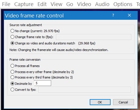

Perhaps try Virtualdub2.
[Attachment 63225 - Click to enlarge]
I have never tried this.
Cheers. -

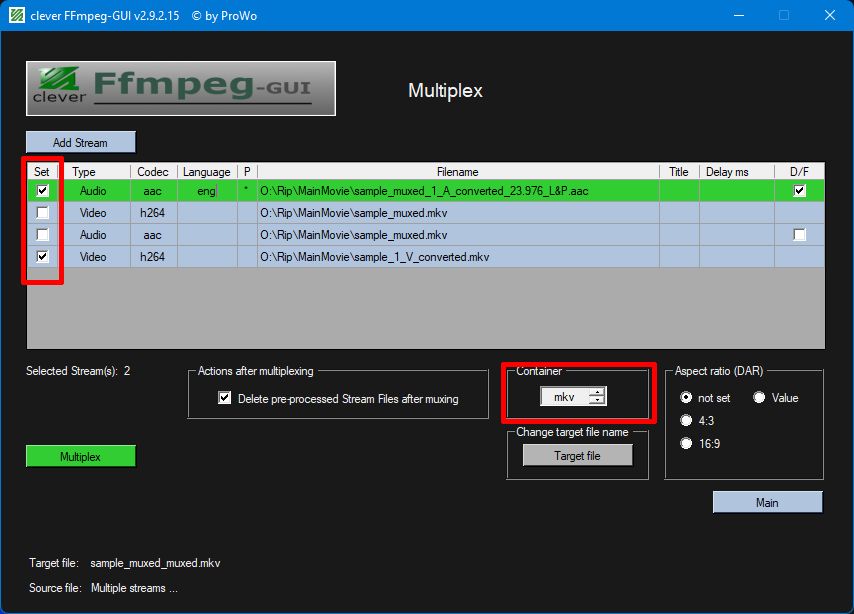

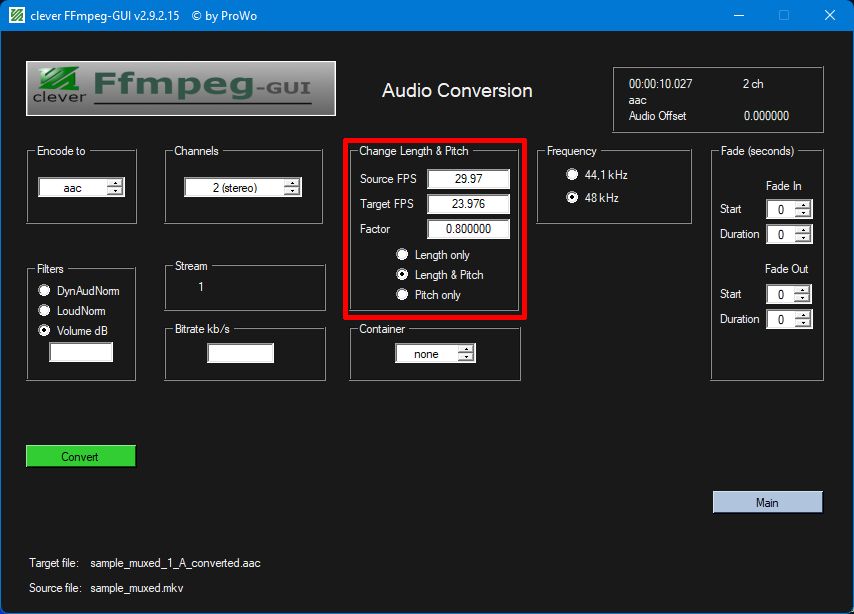

Try clever FFmpeg-GUI.
Load your original 29.970 fps file, click main, click convert audio stream, click continue, leave all settings as they are except the settings marked in red in the following picture.
Enter the exact same values, click convert, wait until it is completed.
[Attachment 63226 - Click to enlarge]
Then click multiplex, the new created audiostream is shown in green, click Add Stream, add your modified 23.976 fps videostream, deselect the video and audiostream of the 29.970 fps video, select the desired container, click multiplex. Done.
[Attachment 63227 - Click to enlarge] -
