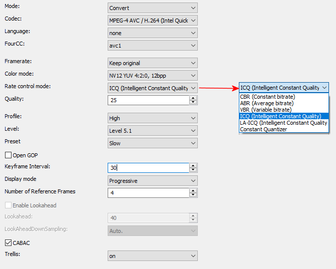

  10. Here on Win10 notebook there is no CRF mode (in free, wide spread Xmedia Recode tool, GUI based on ffmpeg).
    See attached snapshot
    I used ICQ instead. with quality level 25.
    The difference in file size is 25%
    That seems to be too big.

  12. ICQ Level=25 results in a bitrate of ~3500
    So its by far not a low quality settings
  13. ans using the same setting, but with a keyframe interval of 250 results in a bitrate of ~2800 (=3500/1.25) that seems too much judging by what x264 for example would do.
    (I would have expected something around may be 10%, but not 25%)
    Seems like QSV isn't that good saving bitrate with low gop sizes.
