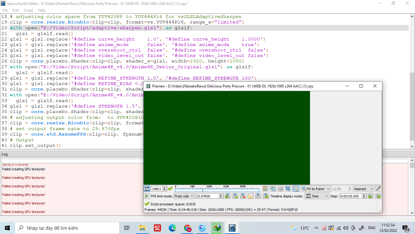

I have tried this but...
[Attachment 63327 - Click to enlarge] -

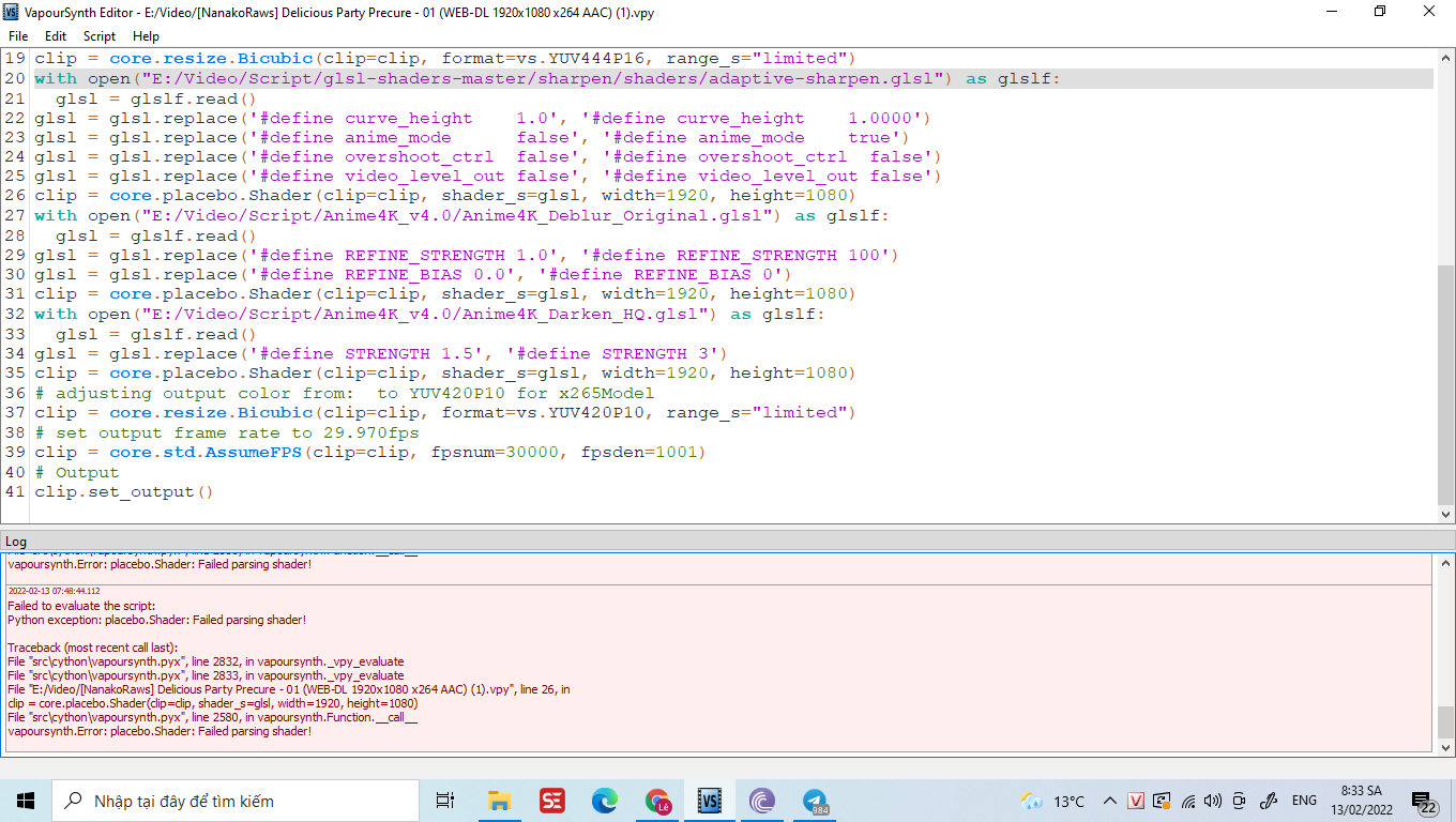

The glsl shaders for placebo.Shader have to be in mpv compatible syntax
The path that you're using glsl-shaders-master/sharpen... suggests to me they were from a collection of shaders, but not in mpv format , probably this one
https://github.com/libretro/glsl-shaders
Use this one for adaptive-sharpen.glsl
https://gist.github.com/HolyWu/72fbe92c2b4700243adb502526a88591 -
The green video:
[Attachment 63332 - Click to enlarge]
Code:# Imports import vapoursynth as vs # getting Vapoursynth core core = vs.core # Loading Plugins core.std.LoadPlugin(path=r"E:\Video\Script\libvs_placebo.dll") core.std.LoadPlugin(path=r"E:\Video\Script\L-SMASH-Works_20210423\plugins64\LSMASHSource.dll") # source: 'E:\Video\[NanakoRaws] Delicious Party Precure - 01 (WEB-DL 1920x1080 x264 AAC).mp4' # current color space: YUV420P8, bit depth: 8, resolution: 1920x1080, fps: 29.97, color matrix: 709, yuv luminance scale: limited, scanorder: progressive # Loading E:\Video\[NanakoRaws] Delicious Party Precure - 01 (WEB-DL 1920x1080 x264 AAC).mp4 using LibavSMASHSource clip = core.lsmas.LibavSMASHSource(source="E:/Video/[NanakoRaws] Delicious Party Precure - 01 (WEB-DL 1920x1080 x264 AAC).mp4") # making sure input color matrix is set as 709 clip = core.resize.Bicubic(clip, matrix_in_s="709",range_s="limited") # making sure frame rate is set to 29.970 clip = core.std.AssumeFPS(clip=clip, fpsnum=30000, fpsden=1001) # Setting color range to TV (limited) range. clip = core.std.SetFrameProp(clip=clip, prop="_ColorRange", intval=1) # adjusting color space from YUV420P8 to YUV444P16 for vsGLSLAdaptiveSharpen clip = core.resize.Bicubic(clip=clip, format=vs.YUV444P16, range_s="limited") with open("E:/Video/Script/adaptive-sharpen.glsl") as glslf: glsl = glslf.read() glsl = glsl.replace('#define curve_height 1.0', '#define curve_height 1.0000') glsl = glsl.replace('#define anime_mode false', '#define anime_mode true') glsl = glsl.replace('#define overshoot_ctrl false', '#define overshoot_ctrl false') glsl = glsl.replace('#define video_level_out false', '#define video_level_out false') clip = core.placebo.Shader(clip=clip, shader_s=glsl, width=1920, height=1080) with open("E:/Video/Script/Anime4K_v4.0/Anime4K_Deblur_Original.glsl") as glslf: glsl = glslf.read() glsl = glsl.replace('#define REFINE_STRENGTH 1.0', '#define REFINE_STRENGTH 100') glsl = glsl.replace('#define REFINE_BIAS 0.0', '#define REFINE_BIAS 0') clip = core.placebo.Shader(clip=clip, shader_s=glsl, width=1920, height=1080) with open("E:/Video/Script/Anime4K_v4.0/Anime4K_Darken_HQ.glsl") as glslf: glsl = glslf.read() glsl = glsl.replace('#define STRENGTH 1.5', '#define STRENGTH 3') clip = core.placebo.Shader(clip=clip, shader_s=glsl, width=1920, height=1080) # adjusting output color from: to YUV420P10 for x265Model clip = core.resize.Bicubic(clip=clip, format=vs.YUV420P10, range_s="limited") # set output frame rate to 29.970fps clip = core.std.AssumeFPS(clip=clip, fpsnum=30000, fpsden=1001) # Output clip.set_output() -
"Failed creating GPU textures"
Not sure , that script works for me with those shaders

That particular shader combination does not improve the aliasing (the broken / jaggy line problems) . I think Selur was using it to illustrate line darkening , deblur, sharpen filters -
Yes, I mainly posted this to show an alternative route.
libplacebo should work, without cuda.
-> try updating your gpu drivers. (Windows defaults drivers may lack some features.)
