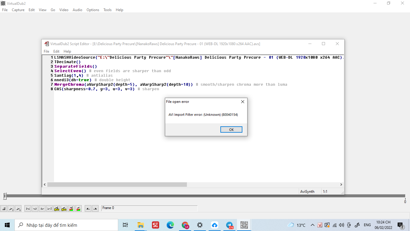

    Have errorImage
    [Attachment 63208 - Click to enlarge]
  6. You have too many double quotes in your path/filename. Like "C:\Path To\Your Video File.mp4".
    Even I deleted those quotes, the problem still like this.
  8. Post you entire script as text, like I did (copy/paste).
    I can't see the extension in your post but note that LSMASHVideoSource() only works for MP4, MOV, and M4V files. Use LWlibavVideoSource() for MKV and other containers.
    Do you have the LSMASH source filter installed? https://avisynth.nl/index.php/LSMASHSource

    #LoadPlugin("E:\Delicious Party♡Precure\L-SMASH-Works-20210811\x64\LSMASHSource.dll")
    LSMASHVideoSource("E:\"Delicious Party♡Precure"\"[NanakoRaws] Delicious Party♡Precure - 01 (WEB-DL 1920x1080 x264 AAC).mp4"", prefer_hw=2)
    TDecimate()
    SeparateFields()
    SelectEven() # even fields are sharper than odd
    Santiag(1,4) # antialias
    nnedi3(dh=true) # double height
    MergeChroma(aWarpSharp2(depth=5), aWarpSharp2(depth=10)) # smooth/sharpen chroma more than luma
    CAS(sharpness=0.7, y=3, u=3, v=3) # sharpen
  10. You still have too many quotes in the path\filename. There should only be one quote at the start and one quote at the end:
    LSMASHVideoSource("E:\Delicious Party♡Precure\[NanakoRaws] Delicious Party♡Precure - 01 (WEB-DL 1920x1080 x264 AAC).mp4", prefer_hw=2)
    But LSMASH may also have problems with the non-ascii characters too. Rename the folder and file to something simple like:
    folder:
    E:\Delicious
    and filename:
    Delicious1.mp4
    Then use:
    LSMASHVideoSource("E:Delicous\Delicious1.mp4")

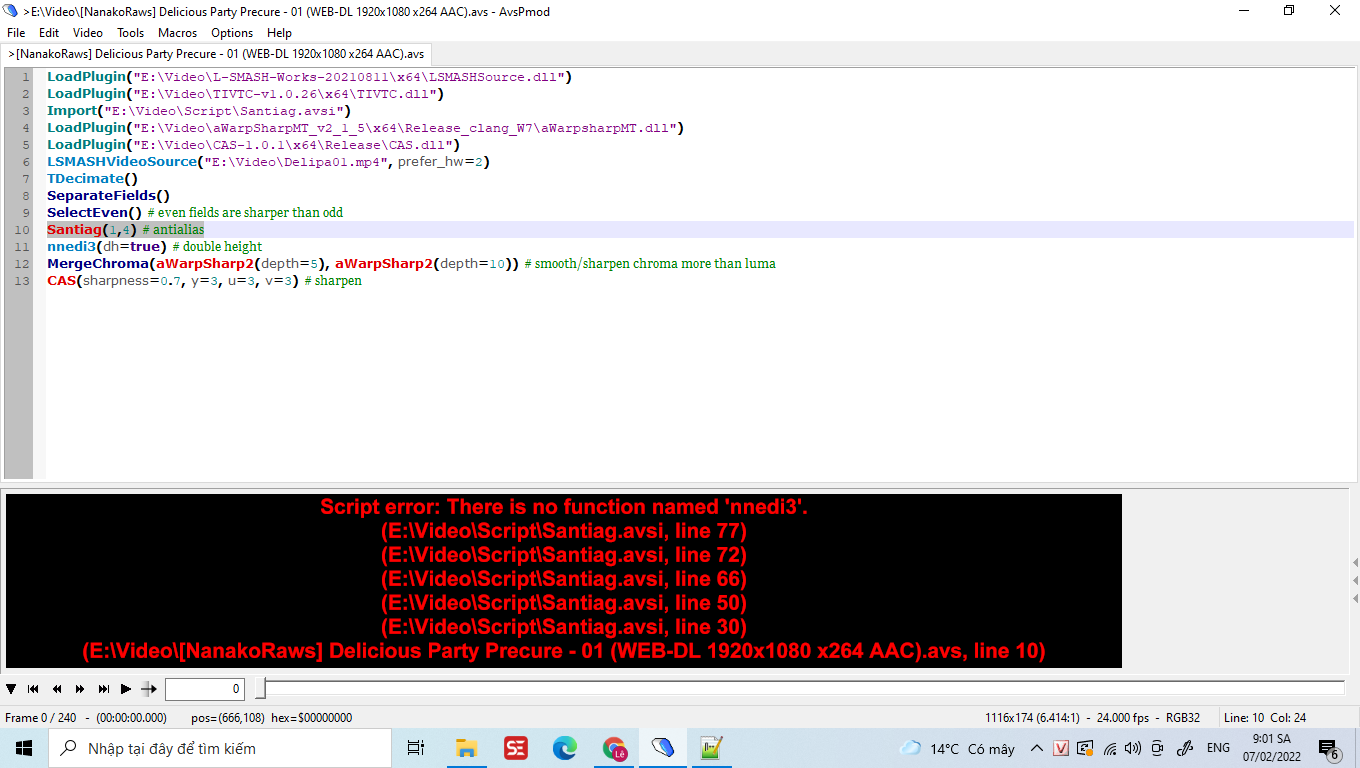

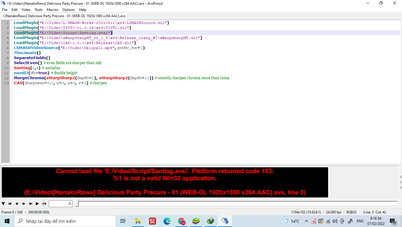

  11. Still error, but this is santiag script
    [Attachment 63210 - Click to enlarge]
  12. Santiag isn't a plugin (DLL). It's a script (AVS or AVSI). Use Import() instead of LoadPlugin().
  13. Originally Posted by jagabo View Post
    Still error
    [Attachment 63211 - Click to enlarge]

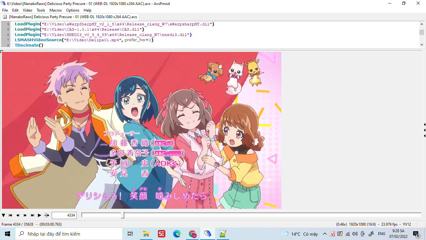

  14. Originally Posted by poisondeathray View Post
    Ok, successfully
    But this scene is some worst...

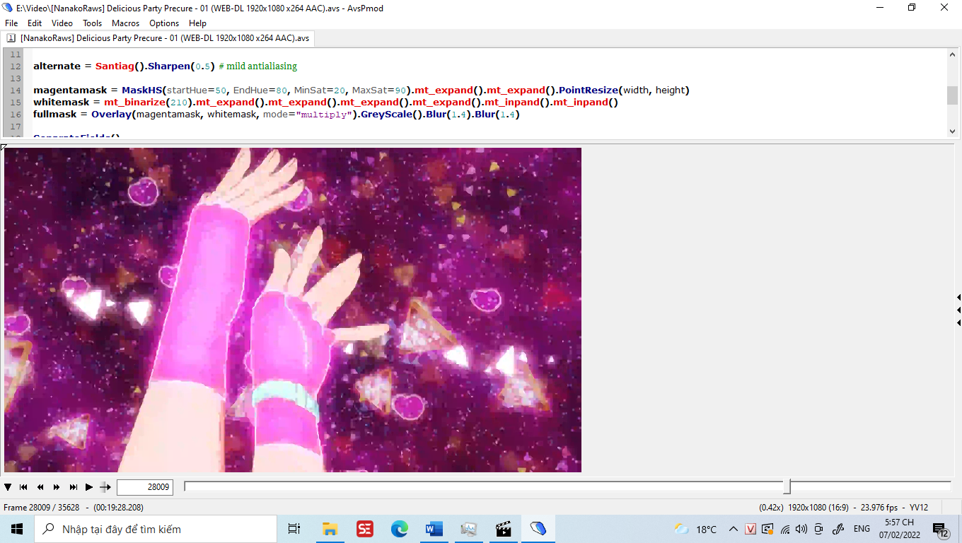

  16. Yes, the antialiasing causes that text overlay to blur. Since the text is magenta with a white outline (some of it is the other way around) you can build a mask of areas where magenta and and white are near each other. The original (or more mildly antialiased) video over those areas to keep them from blurring so much.
    LSMASHVideoSource("Nanako.mp4", prefer_hw=2)
    TDecimate()
    alternate = Santiag().Sharpen(0.5) # mild antialiasing
    magentamask = MaskHS(startHue=50, EndHue=80, MinSat=20, MaxSat=90).mt_expand().mt_expand().PointResize(width, height)
    whitemask = mt_binarize(210).mt_expand().mt_expand().mt_expand().mt_expand().mt_inpand().mt_inpand()
    fullmask = Overlay(magentamask, whitemask, mode="multiply").GreyScale().Blur(1.4).Blur(1.4)
    SeparateFields()
    SelectEven()#Merge(SelectEven(), SelectOdd())
    Santiag(1,4)
    nnedi3(dh=true)
    Overlay(last, alternate, mask=fullmask)
    That first makes an alternate, less antialiased version of the video. Then builds a mask of magenta areas, a mask of white areas, then performs a logical and of those two areas to create a mask. If you view full mask you'll it most just covers that magenta text with white outlines. The video is then cleaned as before. Finally, the alternate video is overlaid onto the antiliased video to restore the magenta text.

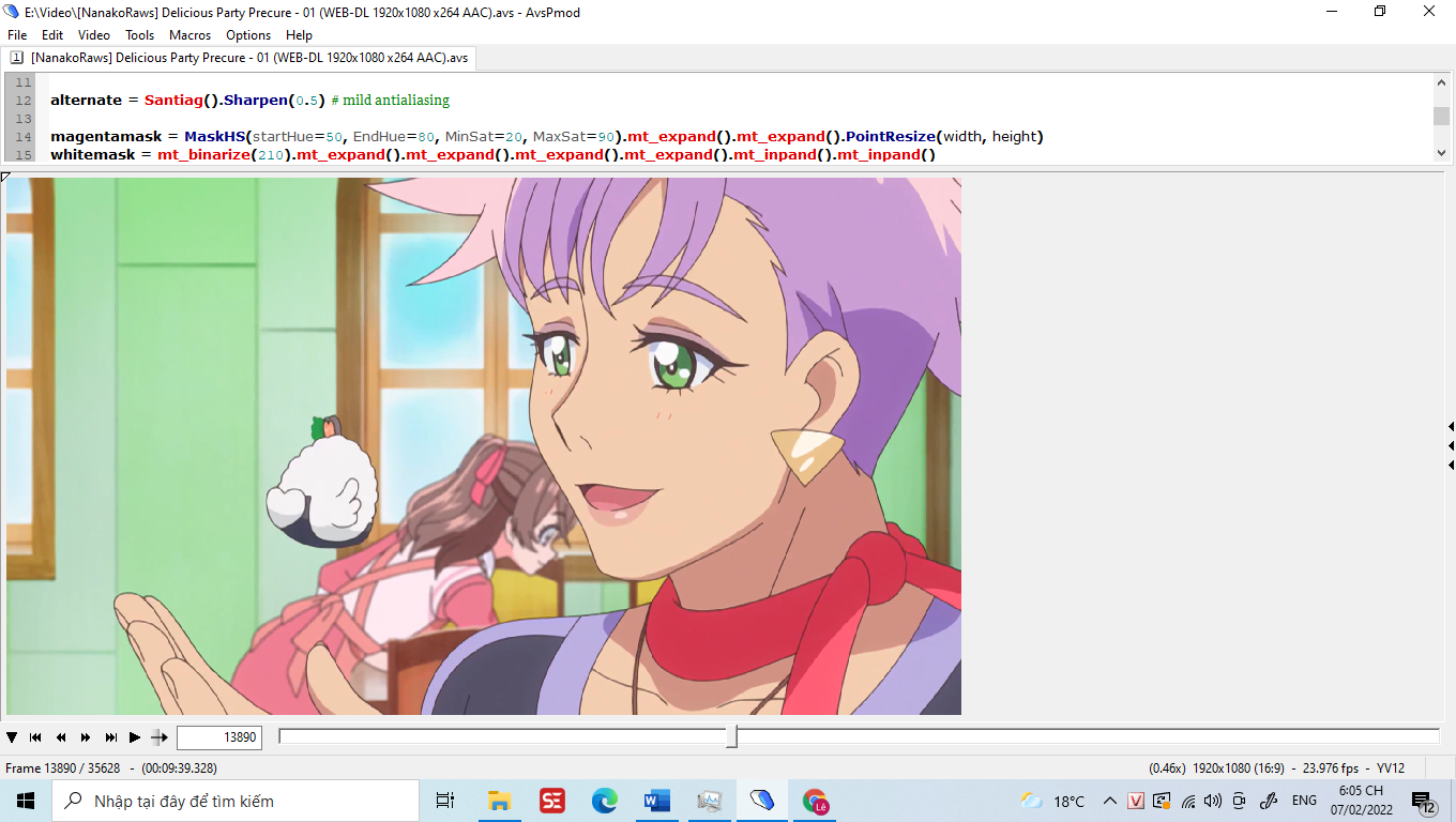

  17. a. Intro&Outro need to be filtered differently than the rest.
    b. I doubt that any filter can restore the outro to something I would call 'okay', imhop some parts of the outro are just missing too much actual details.
  18. Originally Posted by Selur View Post

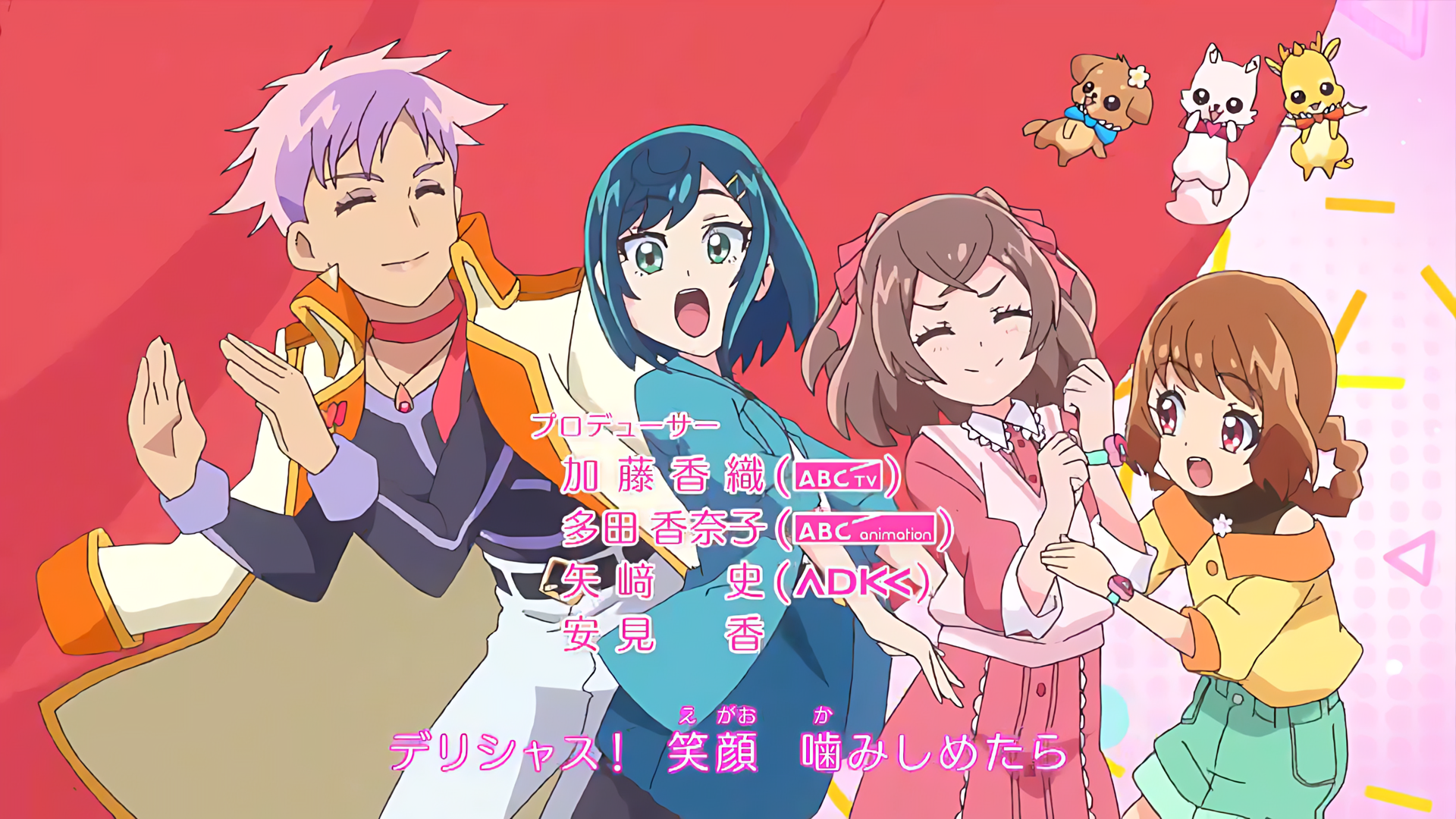

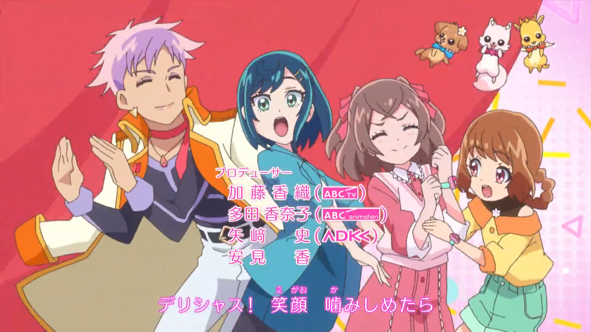

    Yeah, for example, this picture:
    [Attachment 63218 - Click to enlarge]
    also, the character border feels unpolished and has a bit of jagged edges
    [Attachment 63219 - Click to enlarge]
    I don't know what script can fix this?

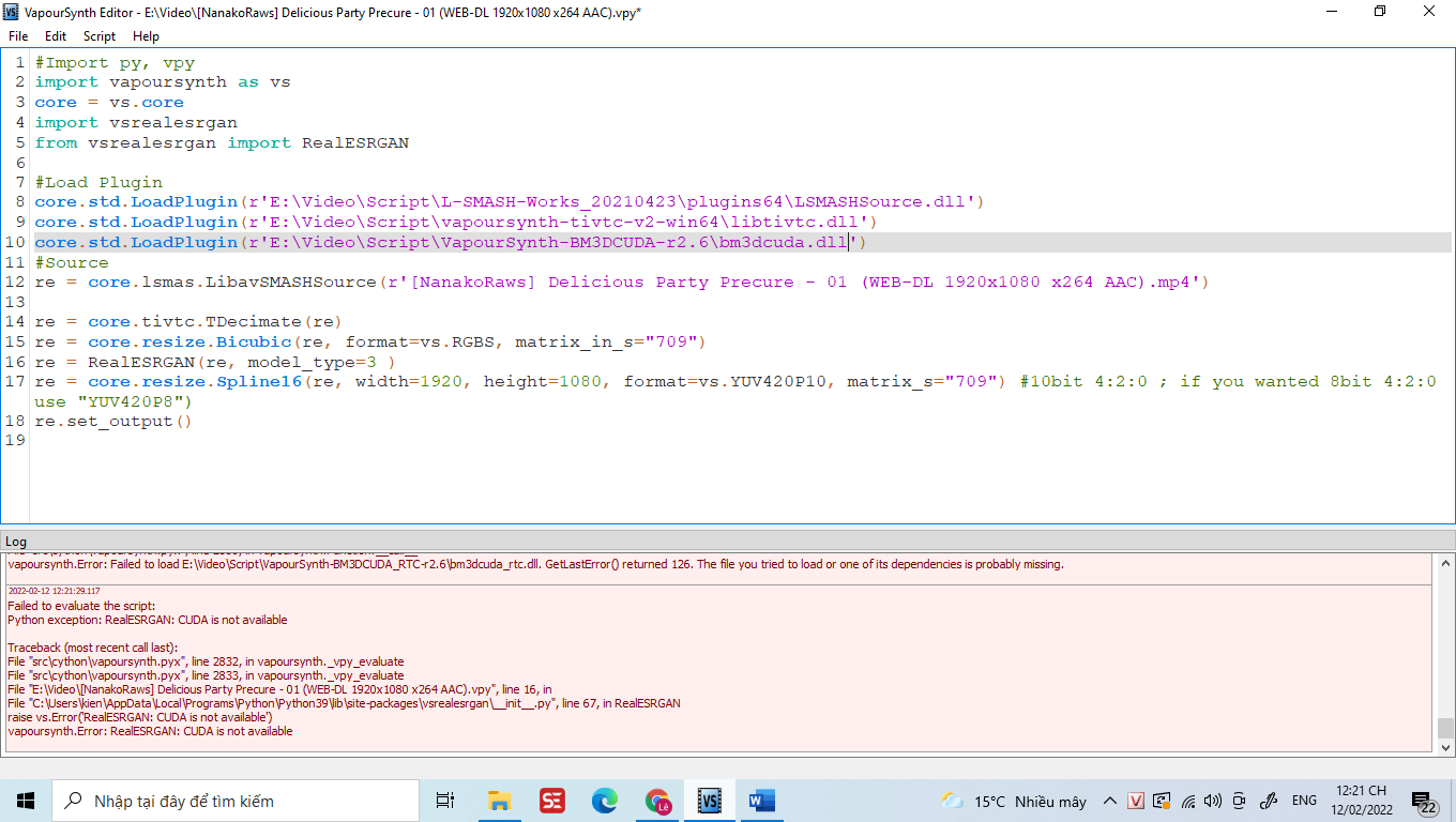

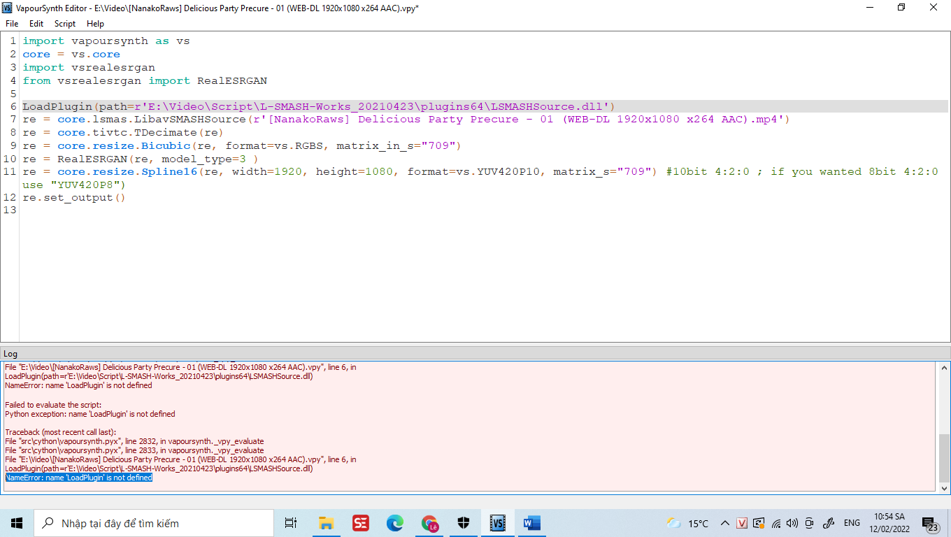

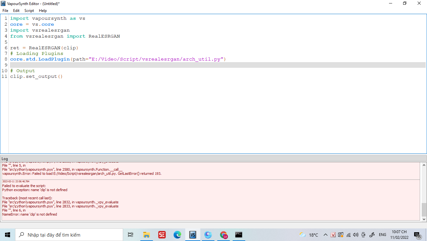

    How to use it?
    [Attachment 63286 - Click to enlarge]
    Which step I wrong?
  26. Originally Posted by kienkzz View Post
    Which step I wrong?
    You need a source filter to load video, similar to avisynth ( e.g LSmash)
    re = core.lsmas.LibavSMASHSource(r'PATH\[NanakoRaws] Delicious PartyPrecure - 01 (WEB-DL 1920x1080 x264 AAC).mp4')
    re = core.tivtc.TDecimate(re)
    re = core.resize.Bicubic(re, format=vs.RGBS, matrix_in_s="709")
    re = RealESRGAN(re, model_type=3 )
    re = core.resize.Spline16(re, width=1920, height=1080, format=vs.YUV420P10, matrix_s="709") #10bit 4:2:0 ; if you wanted 8bit 4:2:0 use "YUV420P8")
    re.set_output()
    You can use tiling if your GPU does not have enough memory e.g.
    re = RealESRGAN(re, tile_pad=16, tile_x=960, tile_y=540, model_type=3 )
    As the others have mentioned above, you need to filter the different parts, differently.
    This model is probably too "sharp" for other sections, so you might use a smoother downscaler like Bilinear
    One way to modulate the strength of the effect, is to use overlay or merge to combine with original or another filtered version

    re.set_output()
    Have error
    [Attachment 63297 - Click to enlarge]
  28. Code:
    core.std.LoadPlugin(r'PATH\LSMASHSource.dll')
    http://www.vapoursynth.com/doc/functions/general/loadplugin.html
  29. Originally Posted by poisondeathray View Post
    [Attachment 63298 - Click to enlarge]
    Have error
