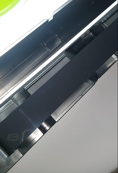

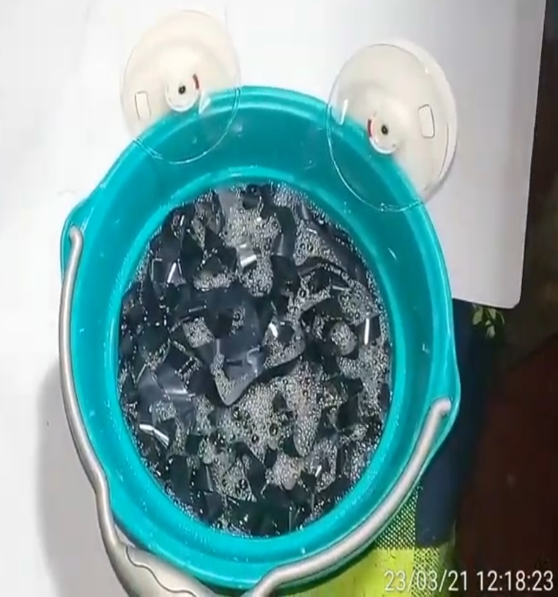

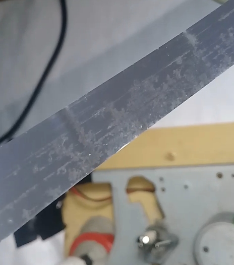

    I work with conversions here in Brazil and in my place, Amazonia, there are a lot of fungi and insects that cause a slime on these tapes. I have to leave the tape in water with a mild cleaning product.
    I've already taken many tapes between 1986 and 1990's that were very battered by this, but after the treatment the video came up with a clean image.
    But how much longer will the media recorded on this tape last?
    Before and after pictures of the treatment.
    [Attachment 63198 - Click to enlarge]
    [Attachment 63199 - Click to enlarge]
    [Attachment 63200 - Click to enlarge]

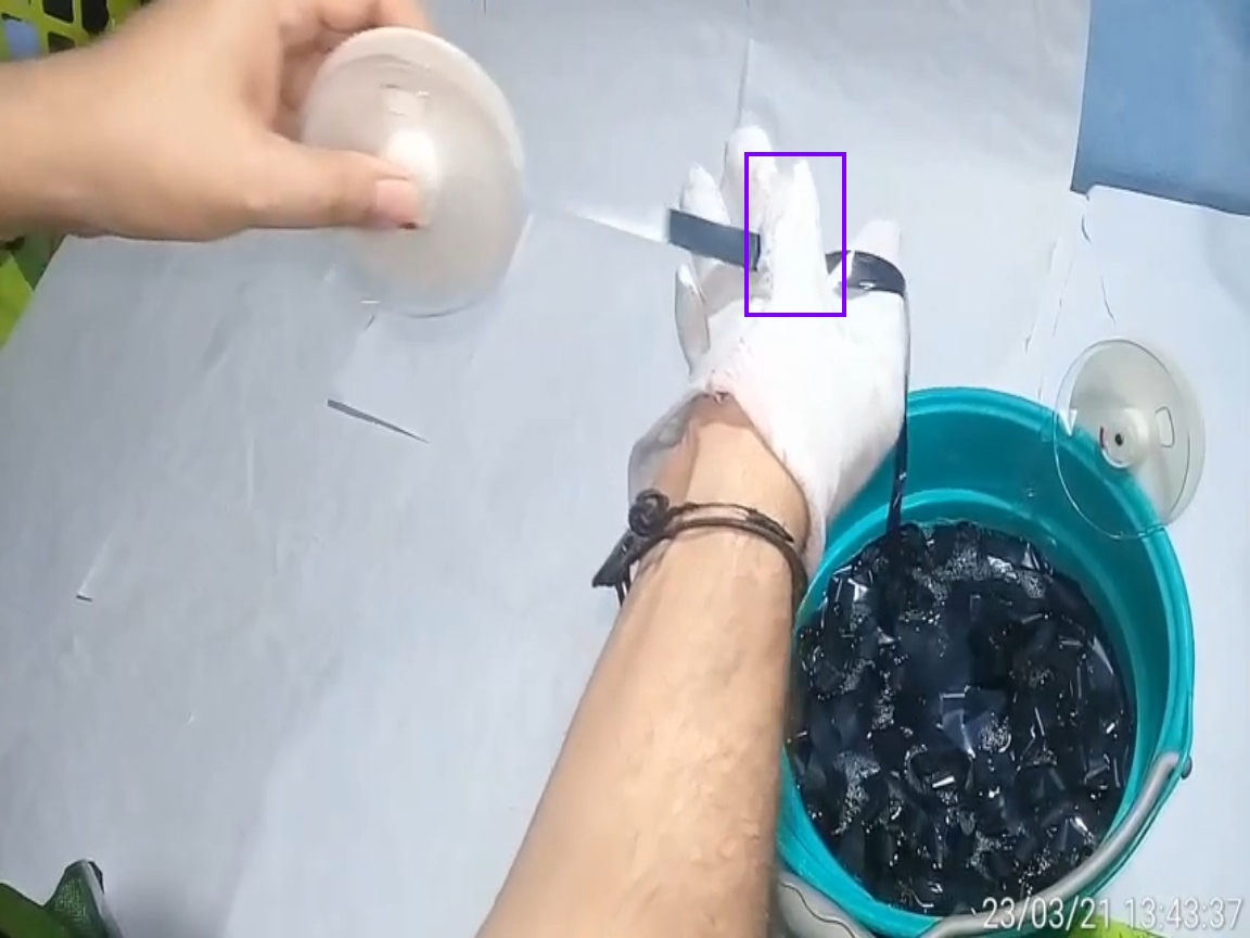

    It is a long process after to remove all the liquid, but with the help of soft cloth gloves, isopropyl alcohol and hairdryer not very strong, I usually complete the entire process in a long tape in 1 hour and 30 minutes more or less.
    Showing a small summary of the treatment and tape retraction and a short video from a 2002 VHS (EP mode) which had this problem.

    I leave it soaked in water for about 3 hours, along with a neutral detergent. The most complicated part is the removal and drying, to Respool everything it takes about five minutes using the device i set up. During glove drying i use isopropyl only, just on the thumb finger.
