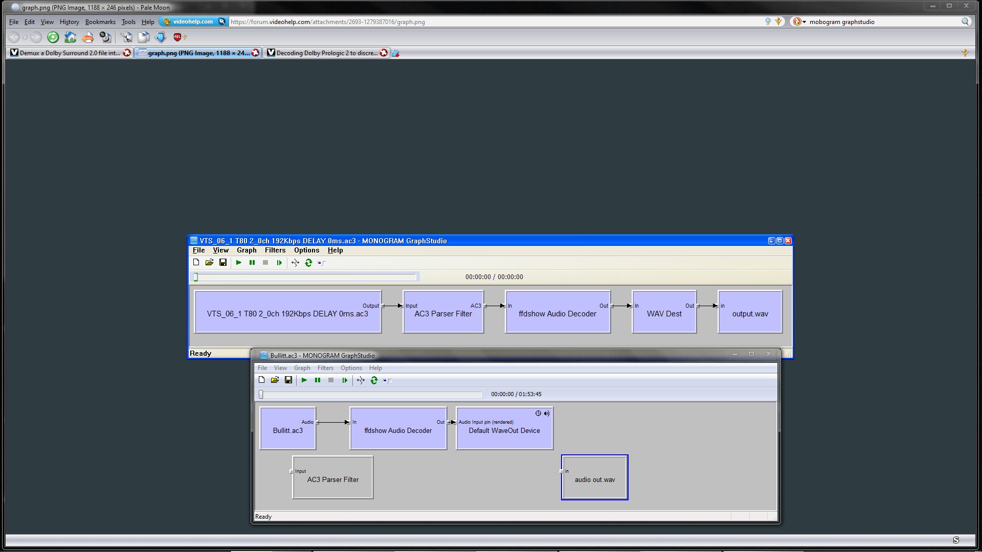

    Thx for the responses:
    following jagabo's direction on how to build the chain I'm running into an issue where connecting the chain together to get the program to run.....the program will not accept the chain of command I manually enter. If one uses the programs auto command the chain is not what jagabo describes.
    I cannot insert the desired filters to create a duplicate of what he laid out. The filter dest wav is not included in the filters selection.
    * thx for the heads up on the dest wav being a separate filter one has to install
    [Attachment 63191 - Click to enlarge]
Name:	Graphstudio screenshot.jpg

    my fault (20 years!!!) - filter is named "WAVDEST.AX" try to follow this graph - should work https://forum.doom9.org/showthread.php?t=177350 - graphedit was in use over 20 years ago...

    Still no joy.....the updated graphedit has the filter wavdest.ax, the program graphstudio doesn't recognize the *ax* suffix so it will not load it.
    Even if I paste the ax file into ffdshow the filter is still not recognized.

    You need to install ax filters as dll's in Windows - use admin mode for this
    regsvr32 dump.ax /s
    regsvr32 wavdest.ax /s

    Well, I got it sorted out......
    as it was the old version of Graphstudio did not have the *destwav* built into it, & that old version doesn't like the current *destwav.ax at all.
    the most recent version of graphstudio*next* suffered from the same sort of issue but with one expection, this version saw the recent destwav but wouldn't load it properly so one gets an error message when one tries to use it.
    What I had to do was find an older version of Graphstudio*next* (2014), that version had no issues with any of the filters.
    The ac.3 file loaded as it should, followed the procedure for removing the *sound device* & insert the needed filters, made the chain connection & away it went.
    The program ran for approx 14 mins & processed the ac3 back to wav & sure enough that prologic file has 6 channels embedded in it. They may not be as discrete as what a truehd or DTS file would be but I've got something to work with to re-edit the movie track.
