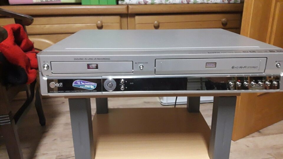

I purchased a second hand Recorder (above) recentley, but when I try to Record a disc be it a DVD R or DVD RW , when the Stop button is pressed the following message comes up "recording file information please wait" , but it just stays there & never Writes anything to the disc.
The Player plays Discs ok, I have put a cleaner through to see if that would help, but to no avail.
Any advice or help would be appreciated
thanks in advance
Very similar to pictured model

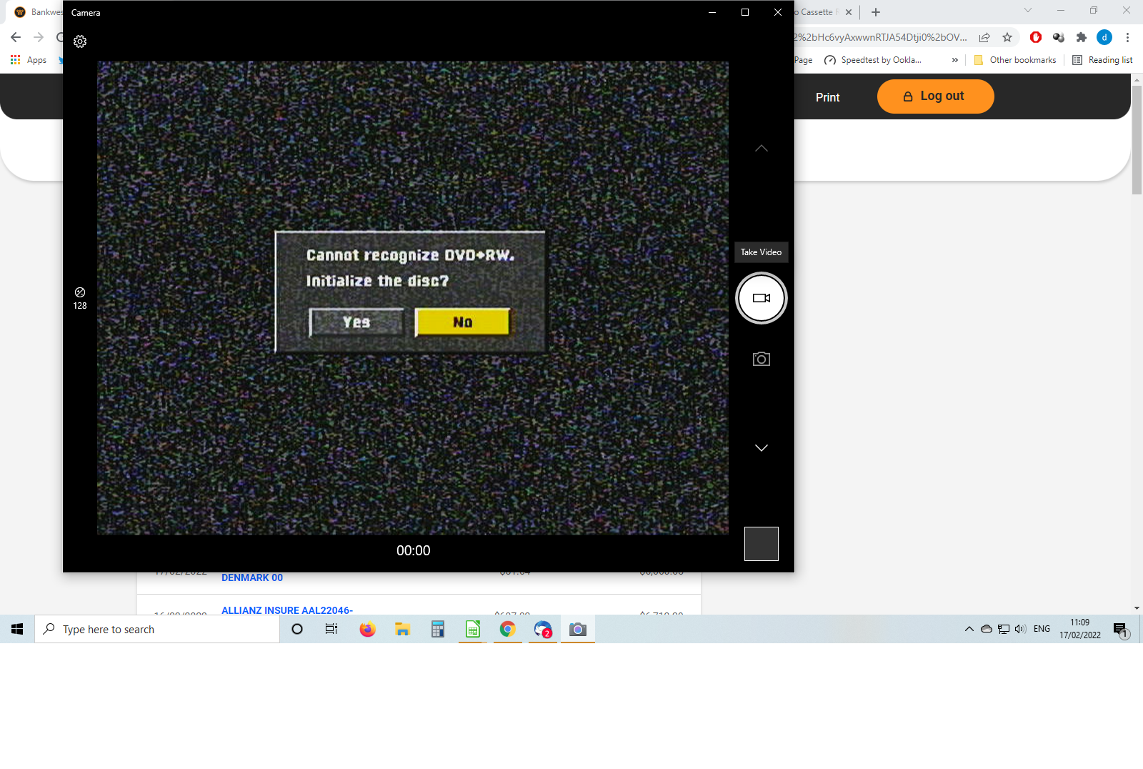

Still no luck here, but now have another query with same machine, have a DVD RW+ with burnt video files on it, but when entering this machine it comes up with cannot recognise DVD RW+ initalize Disc ? If i do what happens to the files on it, or can I Finalize (if not done) to get files back ?
