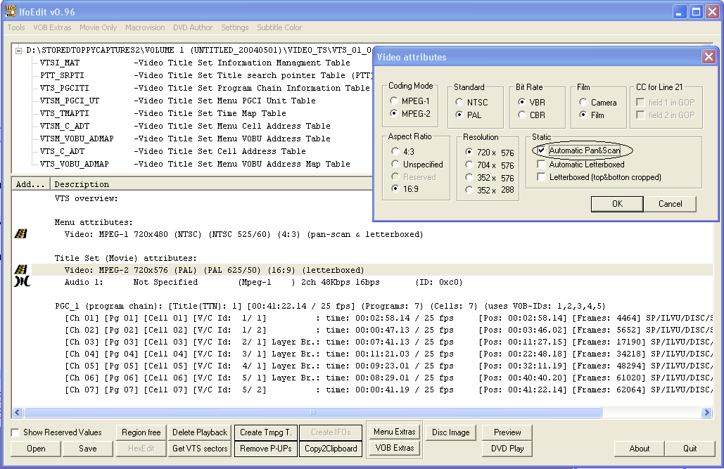

  2. Member Cornucopia's Avatar
    Put it in a hardware player first to make sure it isn't OK and your app is at fault.
    If it is truly messed up, try using ReStream (or DVDPatcher, or MPEGPatcher) to fix it.
    Note: metadata like AR designation exist BOTH on the IFO file level and within the MPEG2 video stream of the VOB. One might be right and the other might be wrong, or both could be wrong. Different players look to different sources to adjust.
  3. Member netmask56's Avatar
    Sep 2005
    Sydney, Australia
    This is the screen in IfoEdit you will need to adjust, if necessary as Cornucopia has remarked
