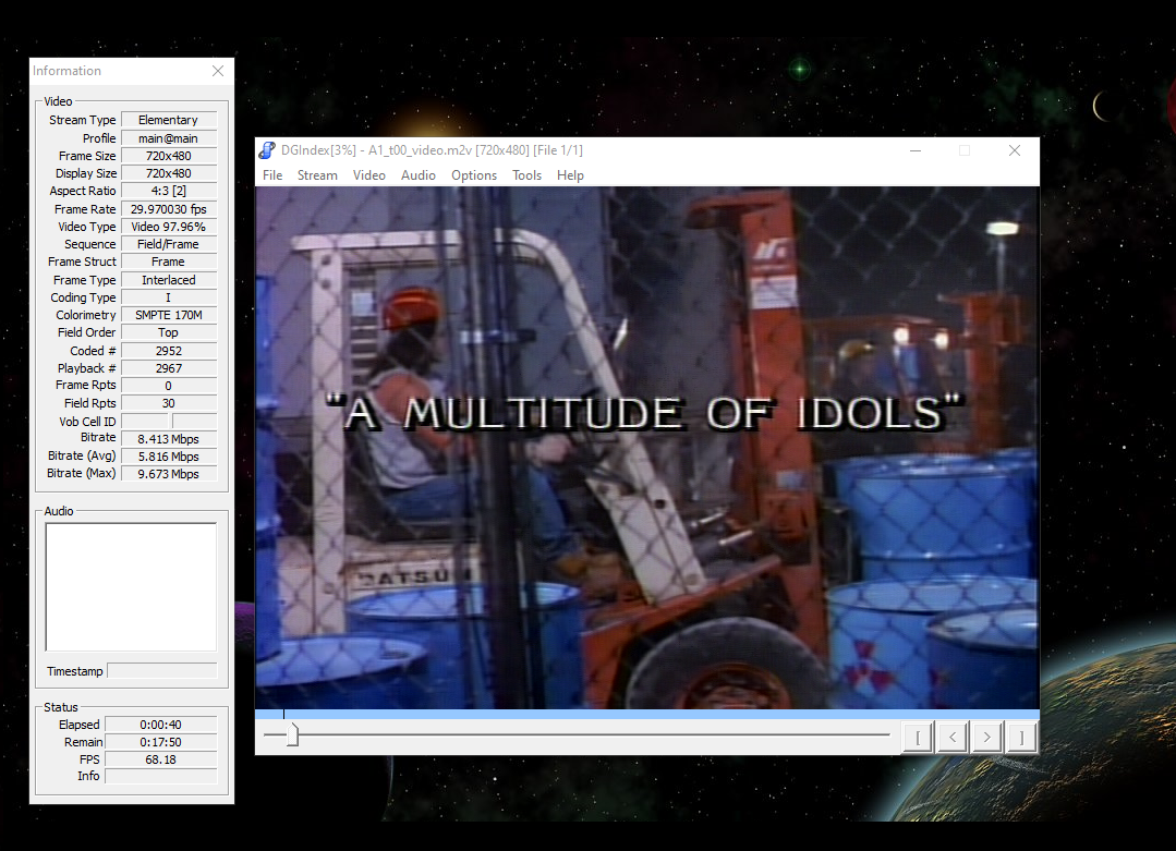

    Here's an image I just took using DGIndex, Dave.
    I thought I remembered it saying Interlaced, and it shows it here in DGIndex.
    [Attachment 84540 - Click to enlarge]
  9. It's only incorrect if you can prove that you don't get the issue when you rip with another program.
    That mkv file you linked, plays back correctly. I can't find anything that reports it being interlaced, but I can see the scan lines if I transcode it at all.
    When I run QTGMC through vapoursynth, it produces a file that is deinterlaced and plays back correctly.

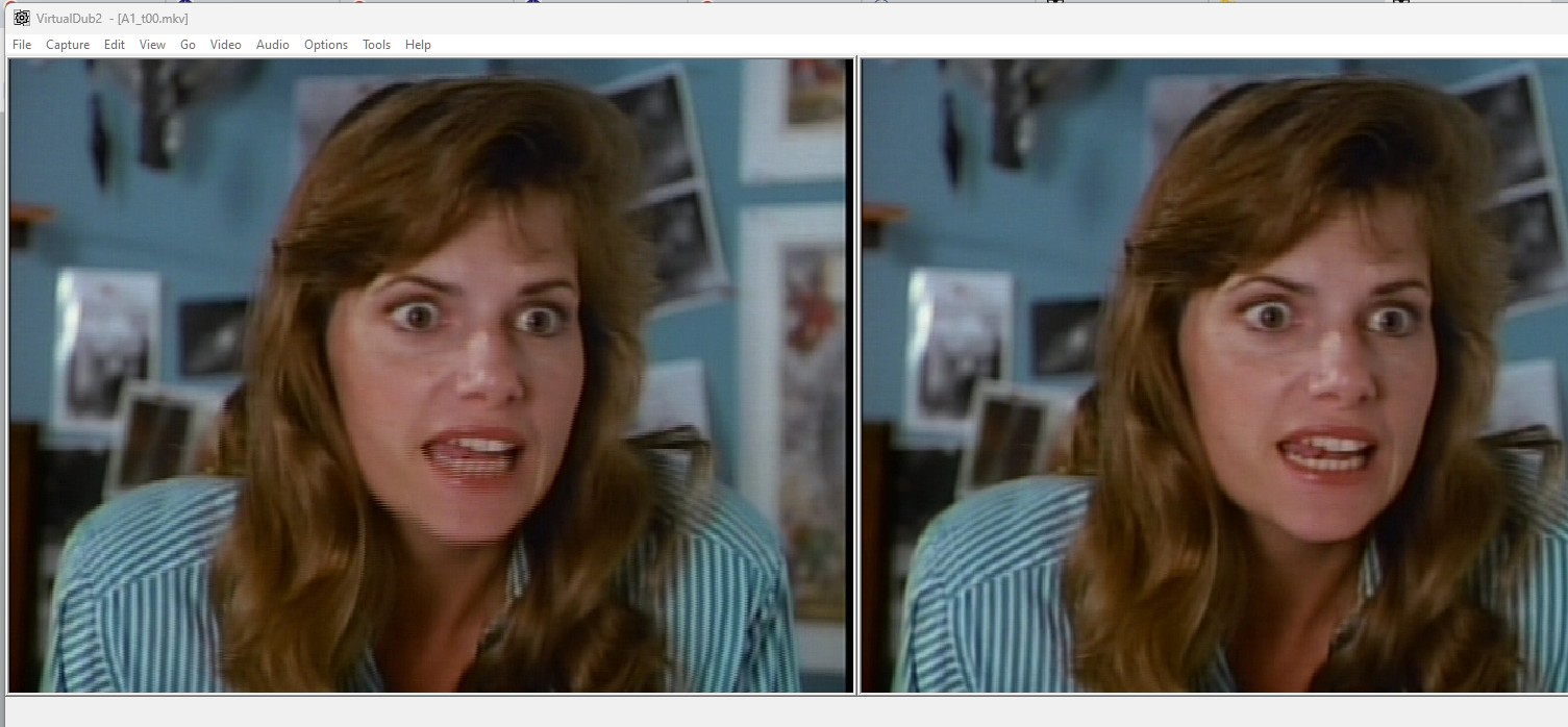

    Definitely, but TFM and TDecimate do a better job. Some VDub IVTCs I've done still have residual artifacts including blending or combing. I think it depends on the source how well VDub does.
    In this case, it looks pretty good (teeth):
    [Attachment 84550 - Click to enlarge]

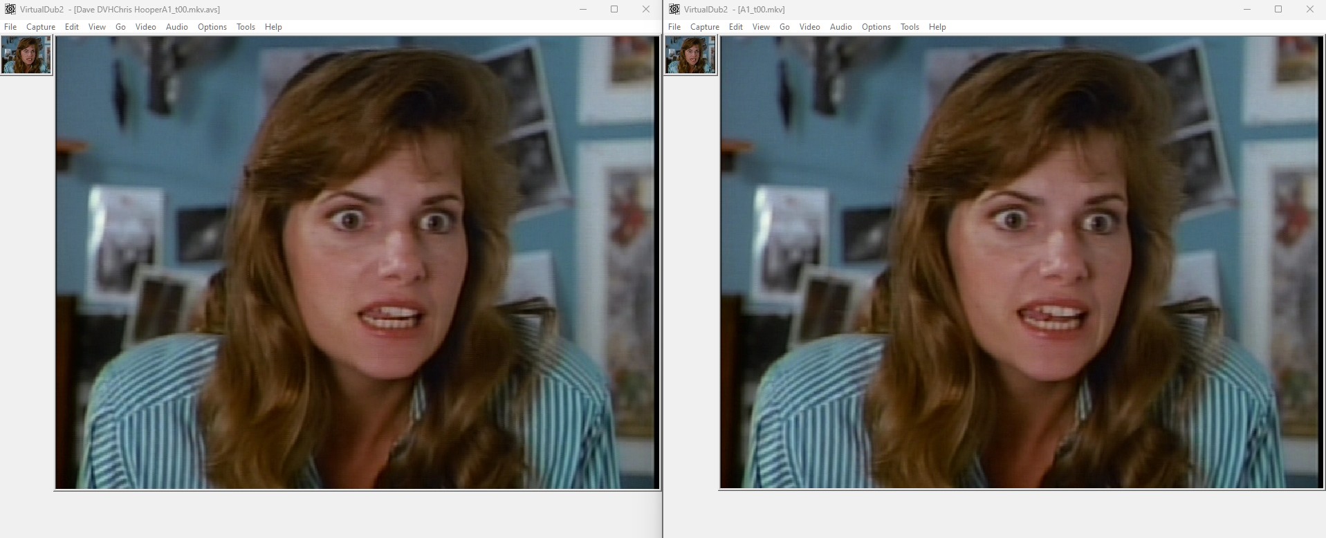

    Here's AVISynth/TFM-Tdec verses VDub TIVTC (Reduce FR, AutoDetect, DAPTIVE). VDub does very well!
    [Attachment 84551 - Click to enlarge]

    Yeah, those were the setting I used on VirtualDub.
