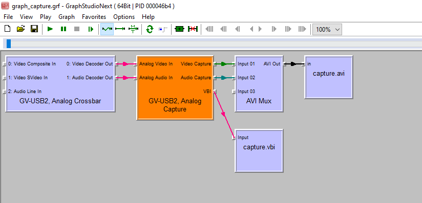

For my current test captures, I've been using GraphStudioNext with a graph that looks like this:
This dumps the raw video, audio and VBI datastreams through DirectShow in perfect step with eachother, so they can be aligned for debugging, VBI viewing, or simple XDS/Caption dumping. But I'm looking to automate this whole process, which is why I'm posting all this. I'd like to be able to start and stop these graphs I've constructed through code (probably Python or something) so I can set record time, easily swap out devices, and go straight to capture data processing once I'm done capturing.

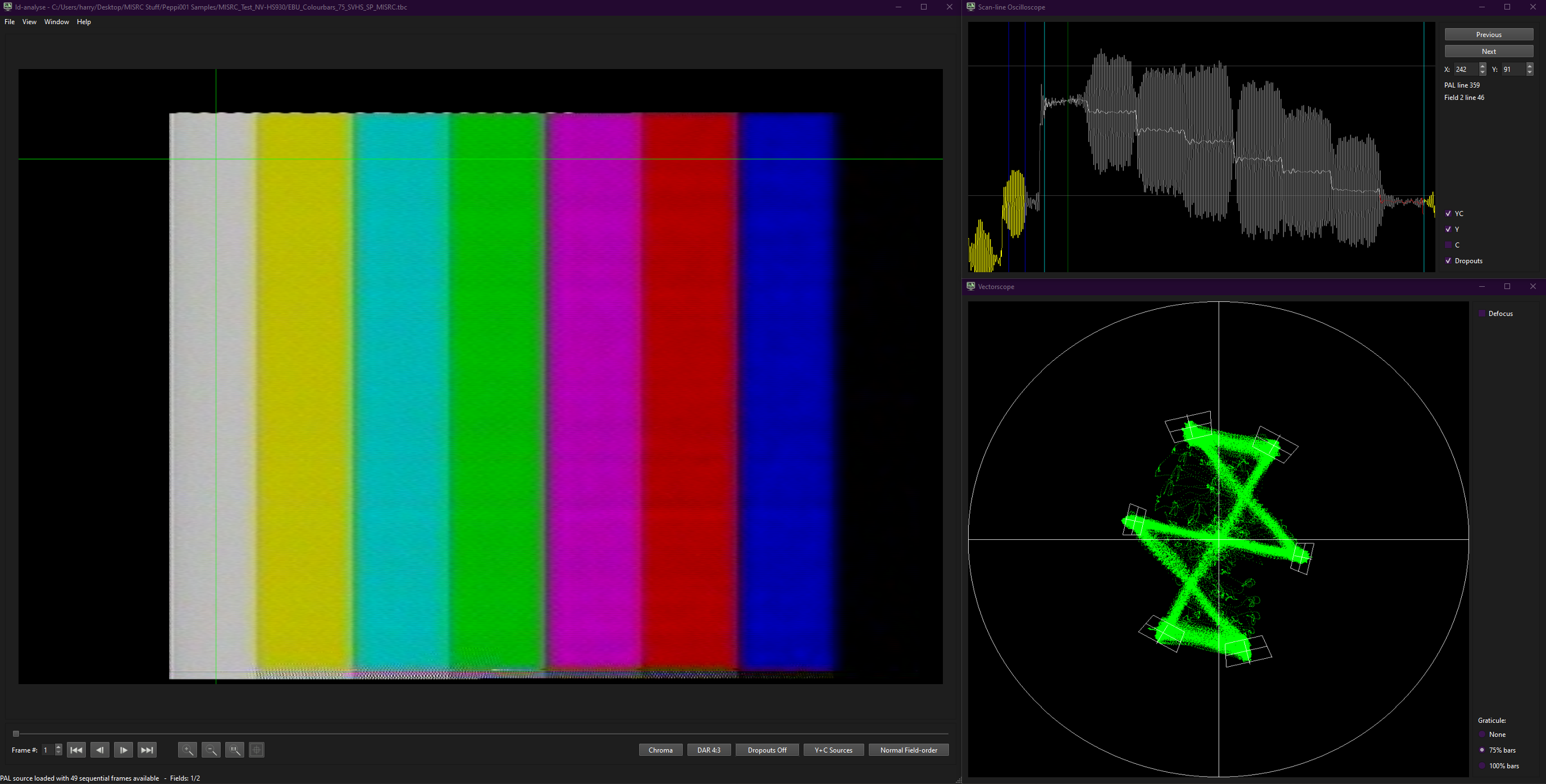

I know this is a slightly older thread but I thought might as well make a "solved forever" end post for it.

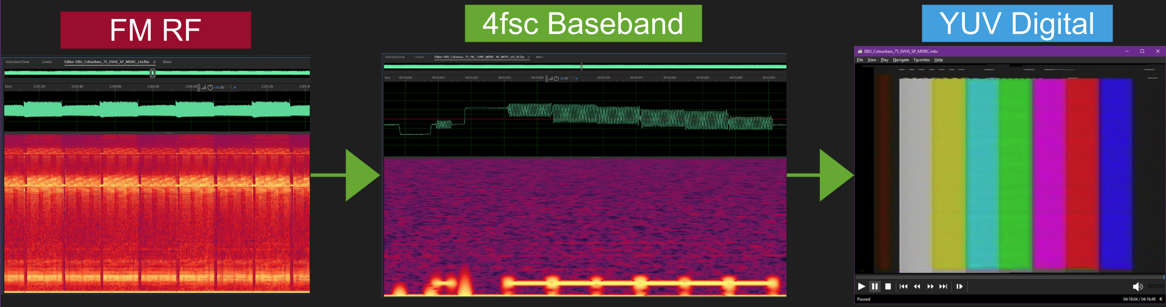

For the last 4 years the most cost effectibe and most easy to deploy workflow for this type of archival has been just the full 4fsc decoded frame from the decode projects using RF captures of the FM RF signals from tapes directly or RAW baseband CVBS if captured properly.
It's the full 4fsc signal in 1135x624 PAL / 910x524 NTSC
And no its not using some fancy capture cards or VBI pins or anything complicated to the lay user who wants to get at the visual data stream, and it costs less then 100USD!
This pretty much the end game for a few things:
- Time Base Correctors (Its done in software at the source signal level)
- Comb Filtering (We have 6 chroma decoder filters anyone want to add more?)
- Vectorscopes (You have S-Video/CVBS on file)
- VBI Data Extraction (You can pull from the Luma raw decoded data or export to IMX hight standard video)

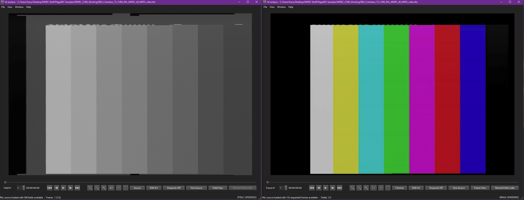

[Attachment 81993 - Click to enlarge]
We even have a pretty bloody powerful Closed Captions Decoder, VITC timecode decoder and VITS decoder (ld-process-vbi and ld-process-vits respectivly) but teletext decoding, WSS - Wide screen signalling and XDS is not yet implimented into the workflow directly.

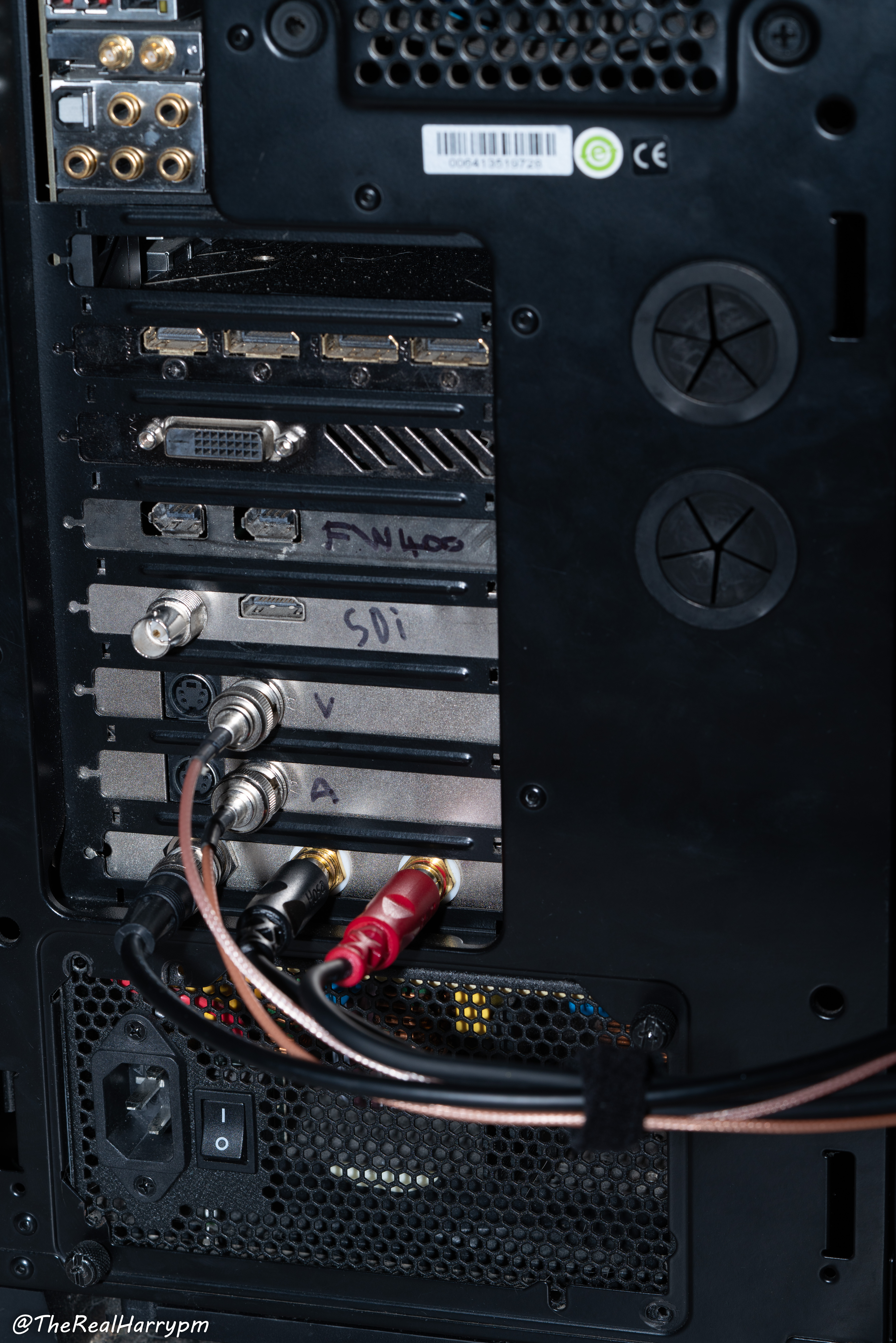

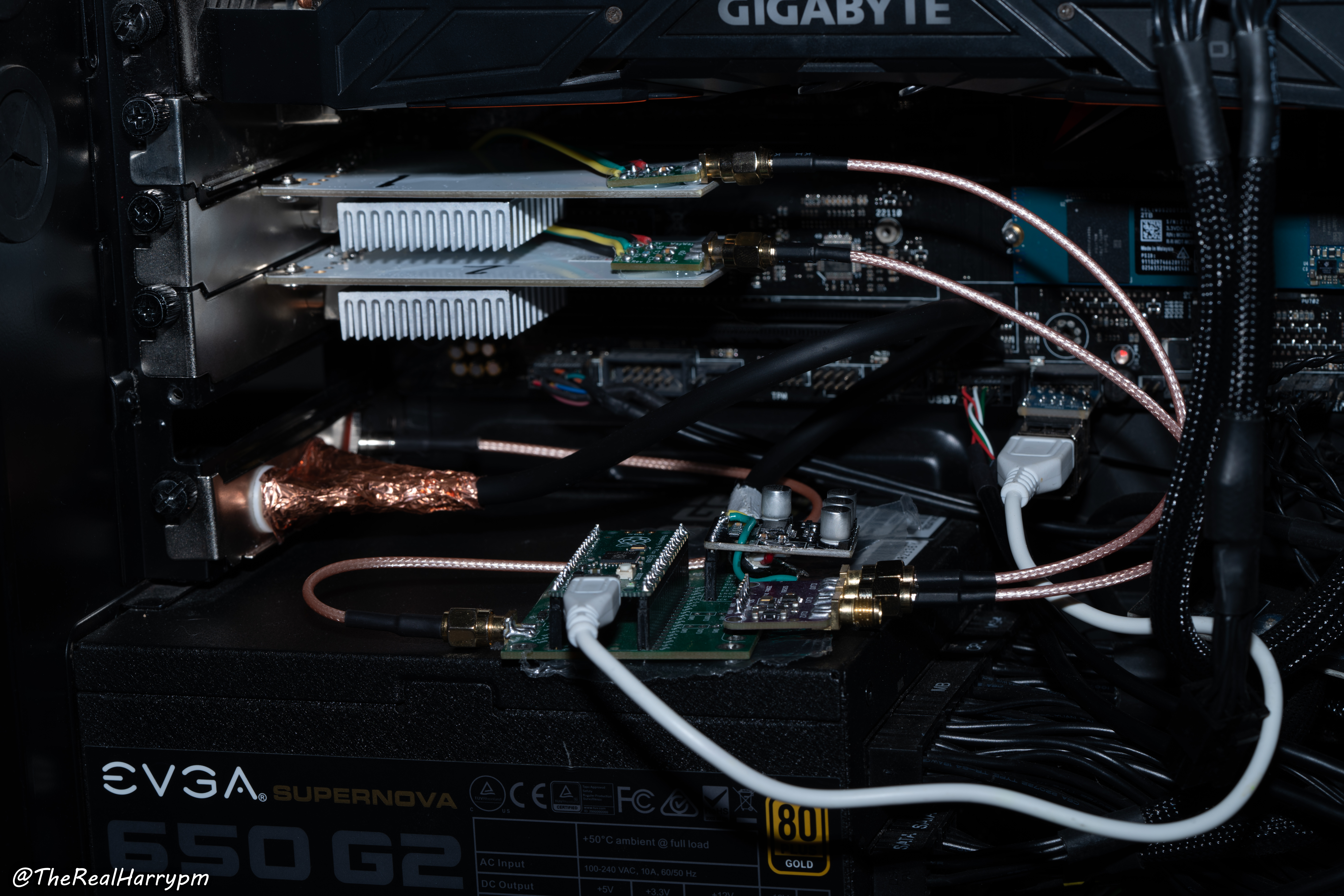

Video RF + HiFi RF + Baseband Audio is all captured in sync with the CX Card Clockgen Mod workflow today very turnkey, with more capture hardware in the works such as the MISRC.

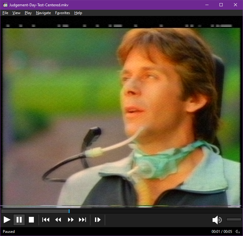

PAL Tape - IMX 720x608 export from tbc-video-export after centering in ld-analyse.Last edited by harrypm; 6th Sep 2024 at 10:34. Reason: added context to 4fsc visuals and the last exported image.
