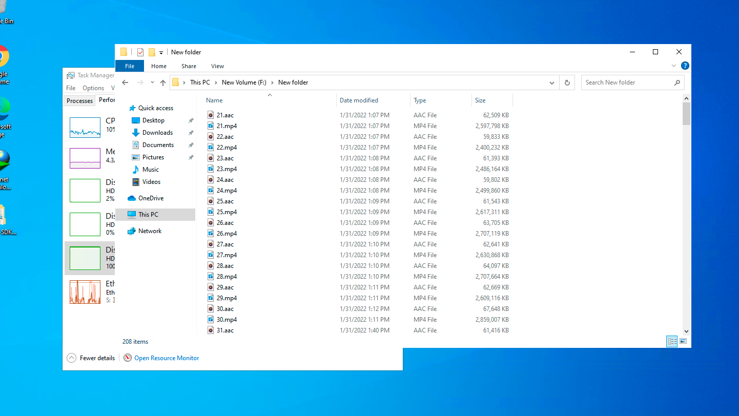

    I want to merge videos and audios with exact same name (1.mp4/1.acc and so on) in batch mode quickly using ffmpeg or any other tools that can do that?
    This screenshot might help: https://forum.videohelp.com/images/imgfiles/lZc0q2f.png
    Can you please help me do that? I don't know bash or powershell so I really appreciate it if you help me with a snippet.
    Thanks again.
