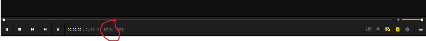

  7. PotPlayer cannot play the files which are shown as "MP4V".
    "MP4V" only means it is some type of MPEG-4 elementary video stream. Many types of video are in the MPEG-4 family.
    MediaInfo reported "mp4v-20" and "V_MPEG4/MS/V3" as the codec IDs for the video that would not play. I looked up those codec IDs. "mp4-20" indicates some type of MPEG-4 part-2 video. DivX and XVid are examples of MPEG-4 part-2 video but there are other proprietary versions. "V_MPEG4/MS/V3" means Microsoft MPEG4 V3 inside a Matroska container file. Microsoft has a decoder for it but I don't know if any non-Microsoft players can use it.
    PotPlayer has a list of supported video codec IDs but yours are not on the list. I can't find a way to add a new type of video to the list. Maybe somebody else has a suggestion for a better way to approach your problem.
