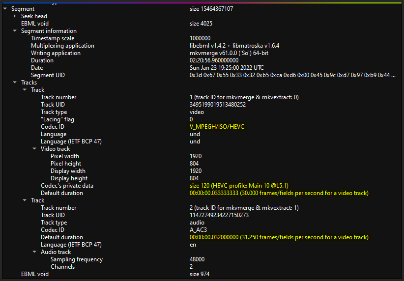

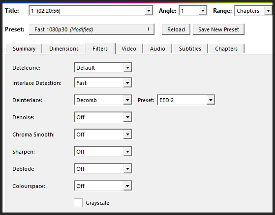

    These are the Handbrake settings I am using, and when you open the file in MKVToolNix, this is what it shows:
    [Attachment 63087 - Click to enlarge]

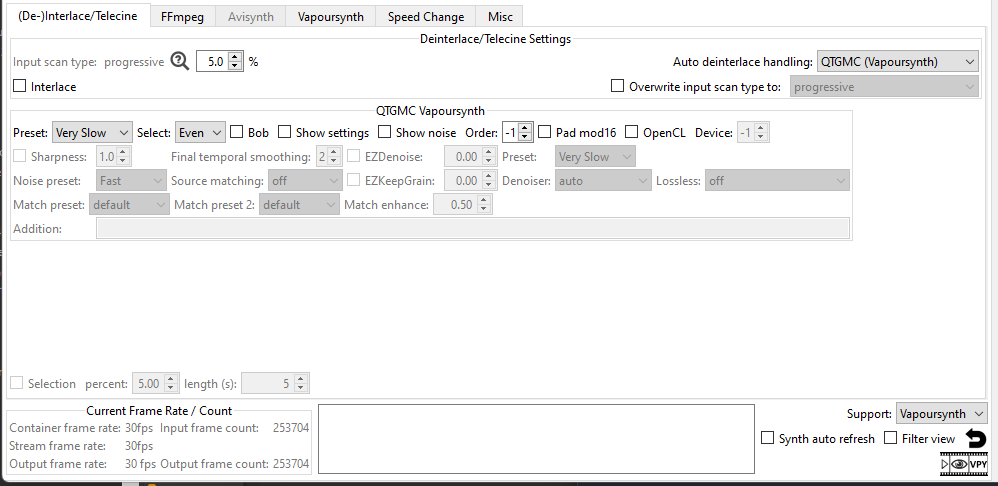

    Going to try out these settings now and see if its better or not

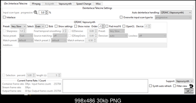

    This is my first time using Hybrid, so this is what I used instead of that screenshot I posted earlier.
    I turned off automatic deinterlace, and then I went into the filter tab, denoise, and checkmark QTGMC with InputType=2 and the Very Slow preset.
    I can't tell what it's at because I am currently not on my computer, but I can check when I get back.

    What kind of settings did you use for QTGMC?
    [Attachment 63103 - Click to enlarge]

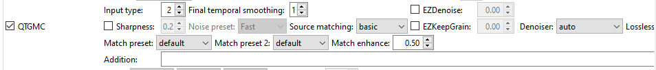

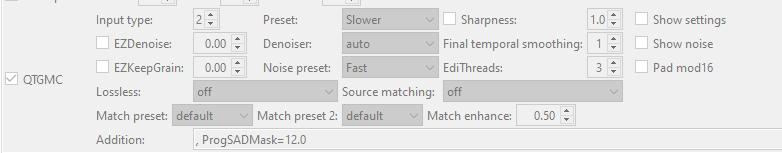

    Is it possible to use ProgSADMask in Hybrid?
    Nevermind, figured out how
    [Attachment 63104 - Click to enlarge]
