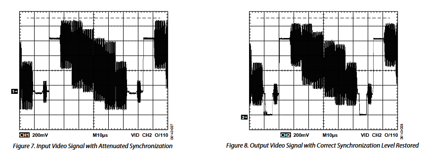

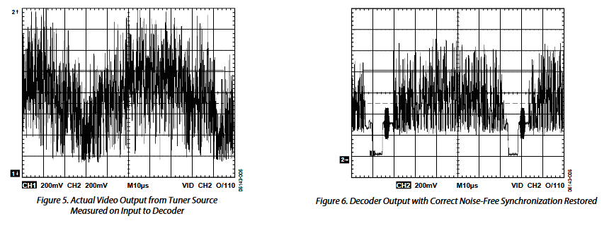

    The following images are from "Adaptive Length Length Tracking" an Analog Devices Application Note, which also appeared in an article for Embedded Audio Visual Journal many years ago. It explains the two types of error "Digital" TBC's correct, for "Broadcast" and "VCR" problems.
    What you need to know is what a "single" scanline of video looks like on a scope plotted Voltage vs Time for the Horizontal problems.
    And then "Zoomed out" so you can see the same thing for Voltage vs Time for the Vertical problems.
    In the first set of images those are "single scan lines", Left to Right.
    The left image is the messy video scanline after its decoded from Broadcast RF, you have to pass it through an Analog or Digital filter to get the "cleaner" signal on the Right.
    After its "cleaned up" you can see the "front porch" or first part of the scan line that indicates to the TV or Capture card.. "Here is the start of line".. its called the horizontal sync pulse, and its the "U" shaped part that dips all the way down almost to zero.
    "Cleaning the Broadcast signal up" so you and the capture card can "see" the start of line is "a type" of Time Base Correction.. it restores "visibility" and makes sure each subsequent line starts "on time" rather than randomly jumping back and forth.. appending "noise" to the front of a line or.. shoving it to the Left and starting to late. Mostly "Broadcast" TBC's can do this with analog circuits.. which have capacitors and age.. and get worse at their job over time. About the year 2002 it became more common to "digitize" the signal and perform the filtering "digitally".. hence Digital TBC's.
    Thats not the only type of Time Base Correction however.. the whole scanline waveform is kind of "floating" and all "relative" so it has to be "right sized" relative to a scale.. and this part is called "clamping" it to Zero.. or making the lowest part of the signal Zero.. and stretching or scaling the rest to "fit" in the Voltage window standard for everything from Black to White... called "Luma".
    The problem with the previous "Clean up" of the Broadcast signal however.. was all that noise might have "erased" the true start of line "sync pulse" that touched zero. Look at the second set of images. The first one has "no" sync pulse. So in a strictly Analog TBC this line would have to be thrown away or replaced with either a duplicate from above or below or from the previous field.. that's called 2D or 3D correction.. but its suboptimal.. what you really want to do is "restore" or (paste) in a fake sync pulse right where you know it should be and keep the line.. you can do that with a Digital TBC.. usually this is done in the Standard Definition Processor (SDP).. but it takes "smarts" and "memory".

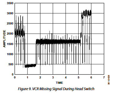

    The Last image is a whole bunch of those horizontal scanlines "squished" up together.
    So much so you may not recognize them.
    When all the horizontal scanlines are played across the screen or capture memory.. for a full field the bottom has a whole new "Vertical" sync pulse.. and it looks very different from the Horizontal sync pulse.. it has to be longer and different enough it is not confused with an ordinary horizontal sync pulse.
    What that image shows.. is that in a VCR.. the twin heads of the drum are sweeping like the Bright Beams of a Light House.. reading each horizontal video line off the video tape.. when the attention of the VCR changes from the A to the B video head.. however briefly.. its not pointed at any tape .. none at all.. its pointed into the bleak darkness of "infinity" in the inside of the VCR box.. where no signal exists.. so the Voltage of the signal "drops" to absolute Zero.. no signal... and this leads to a "spike" to zero.
    The Vertical sync space.. is called the Vertical Blanking or Vertical Retrace region of the Video field.. its is supposed to be "blank" empty.. but its not for a VCR. "Its Full of Spikes!" (And those look a LOT like horizontal sync pulses!! Oh noes!)
    Instead there are these regular "disturbances in the Force" that disrupt things.. and "might".. just "might" be detected as the start of a new line.. prematurely... and spells "Doom".
    Pre-triggered.. the TV or Capture card "thinks" a scanline is starting its merry trip across the screen.. but "Its a FAKE!".. instead what follows is empty black void.. and an ominous dark blacker than black line appears at the top of the screen.. worse the vertical sync is "set" by that Vertical Blanking Interval by a circuit called a PLL - Phase Lock Loop.. and its been fed "lies lies lies".. it thinks the field has started.. but there is no signal.
    Depending on how often the horizontal PLL resamples the "truth" of where the start of line begins this "lie" can persist for some time.. so actual video lines can begin "before" there is actual video signal.. and blackness is appended to the start of the horizontal lines.. and we get "top curl".. gradually.. the PLL's start to recover.. and pull back the night.. restoring the Left edge of the video image to its proper position.. until the next field starts the Top Curl lie all over again.
