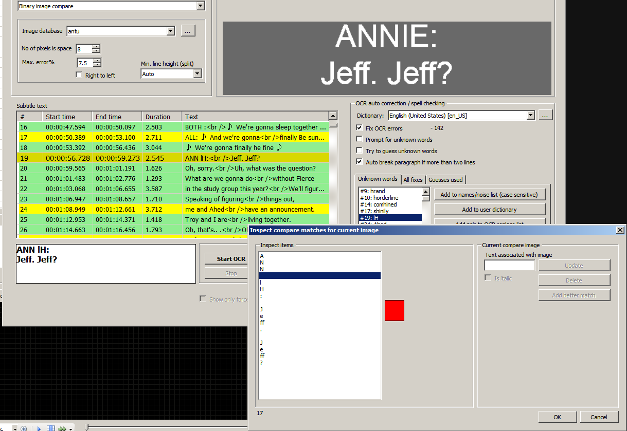

  1. I using "subtitle edit" app to convert PGS to srt. in this example there is a word "ANNIE"
    but app read it as "ANN IH". in inspect compare matches option how can i remove the space between "ANN" and "lH". any help please?

    1) "Prompt for unknown words" should be checked when doing binary comparison or nOCR.
    2) Increase "No pixels is space" till you don't get any false spaces.
  3. increase pixels space worked fine. but other few word making trouble.
    anyway what is the difference between binary comparison or nOCR?
