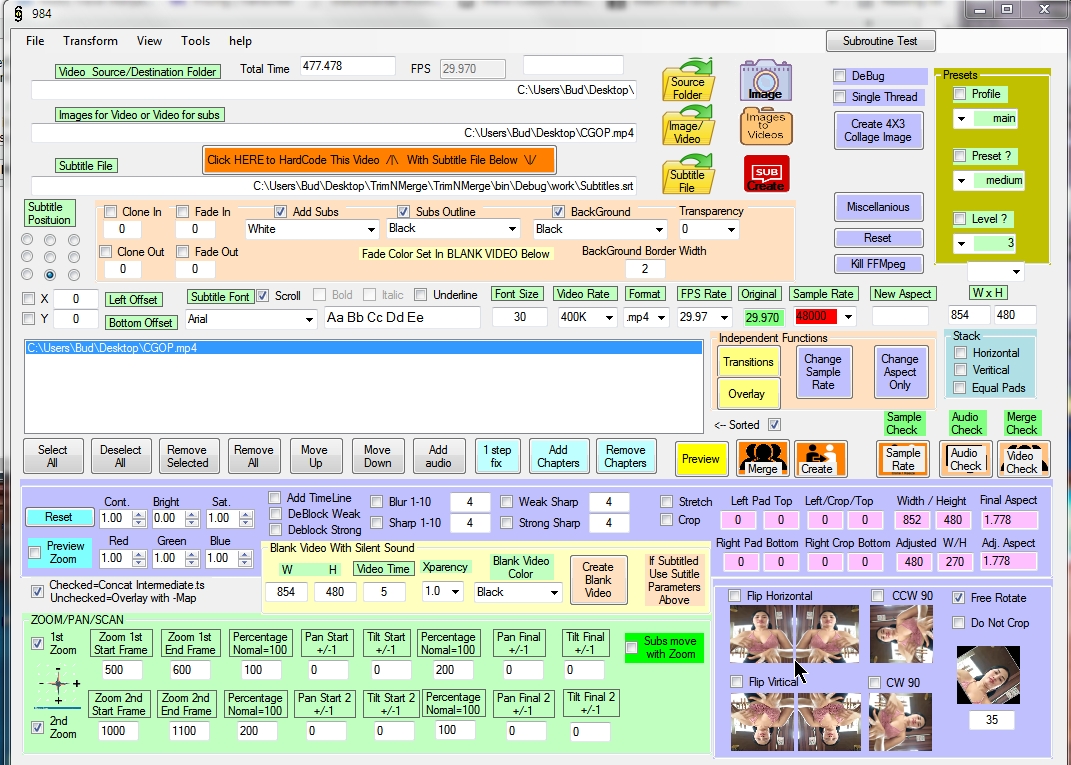

    Let me explain... I have written (work in progress) for a frame accurate cut and merge progream that recodes only what it needs. The also does most everything I need or could want for that matter. The problem is making all functions work as one script, I find it is much better if I create a video file and run it through avisynth for some functions such as stack, zoom, stretch a resolution (e.g. Crop and rescale to original size) as well as others. It would be nice if it is possible to edit the video and send it directly to Avisynth instead of creating an intermediate video file.
    It's not a big effort to create the video and then create the final from it with avisynth. Just thought it would cut my code and work area down. Right now everything works as planned except free rotate and zoom.

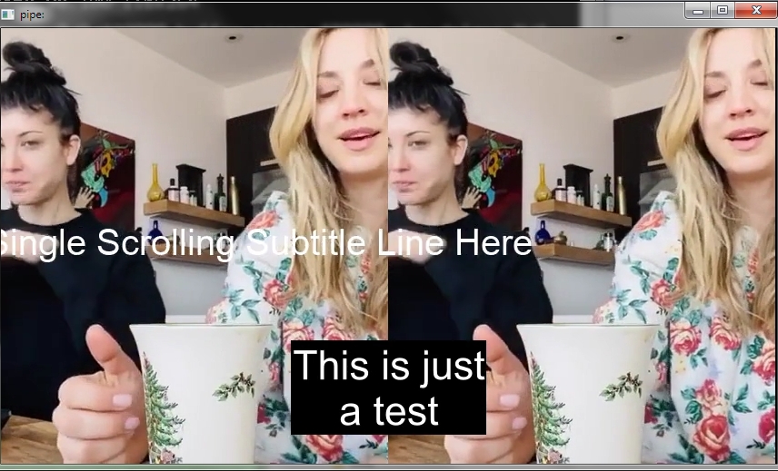

    For instance... I have a video that has 2 segments, the first which has been squashed vertically. I cut the frst segment losslessly and send it to the editing portion where it crops, stretches ,adjusts brightness, contrast, adds subs, and scrolling text and more, it works. If I add free rotate avs script to the ffmpeg, it causes errors such as parsing not seen by either sscript by itself. I just thought I might have better results if I used:
    av=somesourcedecoder(ffmpeg script)
    [Attachment 63016 - Click to enlarge]
    [Attachment 63017 - Click to enlarge]
    insteads of
    ffmpeg -i file.avs.
