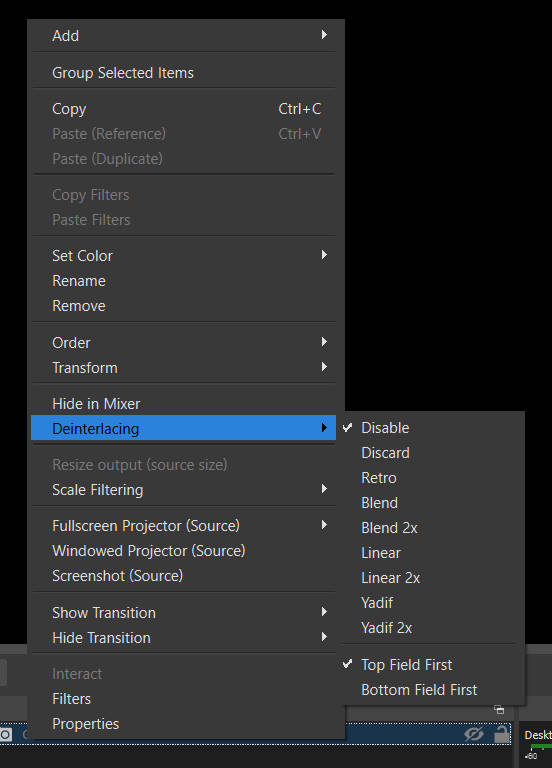

    I have a device that takes 1080p30 video and sends it over component as 1080i60. I'm recording with a Blackmagic Intensity Pro 4K using OBS which gives the options: Retro, Blend, Blend 2x, Linear, Linear 2x, Yadif, Yadif 2x. I would prefer to record the interlaced video and then let the player software deinterlace, but that's only possible with the Blackmagic software which can only do it with uncompressed Quicktime (massive files). So I want to figure out the best de-interlacing method for content that was originally 30p.
    I can't find any explanation of these methods that tells me which is best for recombining lines to get back to 30p. Everything I find on the internet claims all of these methods "interpolates" but I don't think that's accurate. And I don't want interpolation, I just want the two 1920x540 frames combined back to a single 1920x1080 frame.
    Thanks!

  9. Yeah, really. I've used OBS and never had it make interlaced files. But why are you capping uncompressed?
    Jan 2022
    Hawaii
    Because this is the only way to capture the interlaced video in BlackMagic Media Express
    That's why I want to figure out the best deinterlacing method for OBS
    I did some testing with Yadif and it seems good

    The problem is I have two options:
    1) Capture lossless interlaced using the Blackmagic software which is 1 gigabits per second
    2) Capture de-interlaced using OBS which doesn't have the ideal option to simply recombine the video lines without any interpolation or artificial intelligence or anything like that
    But I see the post below suggested Virtualdub so I'll look into that

    When I say 1080i 60fps I'm referring to each of the interlaced halves as a frame. I know some people say 1080i30
    The clip on Youtube was recorded with OBS which doesn't support interlaced recording and also doesn't have real deinterlacing. From the VLC document above, it seems that linear, yadif, and blend just throw away half the data and interpolate between lines. I don't know what retro does

    I think for deinterlacing with FFMPEG, BWDIF may be the best option. I tried it on an uncompressed clip from Blackmagic Media Express and it came out looking really nice with 60 frames https://ffmpeg.org/ffmpeg-filters.html#bwdif
    From that description it seems smart enough to adapt to interlaced vs progressive content and the render rate is 1/2 real time with my 8 core CPU, so it must be doing some advanced stuff
    I guess if it were an option in OBS it would be too slow, so maybe Yadif 2X is a good alternative since unlike Yadif 1x it doesn't just discard data

    bwdif only weaves properly, when there is no motion . There is still some degredation on progressive content (it doesn't field match) . Some types of progressive content are not degraded as noticably, but others will be severely degraded compared to fieldmatching
    Yadif 2x retains the original fields, so you can reconstruct the original progressive frames later if you had to (you discard the interpolated fields that yadif generated , and weave the original ones)
  30. Member
    Jan 2022
    Hawaii
    bwdif is quite a bit faster than yadif for me. There might be some other conversions "underneath the hood" or bottlenecks for you, such as pixel type (RGB30 ?) , or I/O bottlenecks
    Interesting... From the multiple descriptions I've read on various websites, yadif fills in the missing lines, so if you do 2X it does that for every "field" but also keeps the original lines as they are. Is that correct? So to reconstruct the original data you would take the original lines out of the 60p video and then interleave those back together. So I guess it's "lossless" but still easy to record and view.
    Does BWDIF not keep the original lines?
