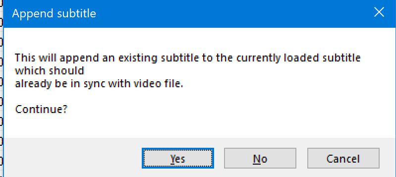

So you have a English .srt subtitle from your BD. I would guess it to have a playtime around 45 min.
Then you have 2 japanese .srt subtitles from Netflix. I would guess they each have a playtime around 22 min. You have sync'd the first of these two subtitle with the English subtitles. You need to point sync the second japanese subtitle using the time codes from the English subtitle. The second japanse subtitle would then have a start time-code around 22 min and an end time around 45.
This is what Subtitle Edit means by "should already be in sync" when you append the second subtitle.
[Attachment 62980 - Click to enlarge] -
