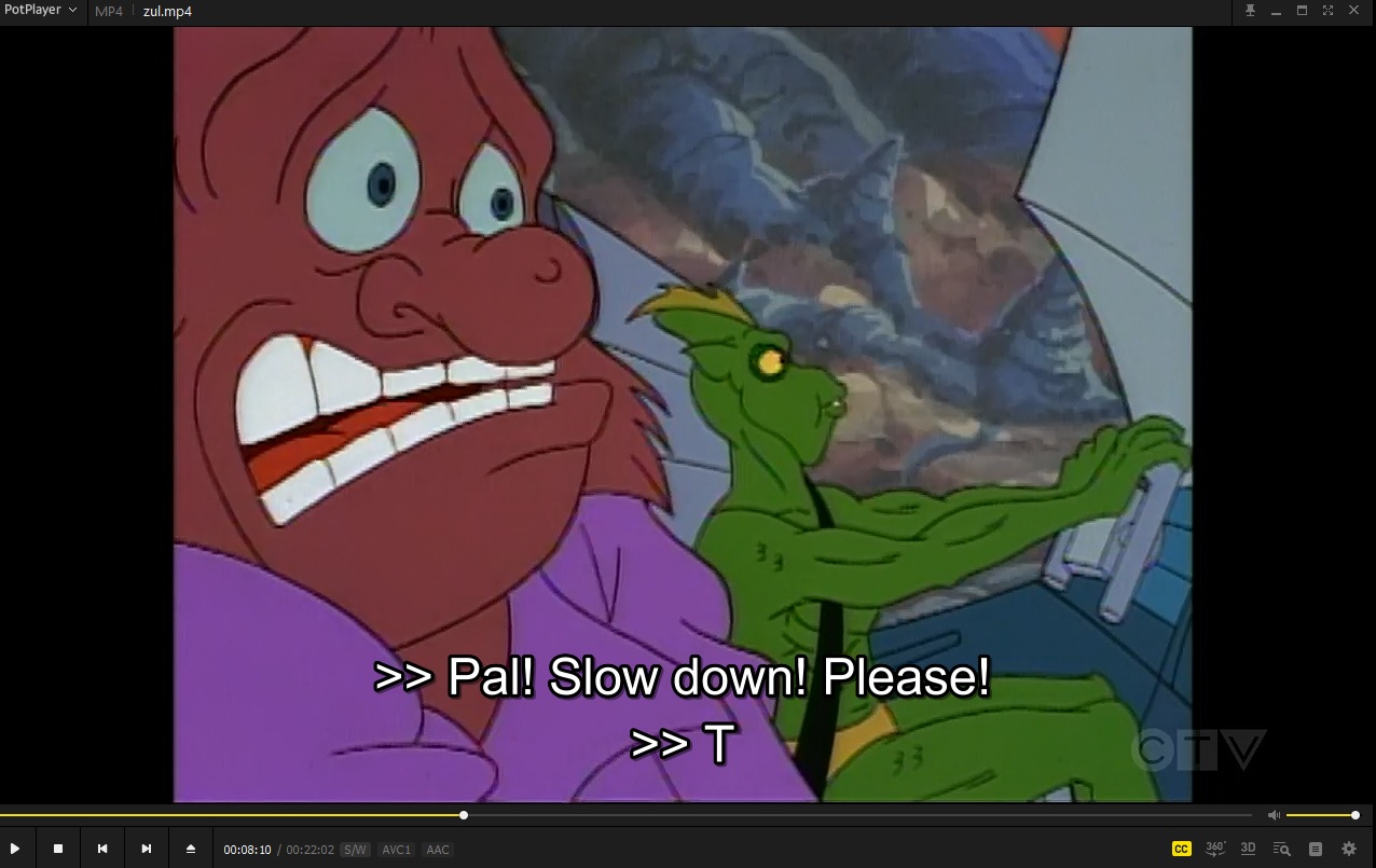

Decryption went fine
[Attachment 62958 - Click to enlarge] -
