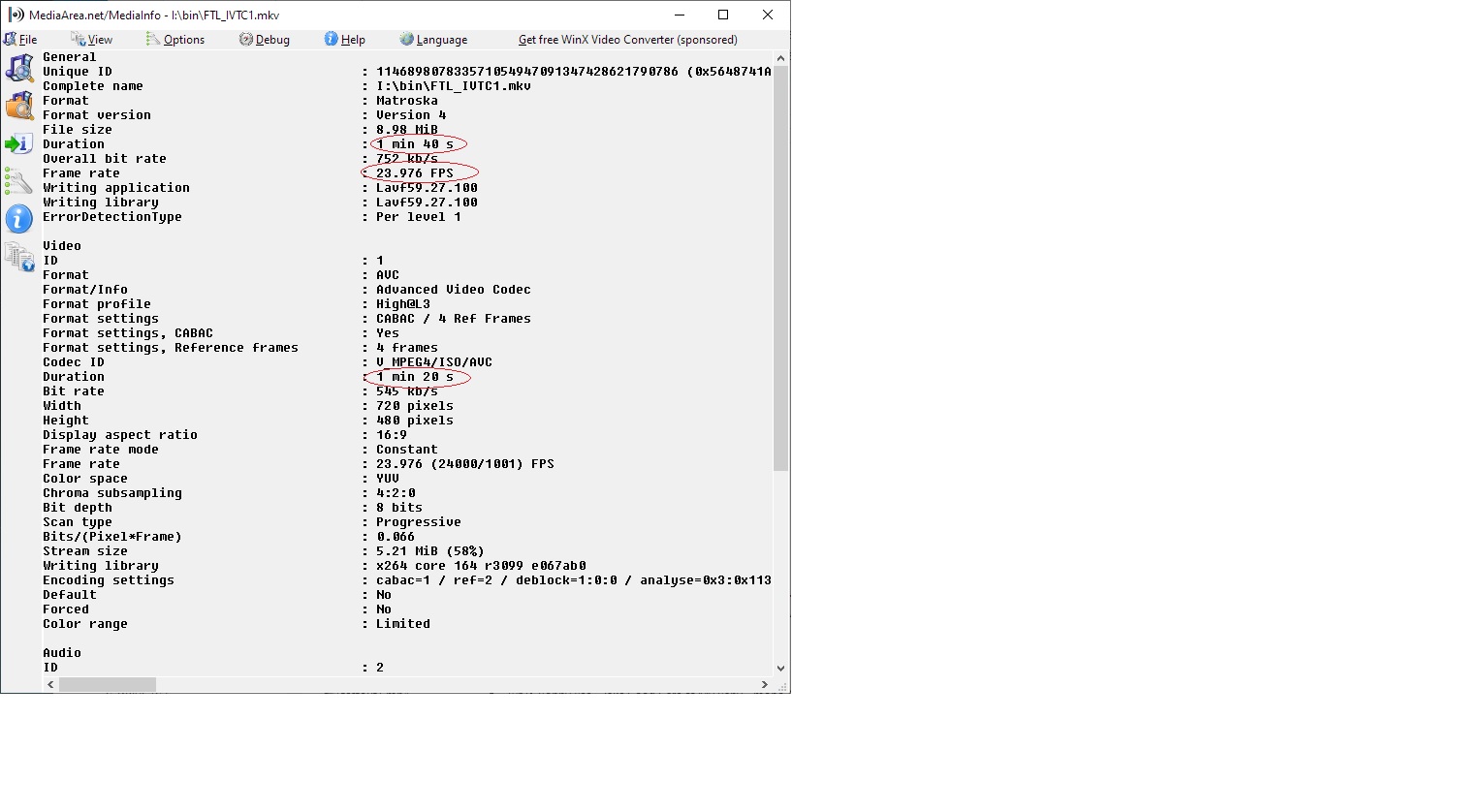

    I ended up with a result like this and didn't know what was going on

  17. Sorry, my mistake. I had been playing around with variations of your command line. It looks like the video I checked with ffprobe was not the one from your original command line but rather an alternate. I went back and rebuilt the video with your command line and checked it. It is fine, with 41 ms durations. Both int the durations column and by subtracting sequential best effort timestamps.
  18. Member
    Mar 2008
    I agree with you, the report is fine, but the file doesn't play properly.
    The video is speeded up, finishes in 1:20 while the audio continues for another 20 seconds
