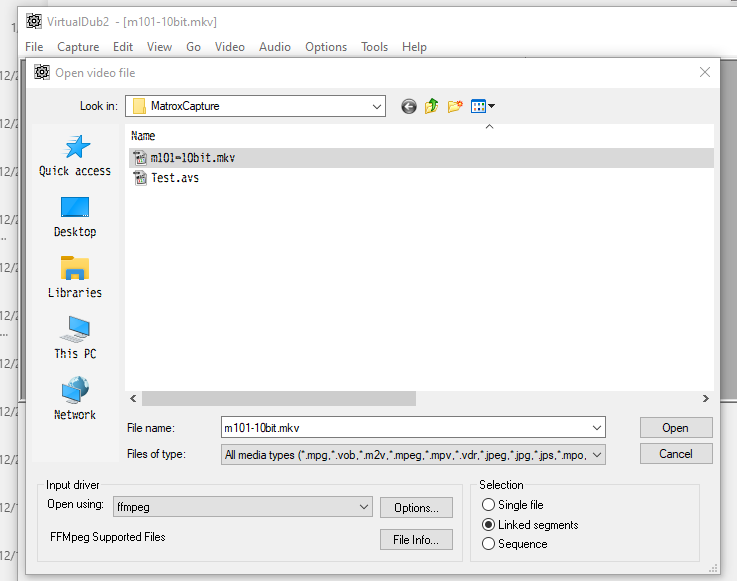

  4. Thank you for the responses. I downloaded the ffmpeg for VirtualDub (https://sourceforge.net/projects/virtualdubffmpeginputplugin/) and installed it. Now ffmpeg appears an an option to open video files. Unfortunately, I still cannot get VirtualDub2 to open the .mkv, either one I did myself with mkvtoolnix, or the one included in the post above. The video is just blank.
    What am I doing wrong?
    [Attachment 62943 - Click to enlarge]
  5. Why you try to use plugin, VDub2 supports *.mkv natively. The ffmpeg mentioned in my case means standalone executable, a console-app, not a plugin.
  6. Originally Posted by buzz1891 View Post
    Sorry, I should have been more clear. When I use ffmpeg command line, I can successfully convert the m101 mkv to 10-bit yuv 422 ffv1. I can then play it fine with MPC-HC. However, for some reason, I still can't open it in VirtualDub2 to actually edit the capture losslessly.
    I still can't edit this 10-bit file natively (i.e. in it's YUV422 form). VirtualDub2 is not opening the video, even with the ffmpeg plugin installed. Unless I there is a different version of the plugin or VDub2 that I am not aware of.

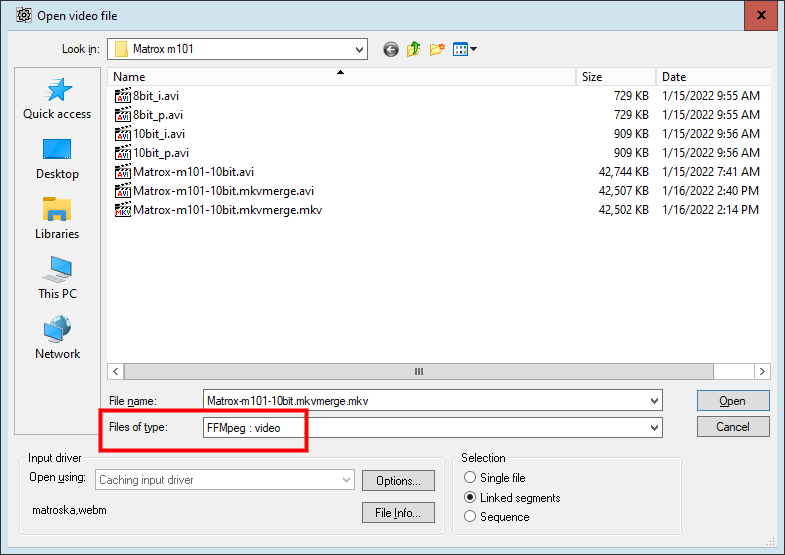

  7. The precedence of source filters in VirtualDub2 can very depending on the system. Force it to use the "ffmpeg : video" filter (included in the program) when you open the m101 mkv file:
    [Attachment 62944 - Click to enlarge]
  8. Originally Posted by jagabo View Post
    I just tried that and same thing - doesn't open.

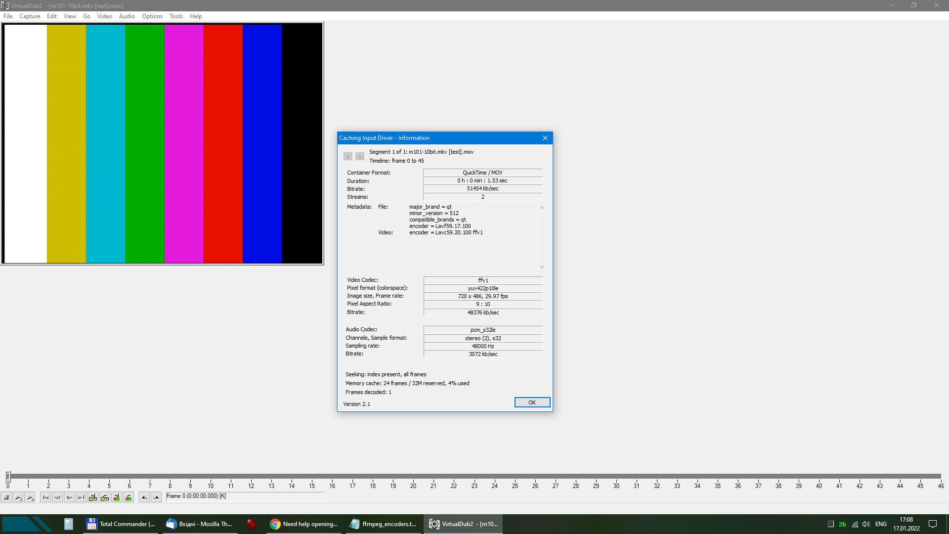

  9. Dunno, what's wrong, but I can encode .mkv to ffv1 .mov and can open the result in the VDub2 directly.
    Versions: ffmpeg 4.4.1 release, VDub2 44282/x64
Name:	m101-ffv1- vdub2.jpg

    Just to be sure -- you should open the video remuxed with mkvtoolnix (mkv), not the original AVI.
