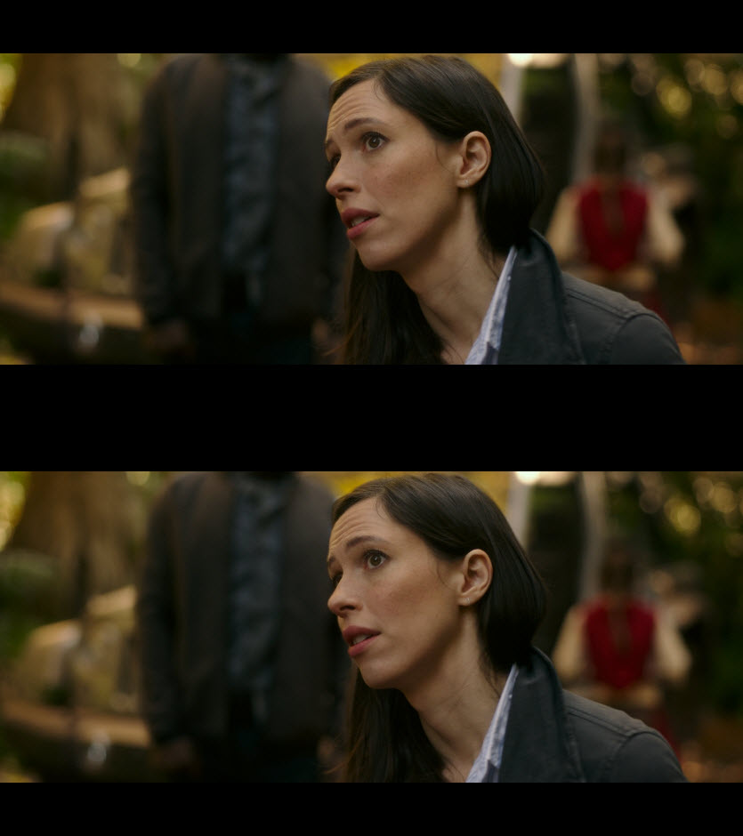

    This one is 1920x2160 and turns into a square video with large black borders (after I reduce it to a playable 1080).
    [Attachment 62884 - Click to enlarge]

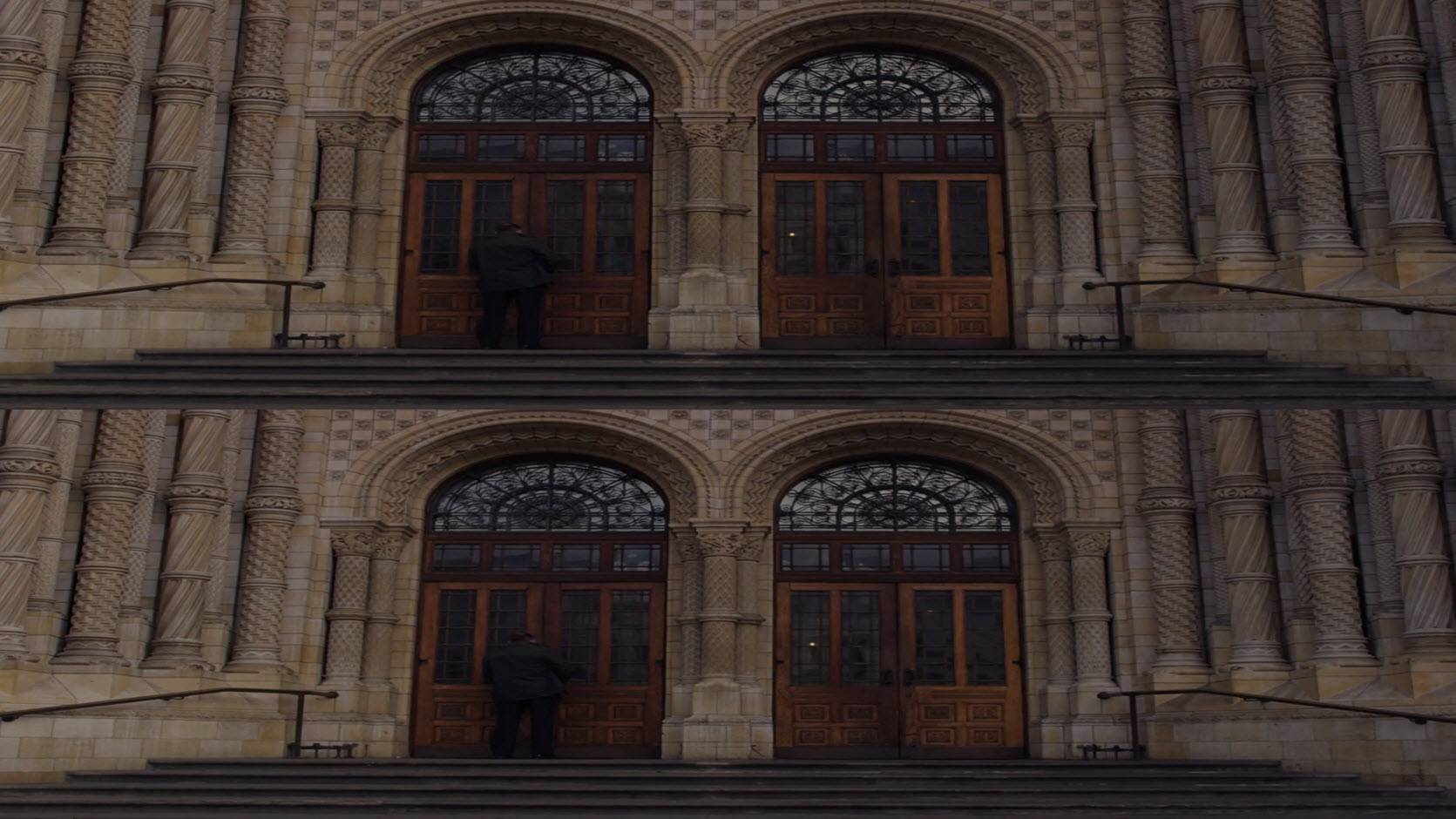

    This one is 1920 x 1080 and runs fine.
    [Attachment 62885 - Click to enlarge]

    OK, 2 things about that "strange" one that I immediately see are diff from the normal TAB...
    Normal TAB is 1/2 height each + full width each, so when combined is full height + full width (note normal SBS is 1/2 width + full height each).
    What you have is full height each + full width each! I would not expect most embedded players to understand this format, and possibly they might not even accept it at all.
    (Software players, OTOH, shouldn't have much trouble with this when told which format it really is).
    *Note many encoders can have issues with full SBS especially, but also sometimes w full TAB as they aren't expecting such big dimensions (shortsightedness on their part).
    The borders are SUPPOSED to be there, however, as this is verly likely not a 16:9 AR title, but rather a 1.85:1 or even more a 2.39:1, etc. So the additional letterboxing is required to maintain the proper final composited AR on fullscreen 3d playback.
    The standard TAB needs no letterboxing, as it is already precomposed for 16:9.
    To fix your strange title(s), simply reduced height to 1/2 and re-encode.

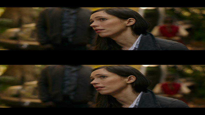

  5. Member Cornucopia's Avatar
    It should look like this:
    [Attachment 62889 - Click to enlarge]
