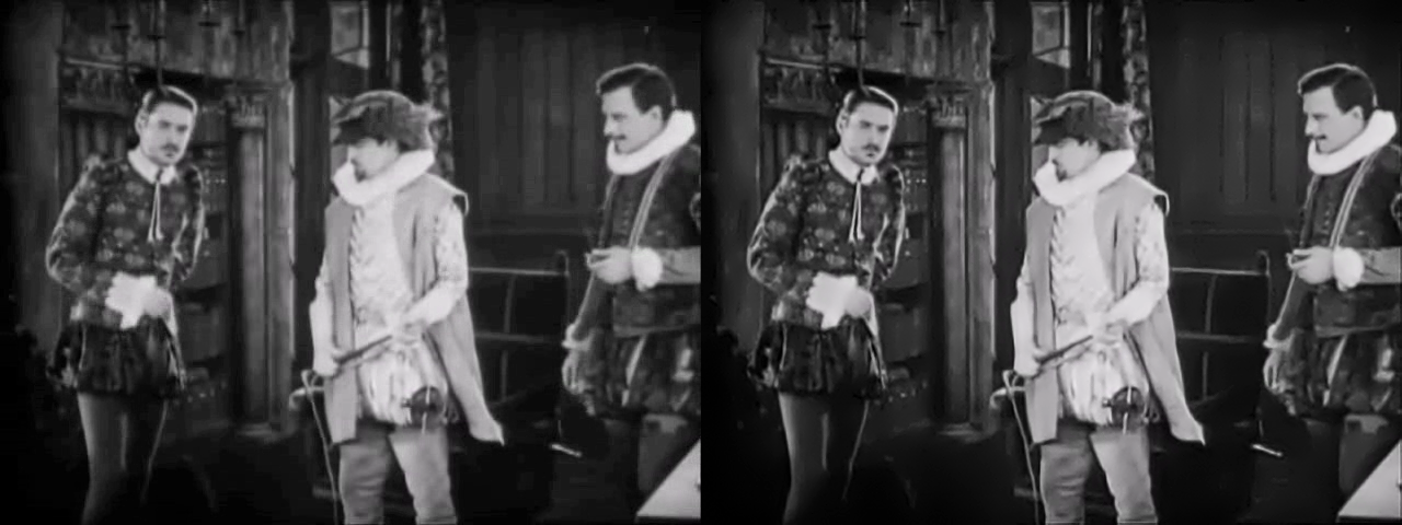

Here's what happen if you use Vapoursynth with BasicVSR++ (<- requires NVIDIA card) + DeSpot + CAS.
Cu Selurusers currently on my ignore list: deadrats, Stears555 -
Avisynth:
Code:v1 = LWLibavVideoSource("CLIP 1 - Sea Hawk.avi", cache=false, prefer_hw=2) v2 = LWLibavVideoSource("CLIP 2 - Sea Hawk.avi", cache=false, prefer_hw=2) v1+v2 src = last deblock_qed(quant1=35, quant2=40) GradFun3(smode=1, thr=2.5, mode=0) ConvertBits(10) SMDegrain (tr=3, thSAD=300, refinemotion=false, contrasharp=false, PreFilter=4, mode=0, truemotion=true, plane=4, chroma=true) BilinearResize(400, 300).CAS(0.95).nnedi3_rpow2(2, cshift="Spline36Resize", fwidth=src.width, fheight=src.height) ConvertBits(8) aWarpSharp2(depth=5) Sharpen(0.5) StackHorizontal(src, last)
