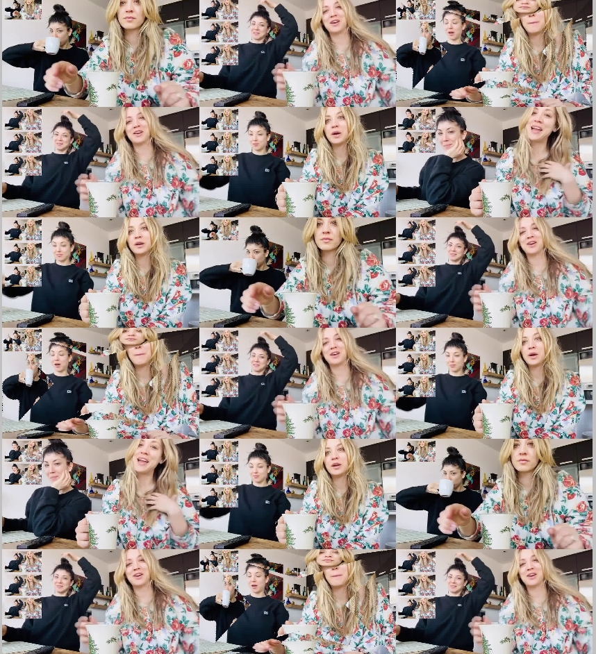

    ffmpeg -i intput.mp4 -vf "thumbnail=37,scale=128:72,tile=6x6" output.jpg
    The thumbnail value should be a little more than the total number of tiles. scale is the size of each thumbnail, tile is the array size, X:Y. From an old FedEx ad:
    [Attachment 62829 - Click to enlarge]
    Some media players have this built in. Like MPCHC. File -> Save Thumbnails.

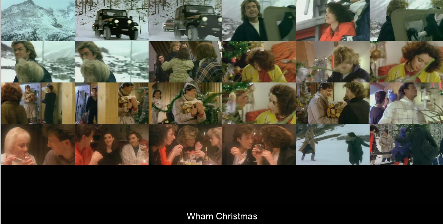

  12. I've come up with a drag/drop batch file that produces an array of specified columns at the original resolution. The number of rows is automatically set to an appropriate number for the length of the video and the chosen interval. It uses ffprobe to get the required stats:

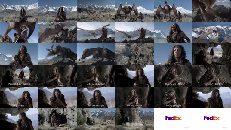

    OK the script below works with MKV as well as mp4. I just added MediaInfoCLI line for Duration. All the other FFPROBE lines work fine. MediaInfo reports duration in Milliseconds or Standard HH:MM:SS as well as HH:MM:SS.mmm but no seconds so I added a step to convert to seconds.
    I also set t_interval lower since the video I used is short and I wanted several rows instead of 1. It works with the original 30 but gives only 1 row.
    Disregard the distortion in some of the frames belows as the test video was created with Picture in Picture as well as transitions every so often. The ugly frames are just showing partial transitioned new video.

    [Attachment 62877 - Click to enlarge]

  27. Next might be to automatically calculate the rows/cols to generate roughly equal values:
    segments = duration / t_interval
    rows = sqrt(segments)
    cols = segments / rows
  28. Member Budman1's Avatar
    Jul 2012
    NORTHWEST ILLINOIS, USA
    There might still be a lot of segments? How about. Limiting to specific size tile that fits and of meaningful size. 3x8 and 4x8 works nice on mine so something like:
    Interval(fps)=total segments /total file length
  29. Member Budman1's Avatar
    Jul 2012
    Scene changes works great, just need to set the change amount. Could be done with manual input or scene changes count.
    Anyway looks like this:
    [Attachment 62890 - Click to enlarge]
  30. Originally Posted by jagabo View Post
    This is great, I am happy to find others which have the technical knowledge to accomplish this interested, I think would be very useful to many people.
    The idea is to produce a single large high quality image file (within reason) uniform in width and length based on video length/frame interval chosen to accompany each video file, this way I can keep reference folder and don't need to open and scan through the video files to exactly find the place I'm looking for.
    I know its sad but I'm brand new to ffmpeg and have attention issues read the instructions a few times now I'm better with UI software then text based, but I will get there especially with the aid of a completed code/script I appreciate you updating on progress, I want to batch produce my entire video collection and clean up and cold store some of the less important large videos.
    Thanks again and hope everyones new year is going well!
