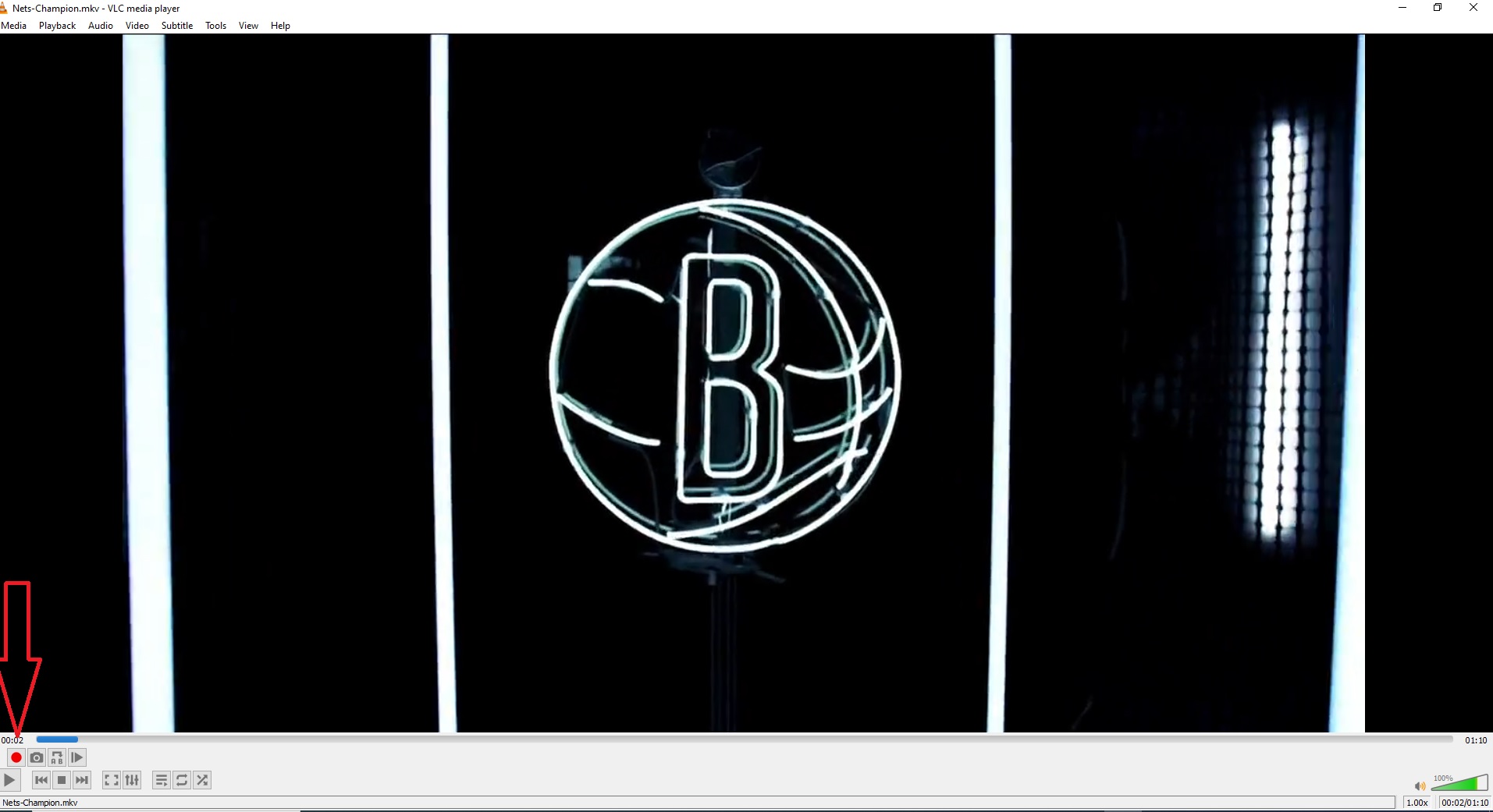

    VLC has a RECORD function.
    By default, the recording button does not appear in the VLC interface. To add the recording button to the interface, open VLC's "View" menu and click "Advanced Controls." The recording button appears on the lower portion of the VLC program interface, between the "Play" button and the time slider. The recording button stays enabled until you click "Advanced Controls" in the "View" menu again, even if you close and restart the program.
    [Attachment 62818 - Click to enlarge]
    If not I would recommend OBS - I use it daily - not easy for a beginner to setup though.

    Thx for the advice, but what exactly this "record" button do? I followed these instruction:
    https://confluence.bethel.edu/display/ITSKB/Recording+a+Network+Stream+with+VLC+Player
    set destination folder, set streaming link, press "record" button and......nothing happens. I noticed i wasn't asked for the name of the file.

    What does it do ? Have a guess ? It records the stream into the C:\Users\your-user-name\Videos directory unless you change it. It default names it with the date/time.
    vlc-record-2021-07-27-20h12m39s-Channel-name (East Server).ts
    You can rename the file afterwards.
    You will see the red button indented if its recording - click it again to halt it.
