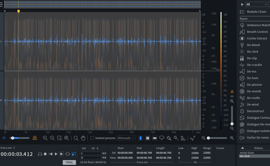

    I have a recording with constant clicks, I guess the uploader set something wrongly when capturing from the VHS. It would be very important to repair it, because this recording is very rare, I assume the master tapes have already been destroyed. How could it be repaired at the highest quality? What is the appropriate software for this purpose? I tried Declick in Goldwave on an Agressive preset, and it is not bad. But I wonder if there would be more professional settings than that?

    Is that how the recording is all the way through? That music? There are very few clicks and their amplitude is quite low.
    It's low enough that I can't hear them when the music is playing
    THis is how it looks in Izotope RX when you save the clicks and discard the music

    Yeah, this is it exactly, what you captured in the flac. But you are kidding that it does not irritate you. When I listen it is very irritating for me with its high pitch. Anyway, this is like that in the whole recording, this type of clicking.

    I'll post the declicked version from on RX later and you can compare it to what you got from Goldwave
    Here's the clip with the above clicks removed.

    None is good, yours have still too much of the high pitch clicks or their remnants for me, the Goldwave version has less clicks, but due to the heavy filtering there are artifacts that are noticeable with good speakers or headphones. But I will stick to Goldwave, because that version at least is acceptable when listened to on low quality speakers, like my laptop's speaker, so at least one way it gives satisfying results. But thank you for checking!
