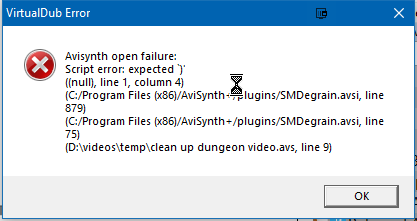

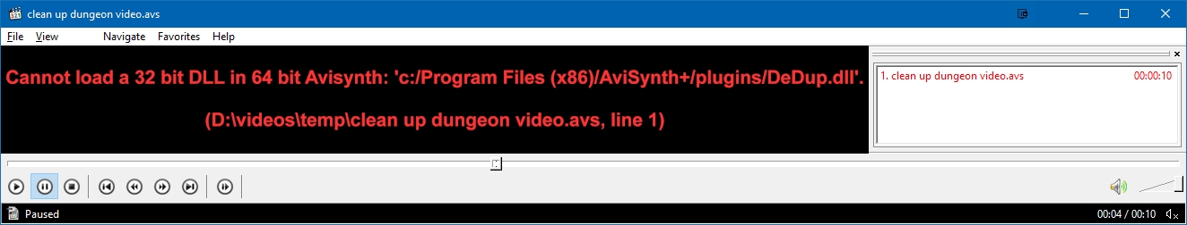

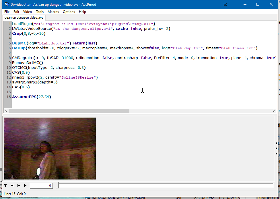

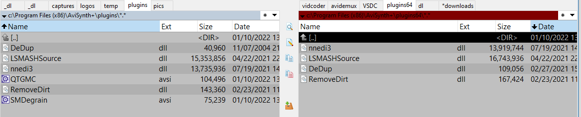

    Next issue... I'm using Avisynth+ 64-bit and I get this when I try to play the script with MPC-HC
    [Attachment 62845 - Click to enlarge]
    Now I'm very sure I went to the Avisynth 64-bit plugins page to get Dedup.dll so I'm stuck at this point.... should I uninstall Avisynth+ and just install the 32-bit version of the original Avisynth?
    AvsP displays a preview just fine
    [Attachment 62846 - Click to enlarge]
    and Virtualdub 1.9.11 does as well
    [Attachment 62847 - Click to enlarge]
    Where am I going wrong?

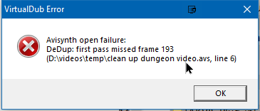

    That makes sense.... I read the dedup documentation and it is a 2 pass thing..... I've never ran a Avisynth script that did anything 2 pass so that is new to me... the extent of my Avisynth experience was ripping DVDs back in the 00s (which I learned here BTW)

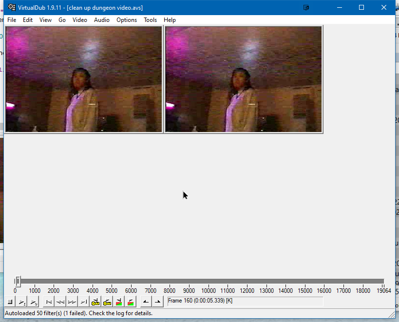

    so I returned it back to it's commented state, loaded the script and Vdub spits out this....
    [Attachment 62853 - Click to enlarge]
    this is my script in it's current state
    LoadPlugin("c:\Program Files (x86)\AviSynth+\plugins\DeDup.dll")
    LWLibavVideoSource("at_the_dungeon.clips.avi", cache=false, prefer_hw=2)
    Crop(0,8,-0,-16)
    #DupMC(log="blah.dup.txt") return(last)
    DeDup(threshold=5.0, trigger2=22, maxcopies=4, maxdrops=4, show=false, log="blah.dup.txt", times="blah.times.txt")
    SMDegrain (tr=9, thSAD=31000, refinemotion=false, contrasharp=false, PreFilter=4, mode=0, truemotion=true, plane=4, chroma=true)
    RemoveDirtMC()
    QTGMC(InputType=2, sharpness=0.3)
    CAS(0.5)
    nnedi3_rpow2(2, cshift="Spline36Resize")
    aWarpSharp2(depth=5)
    CAS(0.5)
    AssumeFPS(27.54)
  12. With the first pass you need to run the script with DupMC line enabled (note that the line includes "return(last)" so the rest of the script isn't processed in this pass). The first pass needs to be run for every frame of the entire video. I usually use VirtualDub's File -> Run Video Analysis Pass (I don't know if avspmod has a similar function). VirtualDub will read every frame of the video sequentially as fast as possible -- DupMC will write to the stats file for each frame as it's processed. Then for the second pass you should disable the DupMC line to let the rest of the script be processed. The stats file will then be used by DeDup().
    So the first pass should look like:
    Crop(0,8,-0,-16)
    RemoveDirtMC()
    CAS(0.5)
    CAS(0.5)
    AssumeFPS(27.54)
    The second pass should look like it does in your post.
    You can get the 64 bit version of DeDup here:
    http://avisynth.nl/index.php/DeDup
    The 64 bit version is in the \src\x64\Release\ folder.

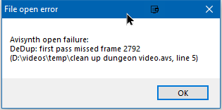

    Ok here's the files after the 1st pass
    [Attachment 62863 - Click to enlarge]
    when I loaded it in Virtualdub, after commenting out DupMC, I got this...
    [Attachment 62864 - Click to enlarge]

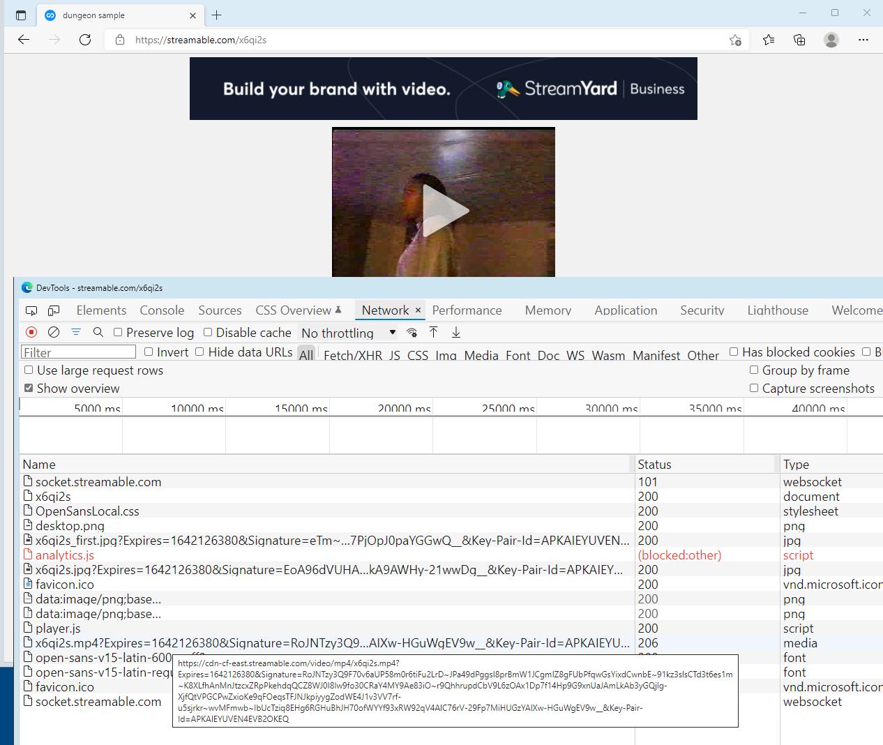

  14. How are you people able to download that "streamable" video?
  15. I got the link from a browser's Developer Tools (press F12), Network tab. I don't know how long it will last:
    https://cdn-cf-east.streamable.com/video/mp4/x6qi2s.mp4?Expires=1642112820&Signature=A...YUVEN4EVB2OKEQ
    Noisy.mp4 in post #2 is that file.
  16. Thanks for the link. That worked. Don't know how you got it.
    My results were somewhat similar, but when I found out that there are random repeated frames, it was more than I wanted to get into.
  17. Originally Posted by johnmeyer View Post
    This one is simple. Start a web browser. Press F12 to bring up its Developer Tools. Switch to the Network tab. Back at the browser navigate to the web site. Back at DT look for the mp4 link.
    [Attachment 62866 - Click to enlarge]
  18. Wow, I tried that and it did actually work. Even if I'd thought to hunt through the HTML source, I would have ignored that URL because it's so long. I'll try to remember this for the next time.
    Thanks!

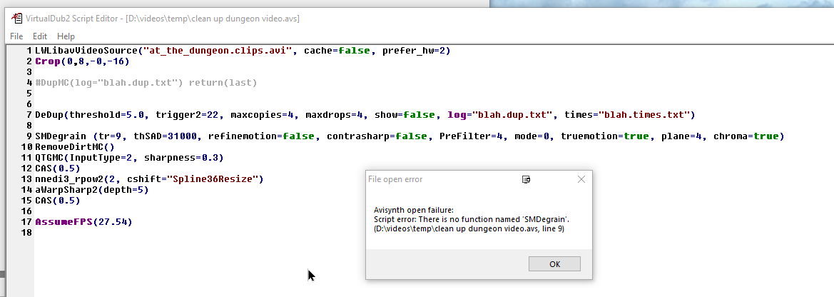

    This is where I'm stuck....
  20. How did you run the first pass? Don't use a "play" function. A player may skip frames when it finds the video processing is falling behind the audio. It's also slower than necessary as it plays the video in real time (an hour long video will take an hour to play). Use VirtualDub's File -> Run Video Analysis Pass. That will be sure to process every single frame of video as quickly as possible (an hour long video may take only a minute to process).
    Make sure that the name of the stats file is the same for both passes.
    Also, it probably won't hurt to delete the stats file (from a previous run) before starting the first pass. It's not supposed to be necessary but but I usually do so.
  21. 1) Delete blah.dup.txt - it might be this has other things written in your various tests and is corrupted and frames no longer match. ie. Start over.
    2) Comment out everything below the DupMC line, save the script, run analysis pass. This is your analysis pass
    3) Comment out the DupMC line, uncomment out everything below the DupMC line, comment out the DupMC line, save the script. Reload the new script. This is your 2nd pass
    To block comment out something you can use /* and */ to enclose the section that is "disabled"

    I tried to follow what u said earlier. Loaded the script(without the comment) in virtualdub and did the Video Analysis Pass which generated the 'blah' files. Next, I commented the DupMC line, and reloaded the script in virtualdub and then I got the error message.
    Would it matter what version of virtualdub I use since I have 1.9.11 and 2 available? I notice vdub2 has a script editor.....
    Block comment out everything below DupMC (1st pass)
    Crop(0,8,-0,-16)
    RemoveDirtMC()
    CAS(0.5)
    CAS(0.5)
    AssumeFPS(27.54)
    Unblock , comment out DupMC, this is your 2nd pass
    Crop(0,8,-0,-16)
    RemoveDirtMC()
    CAS(0.5)
    CAS(0.5)
    AssumeFPS(27.54)
    Or, in avspmod, you can marquee select lines (hold left click, drag a box), and push ctrl+Q to block/unblock the selected toggling of lines
    OK.. I've done that with Virtualdub 1.9.11 and I'm getting an error with SMDegrain.avsi
    [Attachment 62894 - Click to enlarge]
    I tried to download it from the Avisynth page (http://avisynth.nl/index.php/SMDegrain) but it 404'd, so I duckduckgo'd and found this one (https://github.com/avisynth-repository/SMDegrain/blob/master/SMDegrain.avsi)
    Did I place it in the right plugins folder?
    [Attachment 62898 - Click to enlarge]
    Because when I attempt to load it in Virtualdub2, I get this error...
    [Attachment 62897 - Click to enlarge]
    And thank u all for being patient with me lol
  23. No function named SMDegrain means SMDegrain.avsi was not imported
    I think you might be mixing up x86, x64 versions. Is vdub2 x64 or x86 ?
    If it's x64 you're missing SMDegrain.avsi from the plugins64 directory, you can copy it there
    Alternatively, you can also explicitly Import .avs or .avsi in your script
    eg.
    Import("PATH\SMDegrain.avsi")
    And manually load most missing .dll's if you're missing any, from a specified location
    eg.
    LoadPlugin("PATH\somedll.dll")

    so any idea what this error is about?
    It comes up whether I import SMDegrain implicitly in the script or if I don't....
    line 879 of SMDegrain
    IsAvsNeo ? eval(MidStr(VersionString(),20,4)) : IsAvsPlus ? eval(MidStr(VersionString(),17,4)) : 0
    line 75 of SMDegrain
    sisphbd = AvsPlusVersionNumber > 2294
    line 9 of the script is when SMDegrain function is called

    Ok So I think I installed all the dependencies and I get an error from Vdub1 about no function named RemoveDirtMC
    here's my AVSInfo currently
