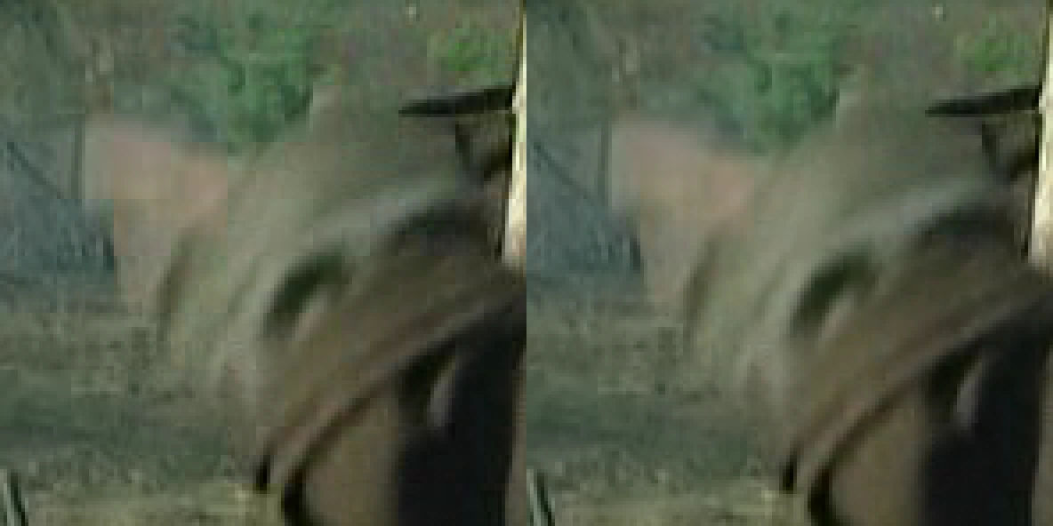

    I'm having some trouble encoding a .vob file from a dvd, to x264 with handbrake.
    However, no matter what settings I choose, I''m getting ugly blocking artifacts. Even with no filters and 18 CRF, they are present in some scenes.
    Here's an example, as it's more visible in motion, while in the source the blocking is nowhere near as noticeable.
    The weirdest thing is that, if I turn the deblocking filter on, no matter the size, instead of reducing the blocking, the image instead gets more blocky. If I increase the strenght, instead of smearing, blocks get more visible instead.
    Where I notice the most is in the face of the dude on the left. Terrible blocking shimering.
    I annex the cropped excerpt from the original, in case anyone wants to try encoding it without making it significantly worse than the original. Improving it in any way would be even better of course.
    Notice the horizontal line under the dude nose, and on top of the woman's nose. They are not present in the original, at least they're not so jarring.
    [Attachment 62747 - Click to enlarge]

    • It's in the source
    • It's not blocking (MPEG compression blocks), it's more like deinterlacing artefacts. Needs special treatment in AviSynth.
    May 2019
    Portugal
    Thank you for your input. It is indeed in the source, albeit not as pronounced. I found it weird that handbrake would intensify these artifacts though.
    It's been a few years since I've used AviSynth, I'll have to brush up my skills.
    Any tips on modern filters or procedures for it that might apply to this case?

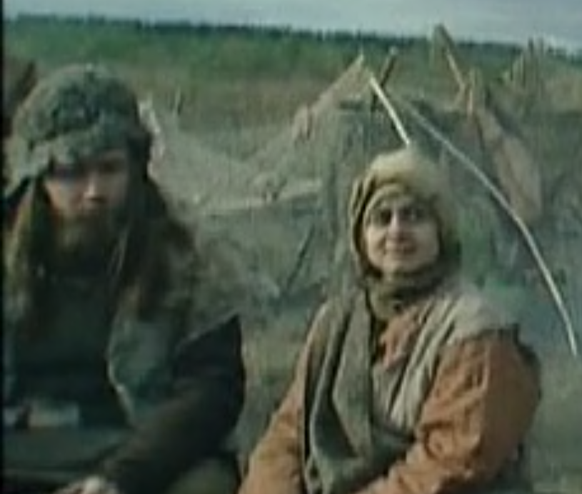

  5. The guys face doesn't have blocks that a deblocking filter is designed to fix. Fhe the effect of a deblocking filter look at the hand of the guy on the right as it's moving around quickly:
    [Attachment 62748 - Click to enlarge]
    You want more of an antialiasing filter and noise noise reduction.

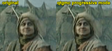

  6. Temporal aliasing in the source (deinterlacing artifacts as Skiller mentioned, and compounded by noise issues as jagabo mentioned).
    Those artifacts in the source predispose you to even more artifacts when you use lossy encoding
    I would use QTGMC in progressive mode , because it smooths over the shimmering and also denoises
    Here is gif comparision prior to encoding, illustrating the temporal aliasing artifacts (shimmering)
    [Attachment 62749 - Click to enlarge]
    qtgmc(preset="very slow", inputtype=1, border=true, sharpness=0.3)
