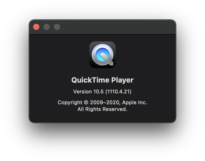

  24. Originally Posted by DB83 View Post
    And is the Mac version any more recent ?
    7 years more recent. You're talking about version 7. I have version 10.
    Quicktime is a core MacOS component and is actively developed.
    Well if you do not want assistance.......
    I guess I'm looking for a different kind.

    No note about version 10 (other than an OS)

Name:	Screen Shot 2022-01-09 at 01.45.13.png
