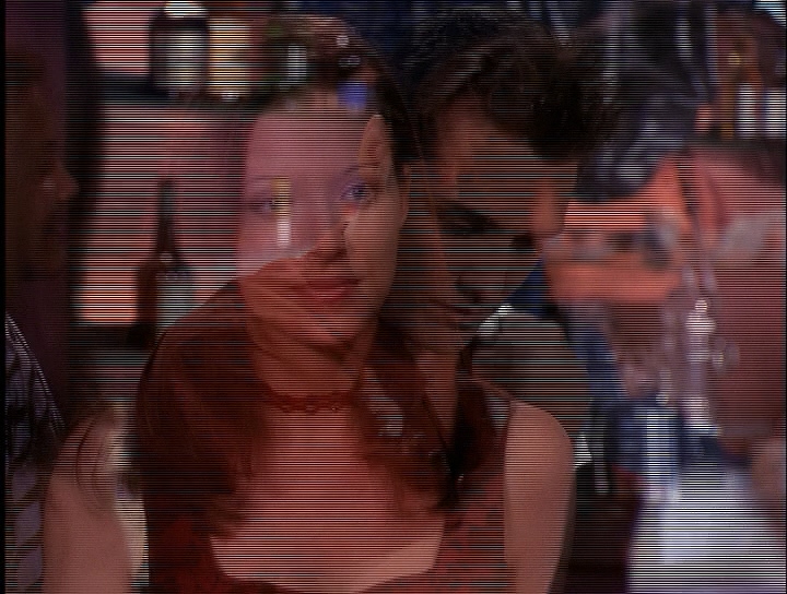

    Here's a sample
    https://we.tl/t-6grhtALIuA
    God knows what they did to this, there is some disturbing interlacing
    https://forum.videohelp.com/images/imgfiles/Fr1yXJJ.jpg
    I don't see HD being mentioned anywhere on P+
    Yes, i also noticed about the disturbing interlacing but the quality is better than the DVDs or any other version i can find anywhere else.
