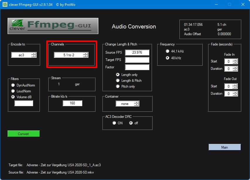

  19. Use clever Ffmpeg-GUI.
    Load your video, click main, click convert audio, select your ac3 5.1 track, click continue, set channels to the special 5.1 to 2 setting (it's an improved downmix algorythm), click convert, done.
    [Attachment 62719 - Click to enlarge]
