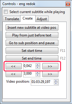

    When editing the start- and endpoints, and timings are critical, a good way is using the buttons in the "Create" tab. Take a look at the screenshot.
    [Attachment 62692 - Click to enlarge]
    Note the buttons and values in the red area. The value represents a step backwards or forwards in time when hitting one of the adjacent buttons. I set this to (about) one frametime. In this example, for working with 23,976 fps I set it to 42ms. This allows me to take steps frame by frame. When fine-tuning, I use the buttons to go to the exact frame where I want to start/stop and then use either F11 or F12 (or 'Set start time' and 'Set end time' buttons).

    Select the fixes you want, deselect the others. Hit "next", then "apply selected fixes" on the next screen.
    If it did what you wanted, save it as a new file -
    file/save as
    subrip - (SRT) (for example)
