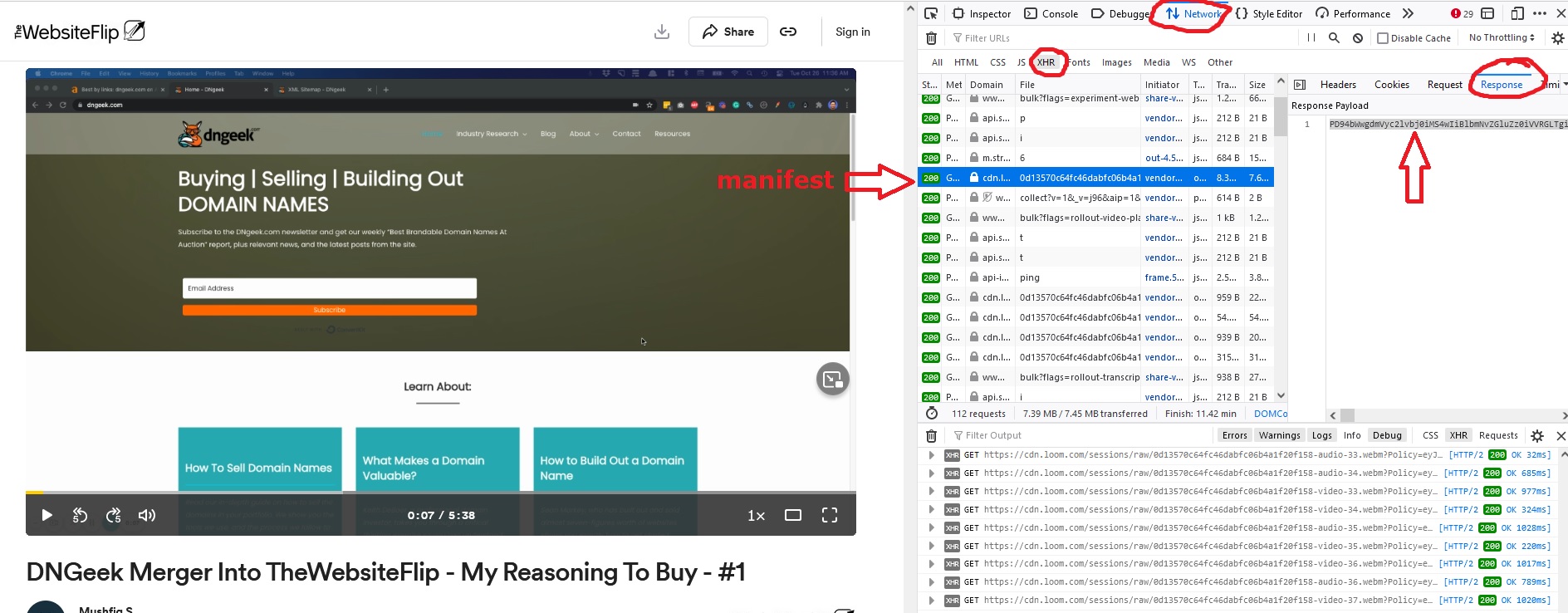

  4. Right there is a manifest.mpd but its base64 encoded
    [Attachment 62650 - Click to enlarge]
    When decoded gives the mpd:
