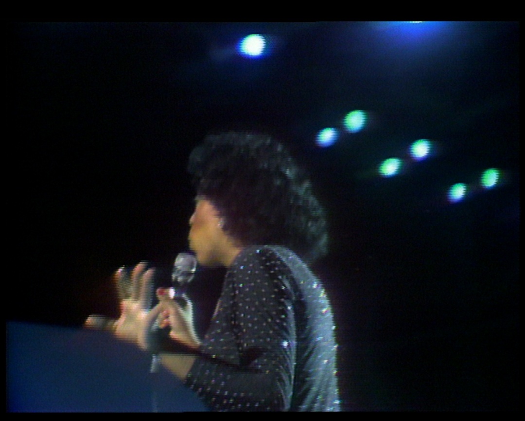

    I'm having this problem with awful chroma trail and ghosting I'm video �� ��
    Specially when viewed in bx player and vlc but result seems to vary depending on device or player...I'm wondering if it's in the source.
    Can anyone help?Image
    [Attachment 62612 - Click to enlarge]

    A still picture really does not tell the complete story.
    Upload a sample clip as an attachment (not a youtube reencode)

    First, I did not download a whopping 3.35 GB. A smaller sample would be appreciated.
    Anyways, looking at your sceenshot this is a live perfomance and was shot on electronic video cameras (not on film) in the 70's or 80's. Therefore I suspect you might be talking about a characteristic of these video cameras we just came across a few days ago in another thread. And in that case it would be normal and is due to the technology of the cameras used, which is very different from basically any electronic camera made after the early 90's.

    I'm sorry guys. Here is a sample spot. When she turns towards the end you can see trails of red as she moves away from camera. This happens in the original unedited too.

    Here is another section, above the lady's head on right there is a ghost trail. If you can splice the original interlaced copy from first sample I would appreciate.
  9. Reencoding as progressive and not deinterlacing makes the samples useless. Attached a small part from the original as FFV1, around second 8 on can see chroma ghosting/trains at the hand and tons of trails on the dress,... but I doubt you can really get rid of both of them without lots of work.

    Germany
