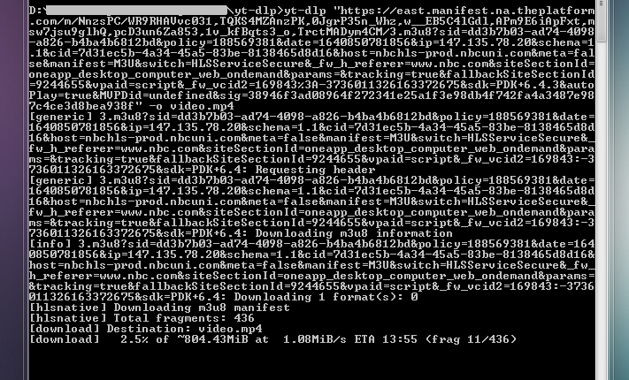

You need to put quotation marks around the the URL. The windows command line is interpreting all the &,= signs, etc as separators.
After putting "".

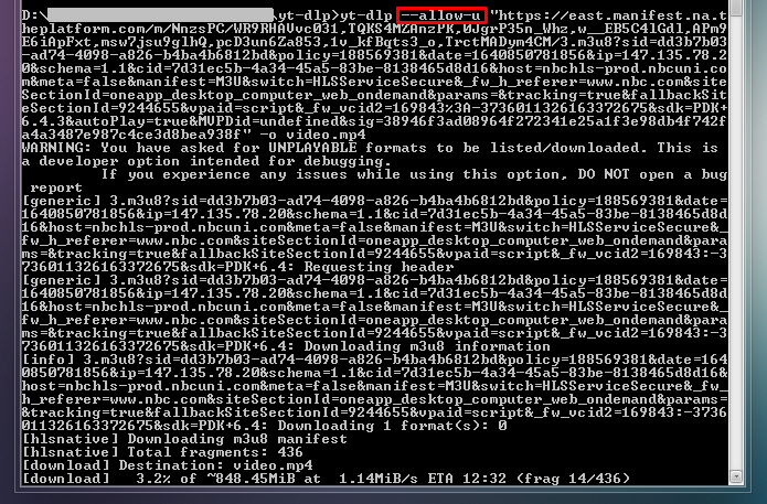

Code:yt-dlp.exe --allow-u "https://east.manifest.na.theplatform.com/m/NnzsPC/ao79kuQfzrjS,Vz_CZkKUD1_5,MOVKzYyCM64w,APw6a3NGoOfJ,mM6GSHu0dTkn,_mQOJCQ_56MN,Aw4LNgPEWNMk,VskPm8kbEa0j,urLbscjFnvMc/1.m3u8?sid=0fb430c2-d373-4911-aaf3-2e315a6769aa&policy=188569381&date=1640819802451&ip=69.247.146.33&schema=1.1&cid=17aa81b2-062d-423a-9045-cf60b7dd2bc2&host=nbchls-prod.nbcuni.com&meta=false&manifest=M3U&switch=HLSServiceSecure&am_sdkv=null&_fw_did=c670ad6a-d89a-463e-b06b-7bb9a688e8ec&_fw_h_referer=www.nbc.com&siteSectionId=oneapp_desktop_computer_web_ondemand&nw=169843&am_extmp=default&tracking=true&uuid=c670ad6a-d89a-463e-b06b-7bb9a688e8ec&am_appv=null&mode=on-demand&uoo=0&mparticleid=-3495382921861897842&us_privacy_string=1YNN&sfid=9244655&player=%5Bv2%5D+OneApp+-+PDK6+NBC.com&am_buildv=null&am_abvrtd=0&metr=1023&csid=oneapp_desktop_computer_web_ondemand&am_cpsv=4.0.0-2&userAgent=Mozilla%2F5.0+%28Windows+NT+10.0%3B+Win64%3B+x64%3B+rv%3A95.0%29+Gecko%2F20100101+Firefox%2F95.0&afid=200265138&prof=nbcu_web_svp_js_https&fallbackSiteSectionId=9244655&vpaid=script&_fw_vcid2=169843%3A-3495382921861897842&am_crmid=-3495382921861897842&rdid=6bace9ff-16f4-8f78-3f78-6d88e89204e5&am_playerv=null&sdk=PDK+6.4.3&did=6bace9ff-16f4-8f78-3f78-6d88e89204e5&am_stitcherv=poc&am_abtestid=0&sig=675e54daa132cca192802c4ed5f90b89d8ca29ec5b3eb353c02e37c8801f3a31" WARNING: You have asked for UNPLAYABLE formats to be listed/downloaded. This is a developer option intended for debugging. If you experience any issues while using this option, DO NOT open a bug report [generic] 1.m3u8?sid=0fb430c2-d373-4911-aaf3-2e315a6769aa&policy=188569381&date=1640819802451&ip=69.247.146.33&schema=1.1&cid=17aa81b2-062d-423a-9045-cf60b7dd2bc2&host=nbchls-prod.nbcuni.com&meta=false&manifest=M3U&switch=HLSServiceSecure&am_sdkv=null&_fw_did=c670ad6a-d89a-463e-b06b-7bb9a688e8ec&_fw_h_referer=www.nbc.com&siteSectionId=oneapp_desktop_computer_web_ondemand&nw=169843&am_extmp=default&tracking=true&uuid=c670ad6a-d89a-463e-b06b-7bb9a688e8ec&am_appv=null&mode=on-demand&uoo=0&mparticleid=-3495382921861897842&us_privacy_string=1YNN&sfid=9244655&player=[v2]+OneApp+-+PDK6+NBC.com&am_buildv=null&am_abvrtd=0&metr=1023&csid=oneapp_desktop_computer_web_ondemand&am_cpsv=4.0.0-2&userAgent=Mozilla/5.0+(Windows+NT+10.0;+Win64;+x64;+rv:95.0)+Gecko/20100101+Firefox/95.0&afid=200265138&prof=nbcu_web_svp_js_https&fallbackSiteSectionId=9244655&vpaid=script&_fw_vcid2=169843:-3495382921861897842&am_crmid=-3495382921861897842&rdid=6bace9ff-16f4-8f78-3f78-6d88e89204e5&am_playerv=null&sdk=PDK+6.4: Requesting header [generic] 1.m3u8?sid=0fb430c2-d373-4911-aaf3-2e315a6769aa&policy=188569381&date=1640819802451&ip=69.247.146.33&schema=1.1&cid=17aa81b2-062d-423a-9045-cf60b7dd2bc2&host=nbchls-prod.nbcuni.com&meta=false&manifest=M3U&switch=HLSServiceSecure&am_sdkv=null&_fw_did=c670ad6a-d89a-463e-b06b-7bb9a688e8ec&_fw_h_referer=www.nbc.com&siteSectionId=oneapp_desktop_computer_web_ondemand&nw=169843&am_extmp=default&tracking=true&uuid=c670ad6a-d89a-463e-b06b-7bb9a688e8ec&am_appv=null&mode=on-demand&uoo=0&mparticleid=-3495382921861897842&us_privacy_string=1YNN&sfid=9244655&player=[v2]+OneApp+-+PDK6+NBC.com&am_buildv=null&am_abvrtd=0&metr=1023&csid=oneapp_desktop_computer_web_ondemand&am_cpsv=4.0.0-2&userAgent=Mozilla/5.0+(Windows+NT+10.0;+Win64;+x64;+rv:95.0)+Gecko/20100101+Firefox/95.0&afid=200265138&prof=nbcu_web_svp_js_https&fallbackSiteSectionId=9244655&vpaid=script&_fw_vcid2=169843:-3495382921861897842&am_crmid=-3495382921861897842&rdid=6bace9ff-16f4-8f78-3f78-6d88e89204e5&am_playerv=null&sdk=PDK+6.4: Downloading m3u8 information [info] 1.m3u8?sid=0fb430c2-d373-4911-aaf3-2e315a6769aa&policy=188569381&date=1640819802451&ip=69.247.146.33&schema=1.1&cid=17aa81b2-062d-423a-9045-cf60b7dd2bc2&host=nbchls-prod.nbcuni.com&meta=false&manifest=M3U&switch=HLSServiceSecure&am_sdkv=null&_fw_did=c670ad6a-d89a-463e-b06b-7bb9a688e8ec&_fw_h_referer=www.nbc.com&siteSectionId=oneapp_desktop_computer_web_ondemand&nw=169843&am_extmp=default&tracking=true&uuid=c670ad6a-d89a-463e-b06b-7bb9a688e8ec&am_appv=null&mode=on-demand&uoo=0&mparticleid=-3495382921861897842&us_privacy_string=1YNN&sfid=9244655&player=[v2]+OneApp+-+PDK6+NBC.com&am_buildv=null&am_abvrtd=0&metr=1023&csid=oneapp_desktop_computer_web_ondemand&am_cpsv=4.0.0-2&userAgent=Mozilla/5.0+(Windows+NT+10.0;+Win64;+x64;+rv:95.0)+Gecko/20100101+Firefox/95.0&afid=200265138&prof=nbcu_web_svp_js_https&fallbackSiteSectionId=9244655&vpaid=script&_fw_vcid2=169843:-3495382921861897842&am_crmid=-3495382921861897842&rdid=6bace9ff-16f4-8f78-3f78-6d88e89204e5&am_playerv=null&sdk=PDK+6.4: Downloading 1 format(s): 0 [hlsnative] Downloading m3u8 manifest [hlsnative] Total fragments: 399 [download] Destination: 1 [1.m3u8sid=0fb430c2-d373-4911-aaf3-2e315a6769aa&policy=188569381&date=1640819802451&ip=69.247.146.33&schema=1.1&cid=17aa81b2-062d-423a-9045-cf60b7dd2bc2&host=nbchls-prod.nbcuni.com&meta=false&manifest=M3U&switch=HLSServiceSecure&am_sdkv=null&_fw_did=c670ad6a-d89a-463e-b06b-7bb9a688e8ec&_fw_h_referer=www.nbc.com&siteSectionId=oneapp_desktop_computer_web_ondemand&nw=169843&am_extmp=default&tracking=true&uuid=c670ad6a-d89a-463e-b06b-7bb9a688e8ec&am_appv=null&mode=on-demand&uoo=0&mparticleid=-3495382921861897842&us_privacy_string=1YNN&sfid=9244655&player=[v2]+OneApp+-+PDK6+NBC.com&am_buildv=null&am_abvrtd=0&metr=1023&csid=oneapp_desktop_computer_web_ondemand&am_cpsv=4.0.0-2&userAgent=Mozilla_5.0+(Windows+NT+10.0;+Win64;+x64;+rv -95.0)+Gecko_20100101+Firefox_95.0&afid=200265138&prof=nbcu_web_svp_js_https&fallbackSiteSectionId=9244655&vpaid=script&_fw_vcid2=169843 --3495382921861897842&am_crmid=-3495382921861897842&rdid=6bace9ff-16f4-8f78-3f78-6d88e89204e5&am_playerv=null&sdk=PDK+6.4].mp4 ERROR: unable to download video data: [Errno 2] No such file or directory: '1 [1.m3u8sid=0fb430c2-d373-4911-aaf3-2e315a6769aa&policy=188569381&date=1640819802451&ip=69.247.146.33&schema=1.1&cid=17aa81b2-062d-423a-9045-cf60b7dd2bc2&host=nbchls-prod.nbcuni.com&meta=false&manifest=M3U&switch=HLSServiceSecure&am_sdkv=null&_fw_did=c670ad6a-d89a-463e-b06b-7bb9a688e8ec&_fw_h_referer=www.nbc.com&siteSectionId=oneapp_desktop_computer_web_ondemand&nw=169843&am_extmp=default&tracking=true&uuid=c670ad6a-d89a-463e-b06b-7bb9a688e8ec&am_appv=null&mode=on-demand&uoo=0&mparticleid=-3495382921861897842&us_privacy_string=1YNN&sfid=9244655&player=[v2]+OneApp+-+PDK6+NBC.com&am_buildv=null&am_abvrtd=0&metr=1023&csid=oneapp_desktop_computer_web_ondemand&am_cpsv=4.0.0-2&userAgent=Mozilla_5.0+(Windows+NT+10.0;+Win64;+x64;+rv -95.0)+Gecko_20100101+Firefox_95.0&afid=200265138&prof=nbcu_web_svp_js_https&fallbackSiteSectionId=9244655&vpaid=script&_fw_vcid2=169843 --3495382921861897842&am_crmid=-3495382921861897842&rdid=6bace9ff-16f4-8f78-3f78-6d88e89204e5&am_playerv=null&sdk=PDK+6.4].mp4.ytdl -
It's probably having a hard time creating a file with such a long name. Trying using the -o option like "-o video.mp4" to force a short filename.
Yes this ^ ^
and you dont need the .exe either in the syntax
This is indication you need to specify output template[Errno 2] No such file or directory:
-o output.mp4
BUT if its WV, hence the --allow-u
back to basics - you need to DL the video + audio as separate entities, decrypt then merge with ffmpeg
you cannot DL dash WV as a muxed entity.Last edited by codehound; 29th Dec 2021 at 18:03.

yea, it's not encrypted. so as codehoud says no need --allow u (but work also with this)
then also yt-dlp work fine
yt-dlp "https://....m3u8" -o video.mp4
