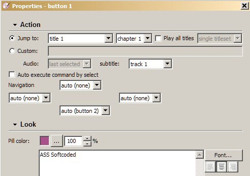

I have an MKV video with soft subtitles - I can turn them on and off in VLC player. There are no separate subtitle or audio files.
I want to create a DVD using DVD Styler. I dragged the MKV into it and created two menu sets, a VMGM and a Titleset.
I added a Setup button to VMGM Menu 1, which jumps to Titleset 1 Menu 4.
Menu 4 has a Subtitles button to turn subtitles on, and a Subtitles Off button to turn them off.
It will also have a pair of audio buttons.
How do I code Menu 4 and its buttons? I searched and tried to decipher the documentation, to no avail.
For the Subtitles button Properties, I chose Custom, entered "subtitle=0;", and in the subtitle dropdown chose track 1. Is this correct?

I searched that pdf for all occurrences of subtitle and read p 14 and all other pages. I don't understand it. To me, p 14 says the register can be invoked as "subtitle", and that a value can be set with "=value;", that there are 0-31 possible values. Didn't I follow that? Maybe you can take a moment to explain what's wrong.
The ASS Softcoded button in the example you gave, isn't using the approach on page 14, and isn't coding a separate audio/subtitle menu. It's playing title 1 with subtitles. I don't want to play title 1 with or without, then have to restart the entire video to turn subtitles on or off. I want to start playing, then turn subtitles on or off. Can't I do that?

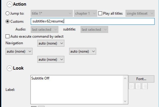

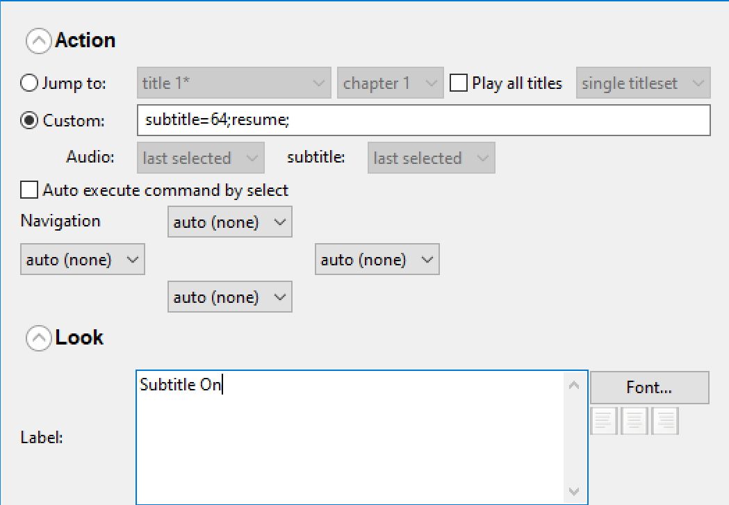

You need to add 64 to the stream number.that there are 0-31 possible values

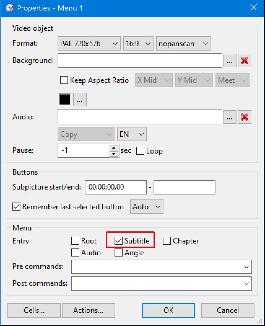

You could make a menu with Entry Subtitle. This is invoked if you press button "Subtitle" on a remote control.Can't I do that?
[Attachment 62589 - Click to enlarge]
The menu could have a button to turn subtitles on.
[Attachment 62590 - Click to enlarge]
And a button to turn them off.
