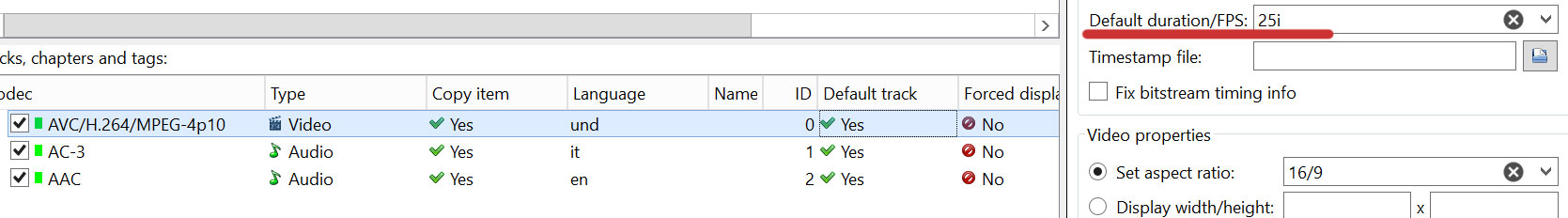

It's simple: import ts to mkvtoolnix-gui, then click on video, and in the "Default duration/FPS" type 25i, like in th screenshot. MKV file is always smaller than TS, so don't worry that something is missing - just no needed data.
[Attachment 62578 - Click to enlarge] -
