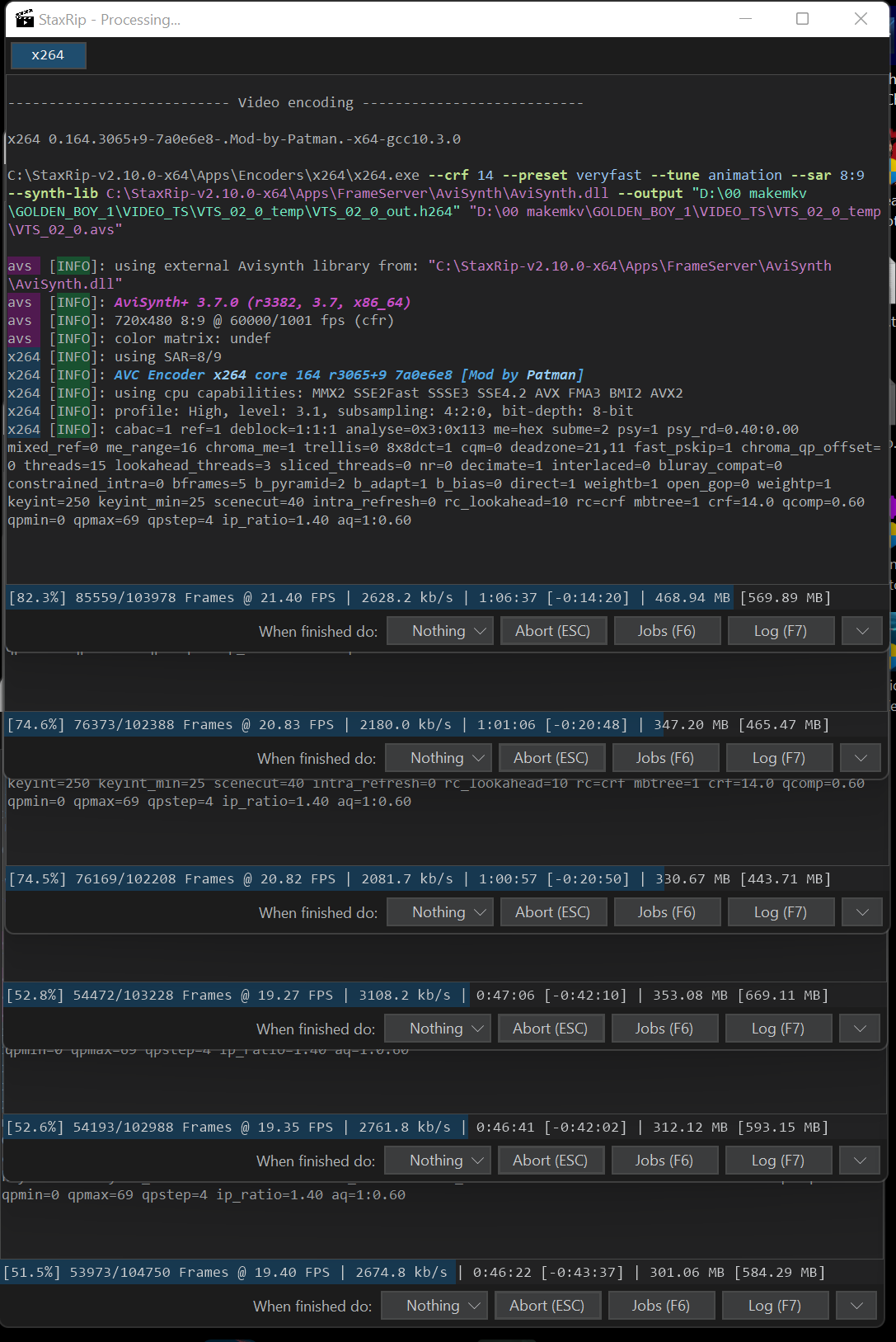

  7. Thanks for the help again. Staxrip can do the whole process too I have figured out. You just select open, merge files and select all of the VOBs for each episode. I've got the system working overtime now.
    Oh, and next step is AI upscale using topaz video AI with a final x265 and opus encode. Looking forward to final results.
    [Attachment 62583 - Click to enlarge]
