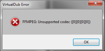

  1. I have some plugins like "FFMpeg Suported Files", "FFMpeg (All formats)", "DirectShow Input Driver" to open different codecs onto Virtualdub.
    But videos from Youtube encoded with AV1 codec commonly to freeze Vdub.
    Does anybody know a way to open such videos without problems?
    Thank you.
  2. Thank you, Nilzzon, but how to open files?
    I installed xAV1vfw and tried to open file using:
    Default file types
    and dragging the file directly to Vdub.
    No success.
    Thank you.

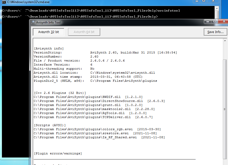

  12. I also tried to install Avisynth 3.7.0 (Avisnth+) and AvsPmod didn't open (said there is no Avisynth installed).
    What a pain to open an AV1 script...
    Thank you.

  16. Thank you guys, but I give up...
    Installed many versions of Avisynth, LSMASH, ffmpegsource,...
    Registry and system folders became full of inconsistencies and...
    [Attachment 62601 - Click to enlarge]
    Maybe tomorrow, I'll try again.
    (Perhaps I'm becoming dumb, even after becoming old, after years...)
    Thank you.

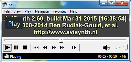

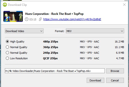

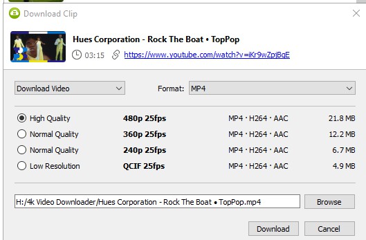

    May 2005
    Australia-PAL Land
    Odd. I used 4k Video Downloader and it gives VP9 and H264 options for the download. The "Stats for nerds" shows AV1.

  26. In the middle of this codec nightmare, I think I got a little light ahead.
    Alwyn talked about 4kvideodownloader.
    It uses VP9 and this codec I can open via AvsPMod and Virtualdub.
    If nothing else works, I'll download video with VP9 codec instead of AV1.
    But the question will remain: what did I do wrong?

  27. Member
    Mar 2008
    create a simple one line script with this line, and when you drop it onto Vdub2 or mpc-hc, you'll get a box that gives
    you some basic Avisynth build info. If this works it confirms the installation is OK
    version()

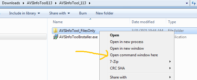

    Secondly, download the Avisynth info tool and extract it to a folder. In windows Explorer you navigate to it,
    hold down the shift key/right click with the mouse and select "open command window"
    https://www.videohelp.com/download/AVSInfoTool113.7z
    Then when the CMD window opens type in
    avsinfotool
    and it will open a box and tell you about your installation, including good/bad plugins and other errors

    I've already checked version of it.
    I got the same picture of your sample.
    Here the diagnostics:
    [OS/Hardware info]
    Operating system:           Windows 7 (x64) Service Pack 1.0 (Build 7601)
    CPU:                        Intel(R) Core(TM) i7-4790 CPU @ 3.60GHz / Haswell (Core i7)
                                MMX, SSE, SSE2, SSE3, SSSE3, SSE4.1, SSE4.2, FMA3, AVX, AVX2
                                4 physical cores / 8 logical cores
    [Avisynth info]
    VersionString:              AviSynth 2.60, build:Mar 31 2015 [16:38:54]
    VersionNumber:              2.60
    File / Product version:     2.6.0.6 / 2.6.0.6
    Interface Version:          6
    Multi-threading support:    No
    Avisynth.dll location:      C:\Windows\SysWOW64\avisynth.dll
    Avisynth.dll time stamp:    2015-03-31, 06:40:58 (UTC)
    PluginDir2_5 (HKLM, x86):   C:\Program Files (x86)\AviSynth\plugins
    [C++ 2.6 Plugins (32 Bit)]
    C:\Program Files (x86)\AviSynth\plugins\DirectShowSource.dll  [2.6.0.3]
    C:\Program Files (x86)\AviSynth\plugins\ffms2.dll  [2.40.1285.13]
    C:\Program Files (x86)\AviSynth\plugins\LSMASHSource.dll  [2021-08-10]
    C:\Program Files (x86)\AviSynth\plugins\TCPDeliver.dll  [2.6.0.7]
    [Scripts (AVSI)]
    C:\Program Files (x86)\AviSynth\plugins\colors_rgb.avsi  [2015-03-30]
    [Uncategorized DLLs (32 Bit)]
    C:\Program Files (x86)\AviSynth\plugins\avcodec-57.dll  [57.81.100.0]
    C:\Program Files (x86)\AviSynth\plugins\avformat-57.dll  [57.66.102.0]
    C:\Program Files (x86)\AviSynth\plugins\avresample-3.dll  [3.2.0.0]
    C:\Program Files (x86)\AviSynth\plugins\avutil-55.dll  [55.47.100.0]
    C:\Program Files (x86)\AviSynth\plugins\swscale-4.dll  [4.3.101.0]
    [Uncategorized files]
    C:\Program Files (x86)\AviSynth\plugins\ffms2.lib  [2020-08-22]
    C:\Program Files (x86)\AviSynth\plugins\ffmsindex.exe  [2.40.1285.13]
    [Plugin errors/warnings]
    _________________________________________________________________________________________________
    Function duplicates:
    "DirectShowSource" : "[InternalFunction]"
    "DirectShowSource" : "[PluginFunction]"
    "TCPServer" : "[InternalFunction]"
    "TCPServer" : "[PluginFunction]"
    "TCPSource" : "[InternalFunction]"
    "TCPSource" : "[PluginFunction]"
    LoadPlugin: unable to load "C:\Program Files (x86)\AviSynth\plugins\ffms2.dll", error=0xc1
    Dependencies that could not be loaded:
      MSVCP140.dll
      VCRUNTIME140.dll
    Note: Visual Studio 2015/2017/2019 Runtime doesn't seem to be installed
    LoadPlugin: unable to load "C:\Program Files (x86)\AviSynth\plugins\LSMASHSource.dll", error=0xc1
      VCRUNTIME140.dll
    It seems, I missed Visual Studio 2015...
    Probably it is. I had to restore my whole system.
    I'm busy now, but I'll check all of this later.
    Thank you.
