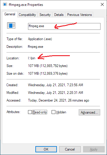

    Mar 2008
    create a new text file on the desktop and call it ffmpeg.txt.
    Open it and copy in jagabo's lines (see below)
    Download ffmpeg if you don't have it already and extract the files and put the folder on the desktop or downloads.
    https://www.videohelp.com/software/ffmpeg
    Edit the txt file to add the path where your ffmpeg.exe is located and add pause at the bottom
    "i:\bin\ffmpeg.exe" -y -benchmark -init_hw_device qsv=hw -filter_hw_device hw -v verbose ^
        -i %1 ^
        -vf "scale=720:-4:flags=spline,hqdn3d=1.0:1.0:1.0:1.0" ^
        -c:v libx264 -preset veryfast -crf 23 -g 50 ^
        -profile:v high -level:v 4.2 -g 50 -colorspace bt709 -color_range tv ^
        -acodec copy ^
        "%~dpn1.avc.mkv"
    pause
    Save the changes and rename the txt file to ffmpeg.bat (right click the file/properties and change the name in the box at the top)
    Drag your video file onto the bat file's icon and it will reencode and store the new file in the same folder as the old.
    It will open a CMD box and the progress can be seen. Any errors will also appear there.

  18. You didn't even mention what software you've tried. As already implied by El Heggunte (who wasn't trolling), you should do that first thing, rather than just saying, "No matter what I do...".
    If you don't understand command line tools and can't be bothered to investigate and learn, then try VidCoder.

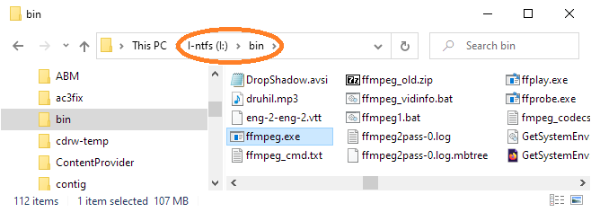

    Mar 2008
        -i %1 ^
        -acodec copy ^
        "%~dpn1.avc.mkv"
    pause
    I want it to be an mp4 file. Also, WHERE do I put the file path ?
    Just tried...I think. And it doesn't work. I dragged the video onto the icon and nothing happened except that it moved the file to the folder. Oh, well.
    Another also...I changed the name of the file, but it was still a .txt file. It became ffmpeg.bat.txt
    No it should be called ffmpeg.bat without the .txt extension
    Make sure extensions are visible. In any Windows Explorer window, select view (at the top), options (right)/change folder and search options
    View tab/deselect "hide extensions for known file types"
    Here's a portion of my desktop with the bat file, right click, Edit and it opens in Notepad
    On the otherhand, manono's choice of Vidcoder is a good choice if you don't want to be bothered with setting all this
    up (it's easy to maintain/duplicate once you understand and get it working)

    The first line must point to the ffmpeg.exe you downloaded and extracted into a folder somewhere.
    Otherwise the command processor has nothing to execute when you drag a file to it.
    In my system, ffmpeg.exe lives in i:\bin, edit your bat file accordingly
    I agree, it's a bit complicated to set up for non-tech users.
    But once you get it working, it's a very useful tool to have
