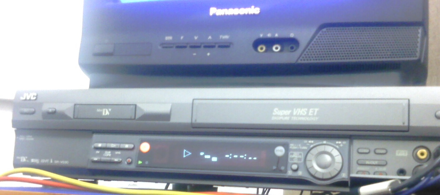

    On the subject VHS VCRs, but I'd love to get my hands on one of these machines:
    [Attachment 62758 - Click to enlarge]
    This was taken whilst I was doing a media course at my local college back in 2010 in one of our editing suites we had, and even just 10 plus years ago we were still using VCRs and tape camcorders and capturing footage in real time using the college's DV camcorders (and sometimes with HD pro cameras), and everything was captured via tape in real time using Avid, Avid I was never fussed on as I much preferred Adobe Premiere, plus we had to editing everything using only the keyboard and not a mouse lol. No idea what model of JVC Super VHS recorder that is, and I can't find anything like it on ebay, but I'm guessing this model will be very expensive. I'm sure that would sort the issues I have. Anyone know the model? never seen a Mini DV/S-Video combi like that.
  14. Member DB83's Avatar
    Join Date: Jul 2007
    Location: United Kingdom
    Why would that DV/SVHS combi help you ?
    Correct me if I am wrong but you do not have and DV tapes.
    But this whole topic has lost me now. One moment you can capture. The next you can not. Changing versions/variants of vdub is not going to help you in the long term. You need to go back to basics. Determine what worked for you - even with issues which have been addressed - and confirm that that arrangement still works. If it does not then your current hardware (vcr) is not up to the task or, at the very least, obtain a more current capture device which will work on later OS. Hardware issues must be eliminated 1 by 1. Only then can one look at software.

    I was talking about the S-video side of it not the DV deck. Someone said that using an older driver on the disc worked, so I will give that a go. Must be an issue with the hardware as the only programme that seems to work (for now) is Corel Video. VLC player won't capture, Adobe Premiere doesn't, Vdub, AmarecTV and so on. I think I'm probably better off getting a desktop PC with a proper video capture card installed.
  16. Originally Posted by techmot View Post
    It looks like a JVC SR-VS30. I think there is a non "professinal" variant called HR-DVS3 as well. JVC made a few variants of these SVHS/MiniDV combo decks with all the bells and whistles. Sony made some too but those were only released in Japan as far as I know.
  17. Member DB83's Avatar
    Join Date: Jul 2007
    But, again, why should that deck suit you ?
    You confuse DV with DVD, Just because that deck is SVHS simply means it records and playback SVHS tapes. No pass-through capability. That is confined to certain models of Panasonic DVD-recorders. That combi I hardly think would have done anything significant.
